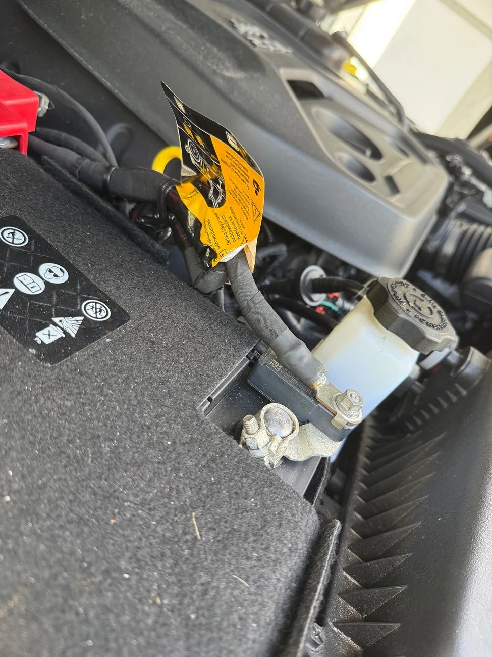

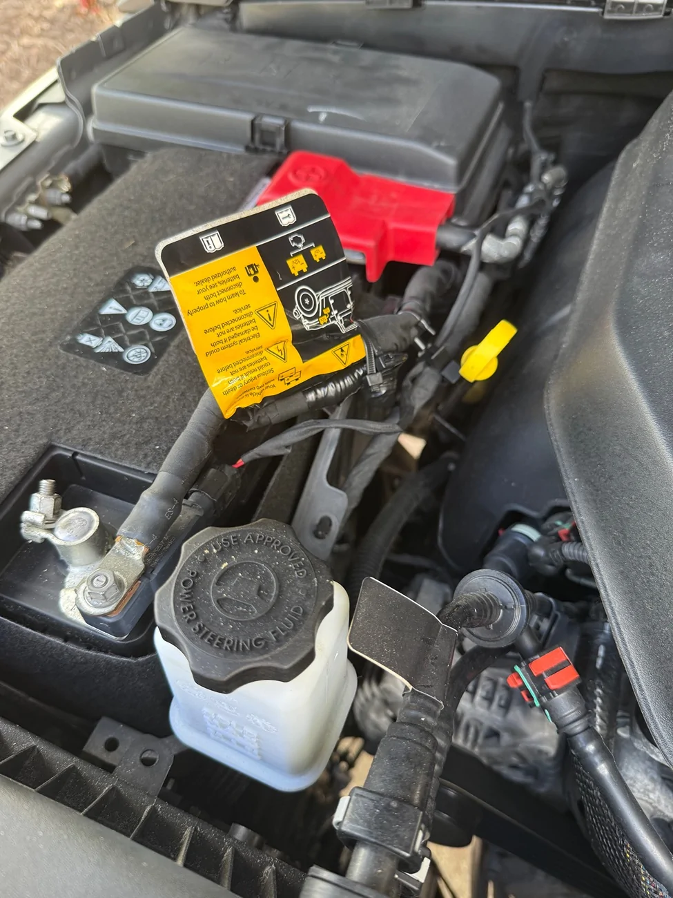

I was getting the "Aux Switches not available" and "Start Stop Unavailable" and I think it also said "service ESS system" so I had a new Group 94/H7 battery put in this weekend.
I did the Aux Battery Bypass this weekend. Removed the smaller of the two cables from the negative terminal, taped it up and zip tied it back, and removed fuse 42. I also put the battery on my charger to ensure it is 100 fully charged.
Started it up yesterday after doing the above - the Aux Switches unavailable message went away, but it still says "Start Stop Unavailable."
Anyone have any ideas what's going on.
Picture attached
Jeep Wrangler JL Jumperless Aux Battery Bypass IMG_2625
Jeep Wrangler JL Jumperless Aux Battery Bypass IMG_2624
andy29847
Andy
Oct 22, 2022
441
714
Trenton, SC
2020 JLUR
Picture attached
I'd use the Jeep as you would normally for a couple of days to see if the message turns off. If you still have the message, I would reset the IBS (unplug it for 15 seconds).
Push the ESS button as if you are disabling it. The light should stay on forever now, Unless you push the button again..The light will stay on every time you start it, dont have to push, just the first time.

Wut. No. Unless you have a SmartStopaStart, Tazer, or similar device you have to push that button in every cold start. SSS is the way to go, in my opinion.
As for the idiot light, that should not be on if bypass was done correctly. Try unplugging battery for 15 mins and then put back to see if it clears. Before that, make sure it’s fully charged.
Well ok. Wife reported back that the ESS started working again today.
All good. Now since her commute is less than 5 min. We probably need to remember to drive it at least 30 minutes on a few weekends a month or hook it up to the charger.
