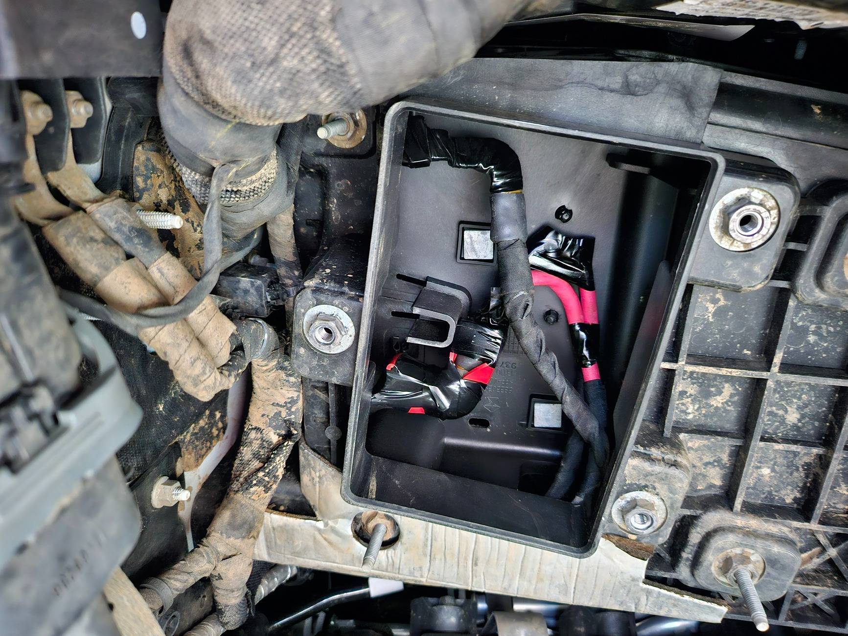

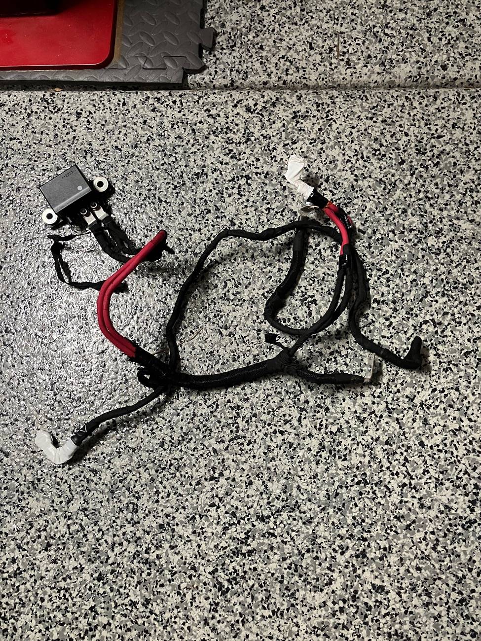

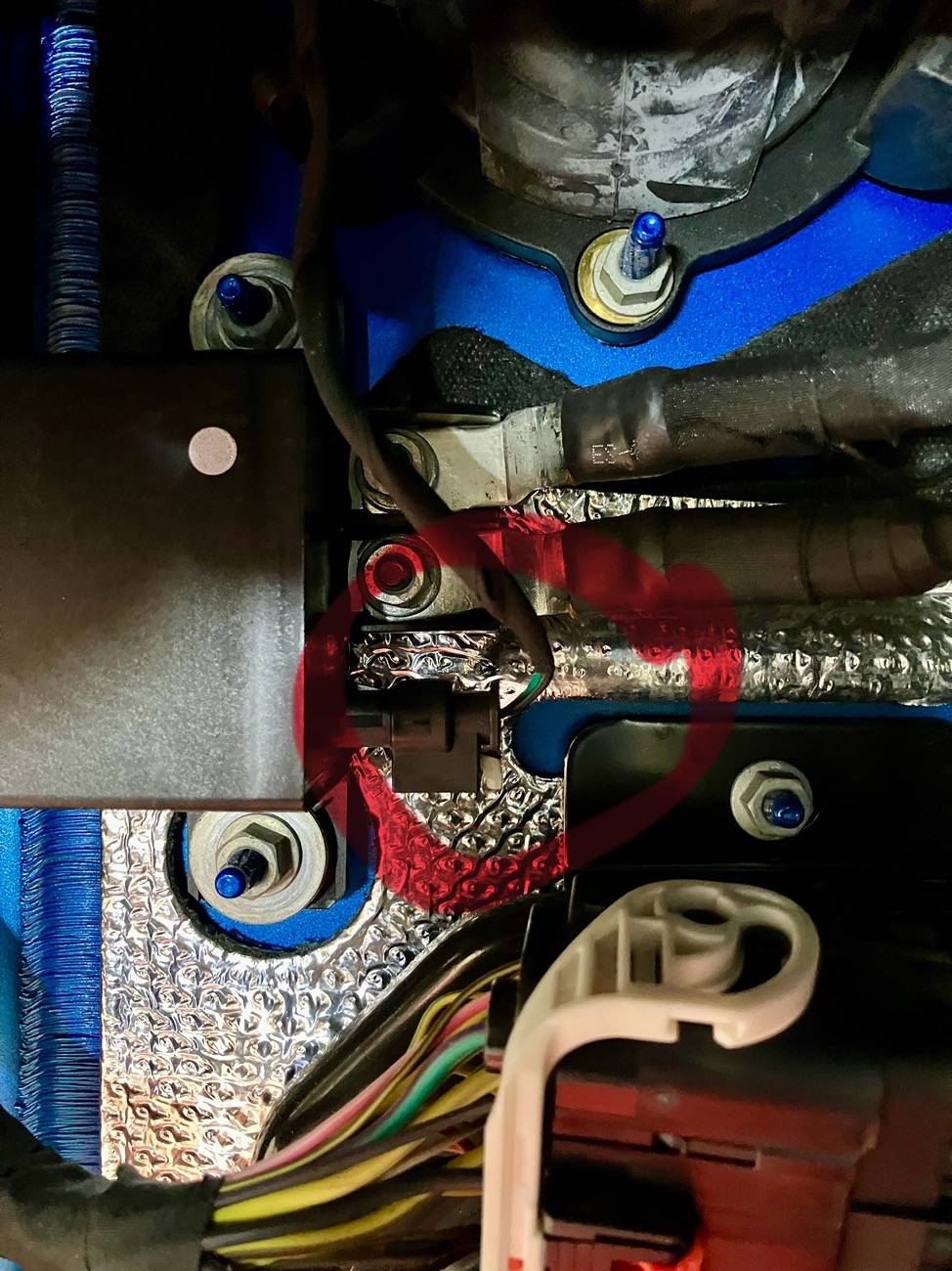

so I undertook the extraction of the aux battery and wiring after lunch today. I got everything sorted, but in order to do so, I had to remove the fuse box. I just couldn’t see everything well enough with it in the way. Having done it once, I could probably do it again without removing the box. Hopefully, I didn’t f up the Jeep. I hope you (Thaw) can answer one question. there was a sensor plugged into the PCM on the fire wall. I think with fuse 42 removed it becomes just a wire. I plan on just taping it off. Any advice would be greatly appreciated.

Not a sensor, that is the PCM connector. Has no power with fuse 42 removed, just tape it up.
Already been answered sufficiently, but I'll add...
The PCR is a relay so it has a contact side and a coil side.
The large gauge wires you removed connect to the contact side to carry high current. The plug in question is for the low-current, coil side (essentially, the switch to open the relay).
So, yes secure/cover the plug, and it's best to pull fuse F42 to break the circuit so the plug never has power.
