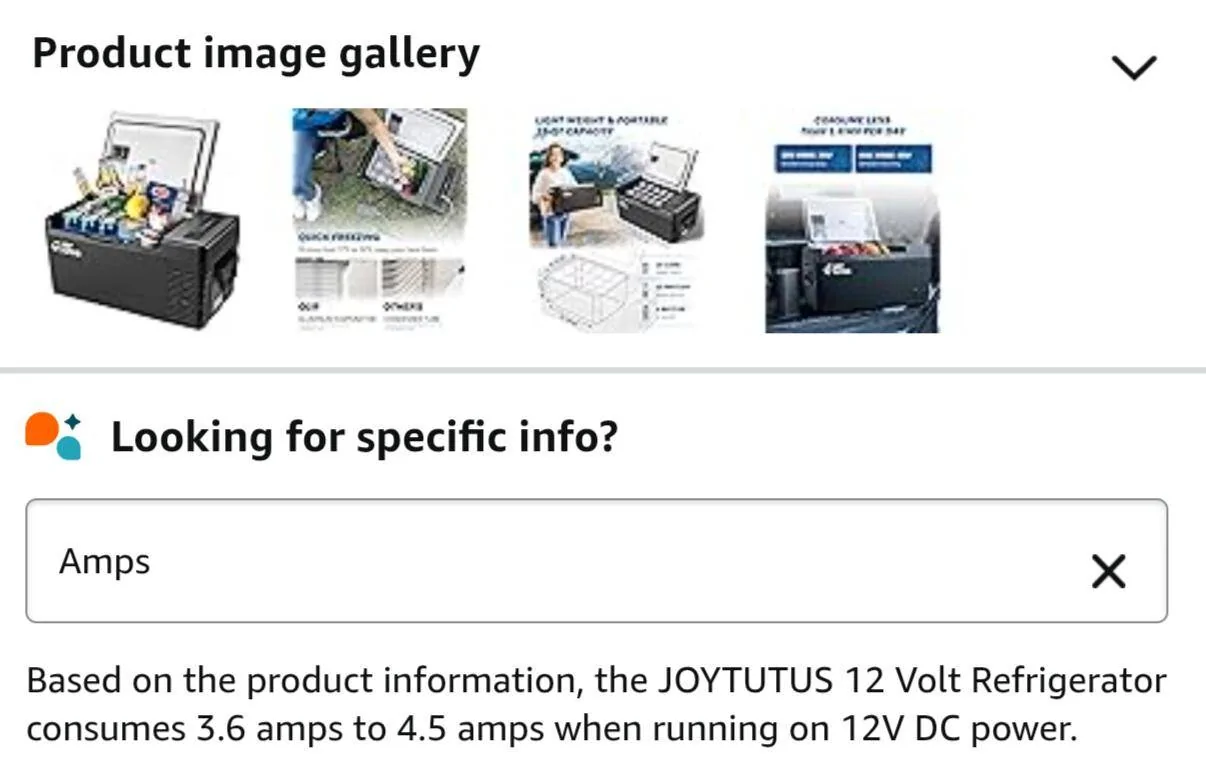

You're not going to power the Sun with this thing, but if you want to attach a refrigerator and a couple of LED lights to it, you'll have zero issues with that. If you need to jump your main battery with it, it's as simple as replacing your main battery with your backup battery. 5 minutes worth of work, and you get to save more than $600. 🤷‍♂️

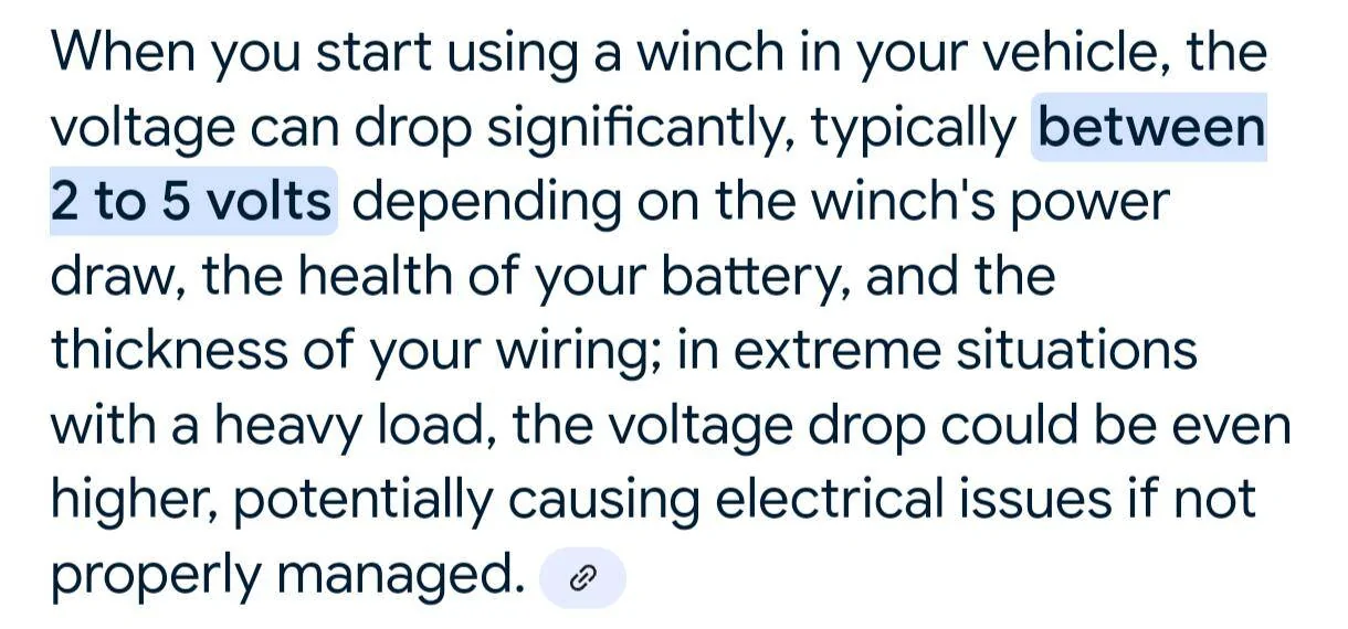

@Jammer
Prime example, the Vevor dual battery system can transfer over a max current of 140 amps, but the 12 volt refrigerator I want to get for my Jeep at some point only uses 3-5 amps...
Jeep Wrangler JL Jumperless Aux Battery Bypass 1000008310
... So why the hell would I spend $800 on a system when I don't even need that much power draw, you know?

@Jammer
It won't be in the loop when running your winch?
EDIT: I take that back, after looking at the specifications on the website, with the kind of power draw that a winch will need, The Vevor isolator will cut in and separate the two batteries.
Jeep Wrangler JL Jumperless Aux Battery Bypass 1000008313
If it's worth anything, I wouldn't pull a F-350 up a ravine anyways, even though my winch is rated for 13000 lb, I'm not trying to max that thing out. However I would be a good friend and help you call a off-road tow truck! :LOL: ;)
It separates them at specific voltage ranges, not amps.

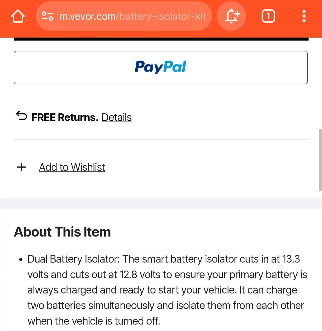

Apples to oranges, man.
What do you think happens to your voltage when you start using 200 amps? :idea:
Edit: I'll save you from having to answer that. ;) :handsinair:
Jeep Wrangler JL Jumperless Aux Battery Bypass 1000008315
EDIT-EDIT: Amps are not a direct measurement into volts. That being said, you need to ask yourself a system like the Genesis system, how are they measuring the amount of amps being used so that their isolator will cut in and separate the batteries?
I'll save you the trouble yet again: THEY MEASURE THE VOLTS!!!
Like I said, Genesis is selling people old technology that's been around for years for hundreds of dollars more because it comes in a pretty box, and people who don't know any better will fork their money over!
