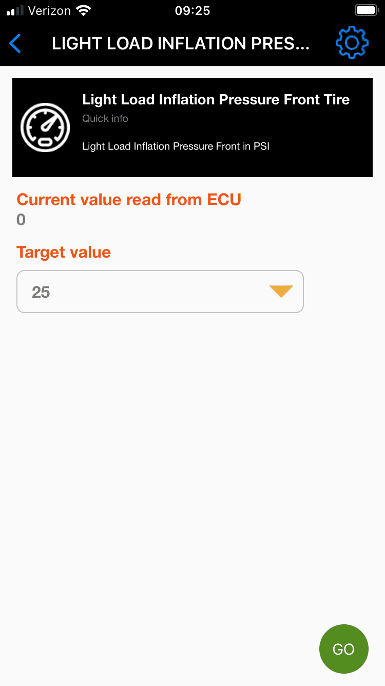

Here is where I’m doing it.

Fixed the issue. Had to set “max load” to 25. All good now.

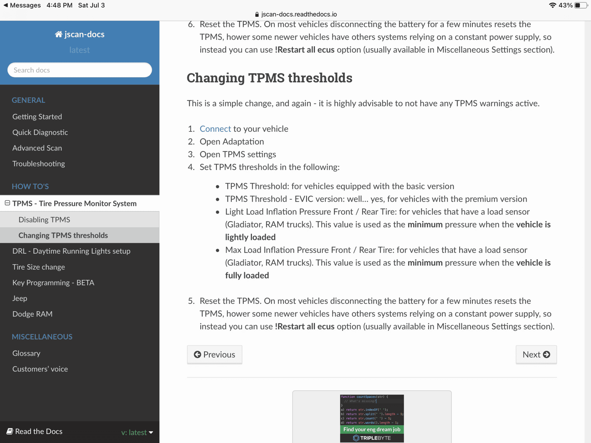

I did just send them a msg and see what I get but here’s somewhat some info from there doc file, not overly descriptive as in they don’t say that you are supposed to set max and not worry about min if you don’t own these vehicles mentioned.
