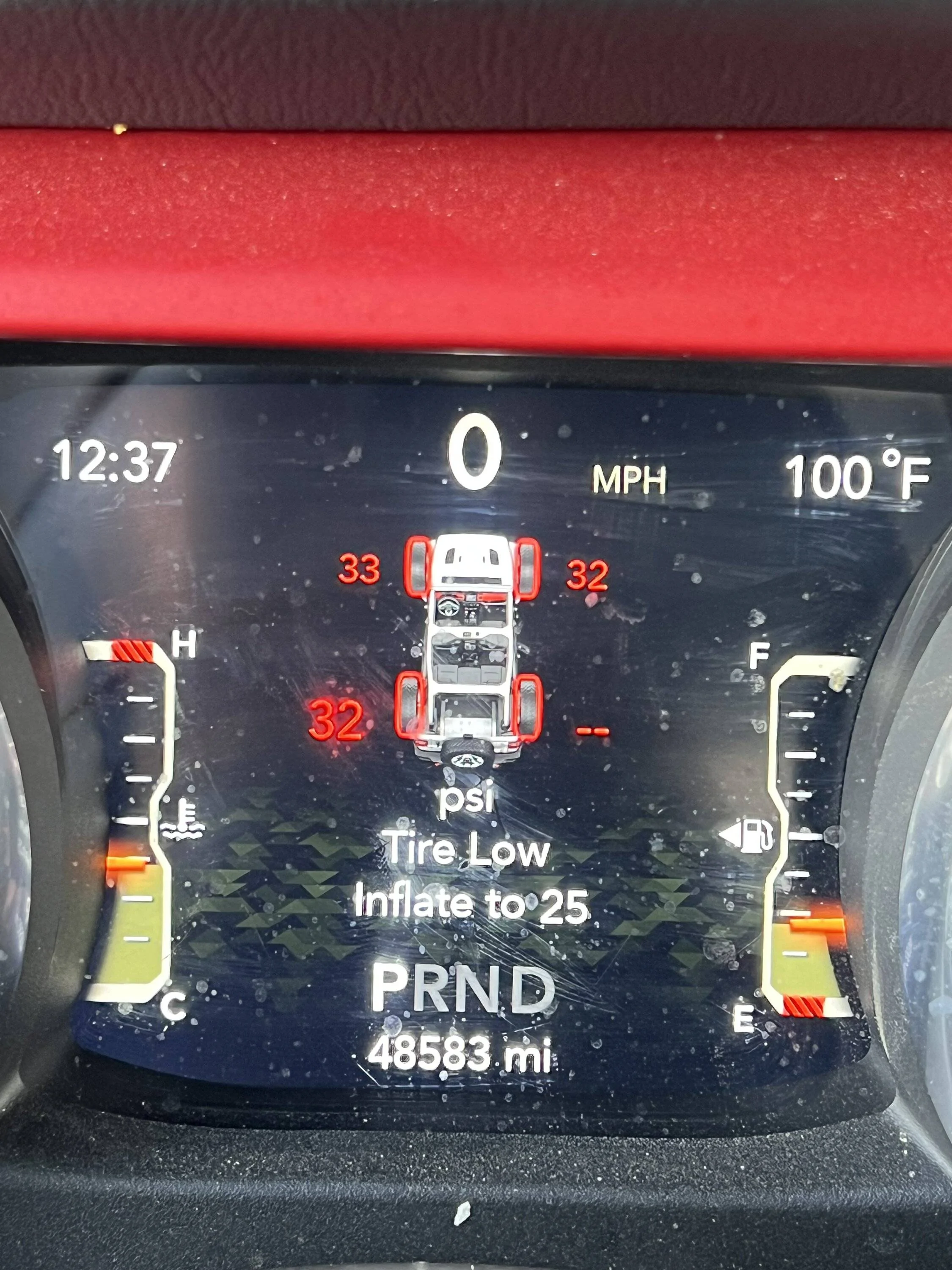

Ok…well maybe I need to disconnect the battery or wait to see if it does the same when I leave work today.
This is what I got after adjusting min to 0 and Max to 25psi:

Ok it works now but new/old issue..
@Rhinebeck01
In the pic above the rear right tire monitor shows not reading…I just rotated the tires when I put the lift on and that same right rear was not reading even before then. So is possibly a part of the the other side of the TPMS at that tire that could cause this problem? What would need to be fixed/replaced if this is the case?

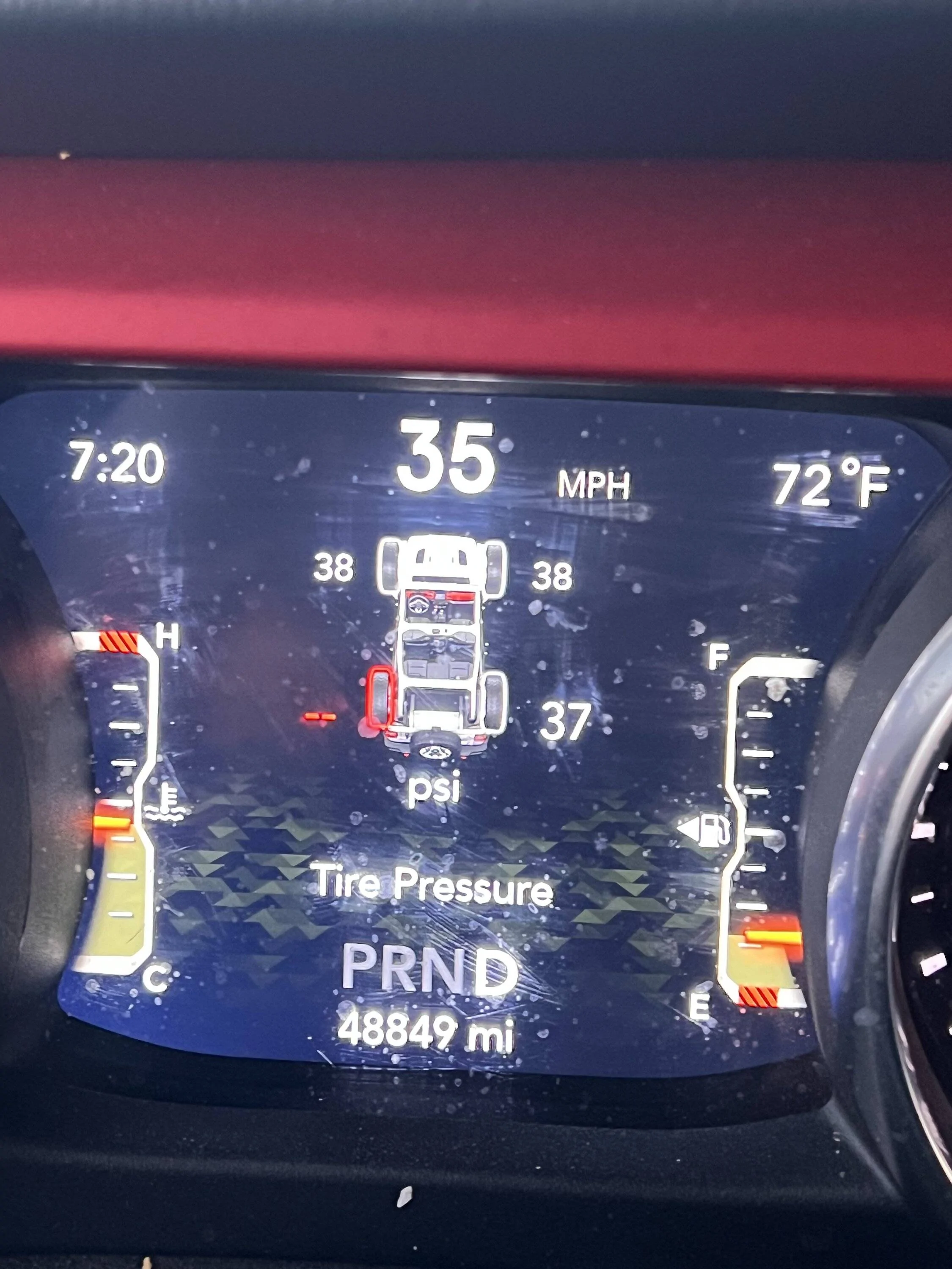

@Rhinebeck01
worked … somewhat…switched to the other side:

@Rhinebeck01
@mrtm1970
@Goin2drt
Strange.... Try this ..... With spare off the JL, set all tires to placard psi and then do a 12 volt power kill. Wait say 10 min. and then restore 12v and go for another drive..
