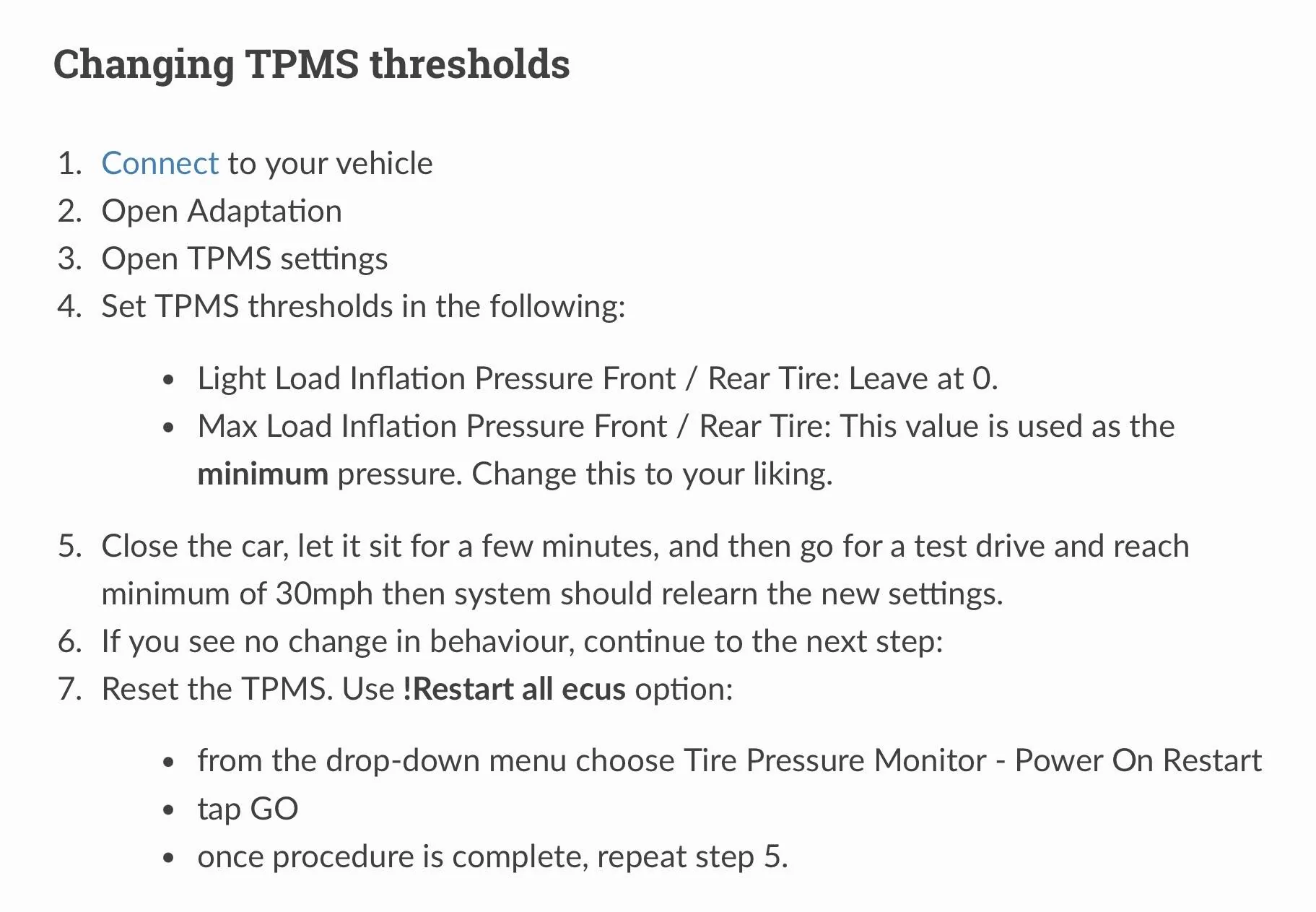

I was using the Tazer to set the lower TPMS threshold but to get the Jeep through a NY state inspection, I had to unmarry the tazer, reconnect the SGW and drive about 150 miles to get the monitors to reset so the computer could read the monitors. So I JScan so I could set the tire size and TPMS and just use the Tazer for the boost gauge and the auto start shutoff. They are features that do not require the Tazer to be married to function. Just so I am sure, the light load setting on JScan is the minimum psi below which the tire light will come on. Do I have that correct?

I use the Tazer now but had this screenshot saved from JSCANs user guide for JL

That’s what thought. Thanks.
