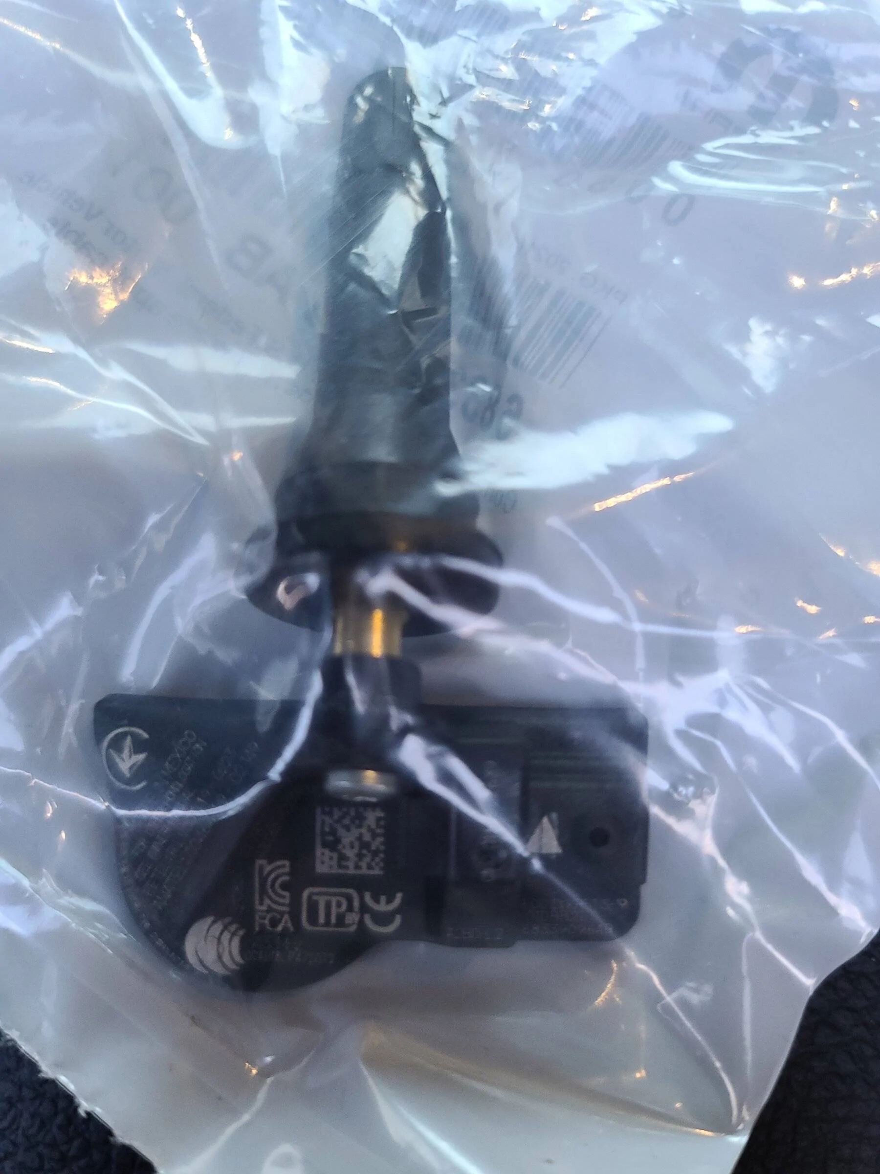

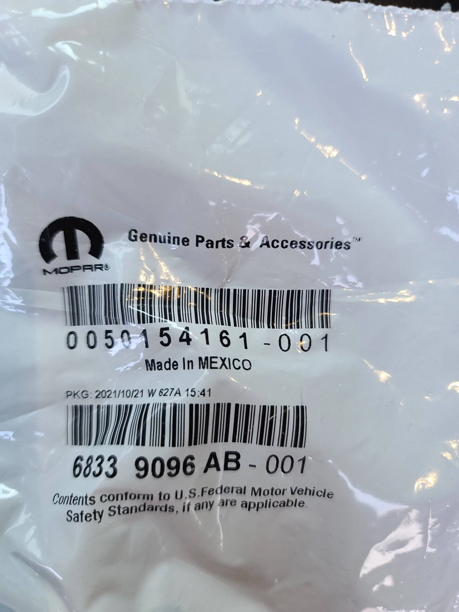

I have a 2021 Jeep Wrangler built after June 2021 I put new wheels tires and tpms sensors (schrader ez sensors 433mhz) I was getting no psi readings I reset the TPMS Fault light and after 20min. the light would come back on with no readings. Sooo I got the sensor ID#'s and manually entered them with JSCAN when I try to manually input the TPMS Sensor ID for Sensor #1 or #2 it changes both to the same ID# for instance if I change sensor ID#1 to (11111111) and then go to sensor ID#2 and put (22222222) it also changes Sensor ID#1 to (22222222) and when I change sensor ID#1 back to (11111111) it changes sensor #2 To (11111111) FYI the 3 sensors with the proper ID# do show correct PSI and then after 20 min I get the tpms fault light with no psi reading for tpms#2 and then all the readings go out. Hope this makes sense and someone has had the issue and solved it. Thanks in advance Adam.
