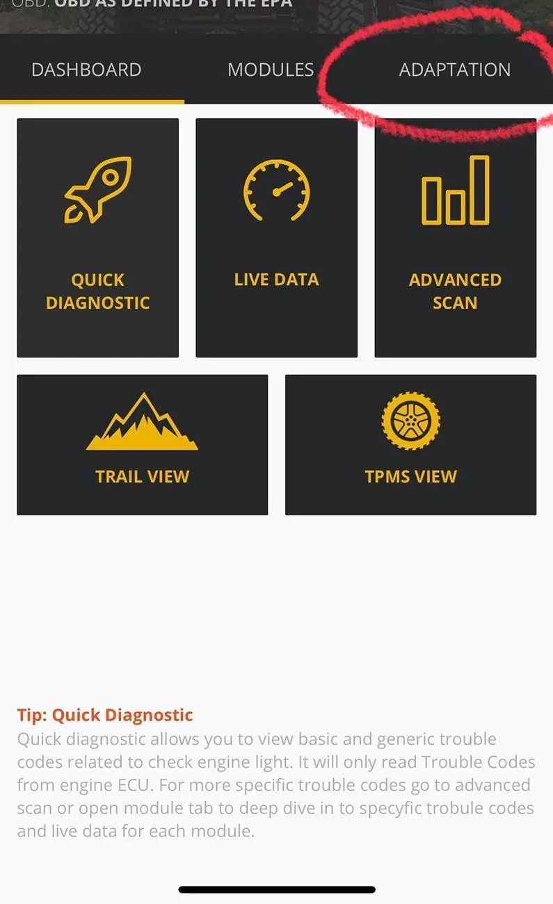

I know JSCAN can enable the factory AUX switches. I am getting ready to install the Mopar kit this week, and it has been a while since I used JSCAN. Does anyone know the proceedure? I would prefer to ask first rather than go in and fumble around with settings. I checked JSCAN’s site and it doesn’t appear they have a procedure written out for this either. Thanks in advance for any guidance!

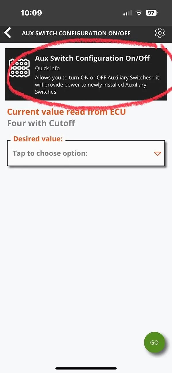

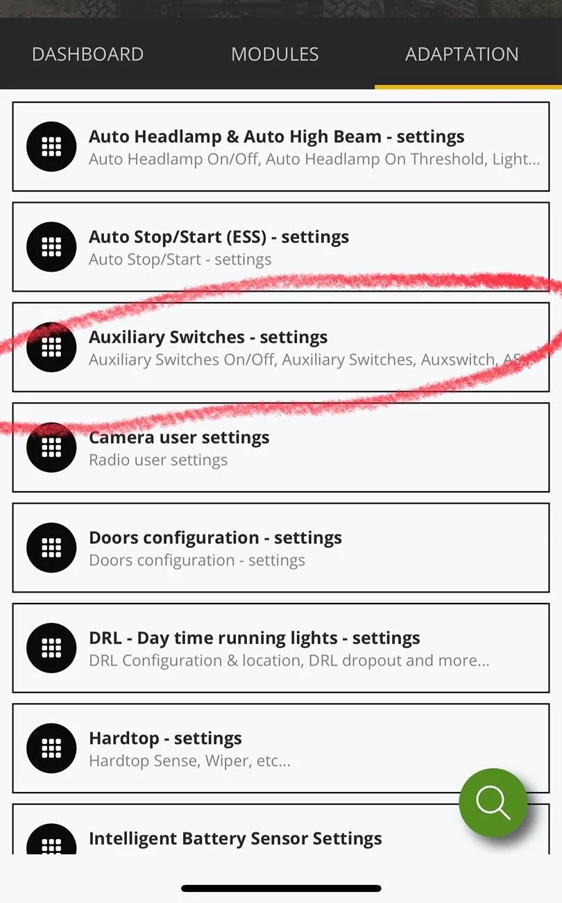

I have factory aux switches but use JSCAN. A quick look at the app shows this.
Jeep Wrangler JL JSCAN Aux Switch Enablement IMG_0731
Jeep Wrangler JL JSCAN Aux Switch Enablement IMG_0732
Jeep Wrangler JL JSCAN Aux Switch Enablement IMG_0733

Awesome! I was hoping it was “obvious.” Thanks for sharing the screenshots - much appreciated.

On the Jscan there are four categories on the Aux switch settings.Dose anyone know what to set all those at.Thanx I just added the switches.

I Used the below J-Scan settings if anyone is interested.
Auxiliary Switch Bank Module Present On/Off = "Active"
Auxiliary Switches in CSM On/Off = "Switch 4 Option"
Auxiliary Switches On/Off = "Four"
Radio -> Auxiliary Switches On/Off = "Switch 4 option" This seemed to work.It was posted by eugeeezy.
