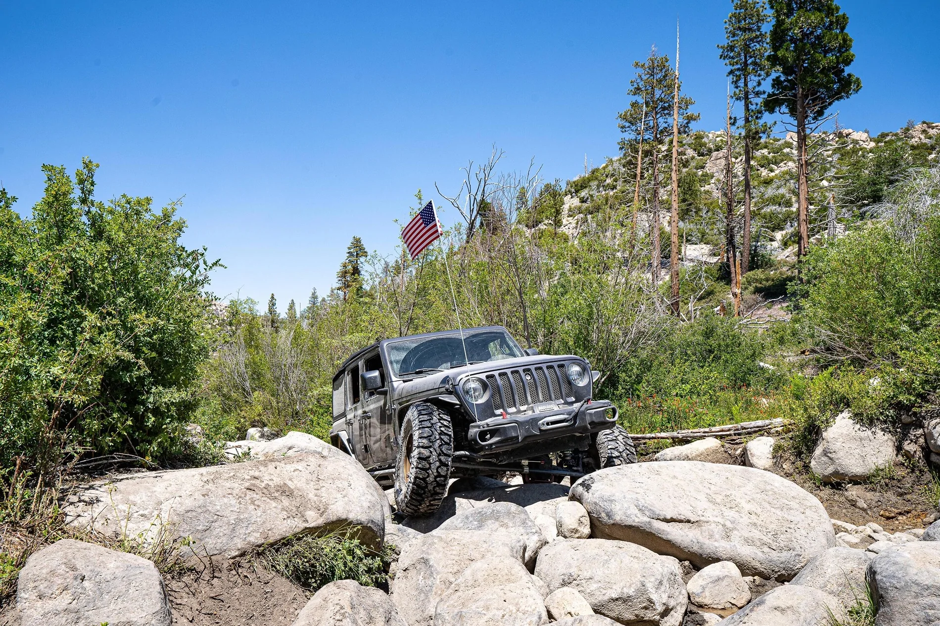

We bought our JL with a 3.5" lift and 37" tires already installed and since we got it I keep hearing 2 different stories...
1) JL Rubicon with a lift can fit 37" wheels and there should be no issues as long as you aren't going crazy climbing vertical walls or rock bouncing.
2) 37" tires without regearing or replacing axles is sure to break something.
Can any of you who perhaps have experience give me your advice?
A) Are 37" tires ok on factory JL Rubicon running gear?
B) If upgrades are necessary, what is the minimum that I have to do to not break something on mild trails?
PS this is the lift kit that was installed, if this is any help...
ReadyLIFT | 2018-2019 Jeep JL Wrangler 2-Arm Terrain Flex Lift Kit
I would suggest figuring out your gearing for your axles. The auto handles more then the manual transmission does but also comes with higher load and more temperature in the oil. I would recommend 4.88 gears for 37’s. I’ve been 37’s. For two years on rubicon axles with 4.88 Yukon gears. Jeep has done great with everything I’ve thrown at it. Including just completing the rubicon trail. If you stick to moderate to easy trails 37’s on rubicon axles should last you a very long time. Just keep up with maintenance and make sure you have the correct gearing for the tire size to help the transmission with the work load.
Jeep Wrangler JL JLUR - 37" tire risks IMG_8532
