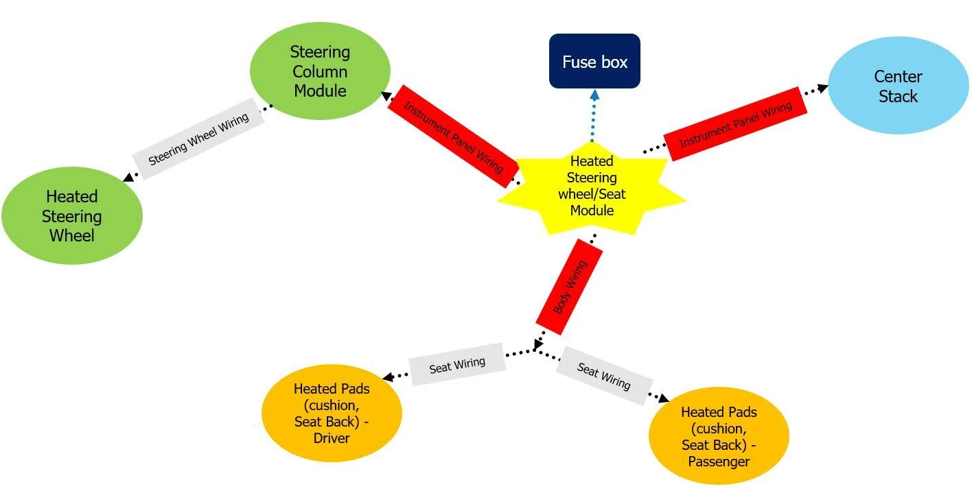

For those thinking about retrofitting the heated steering wheel and heated seats, 2 things to keep in mind:
1) it will cost you minimum $1100+
2) If you don't have 4 connectors underneath the steering column, don't even bother looking into this further. These 4 connectors come from body wiring and instrument panel wiring. They connect to the heated seat / heated steering wheel module (main module)
Below is the diagram.
Jeep Wrangler JL JLU HEATED SEATS MODULE?!?! Cold weather pkg
If you have the 4 connectors, at least you will be able to complete the hardware part. This will cost you ~$1100. Below are Gladiator parts but I would expect the Wrangler parts cost would be similar.

Ok I think I figured it out... I give up at this point... lol

This, plus couple of more connectors to can bus. But the main takeaway is correct, if you dont have correct body and instrument panel harness the project is 10 times harder that it should be.

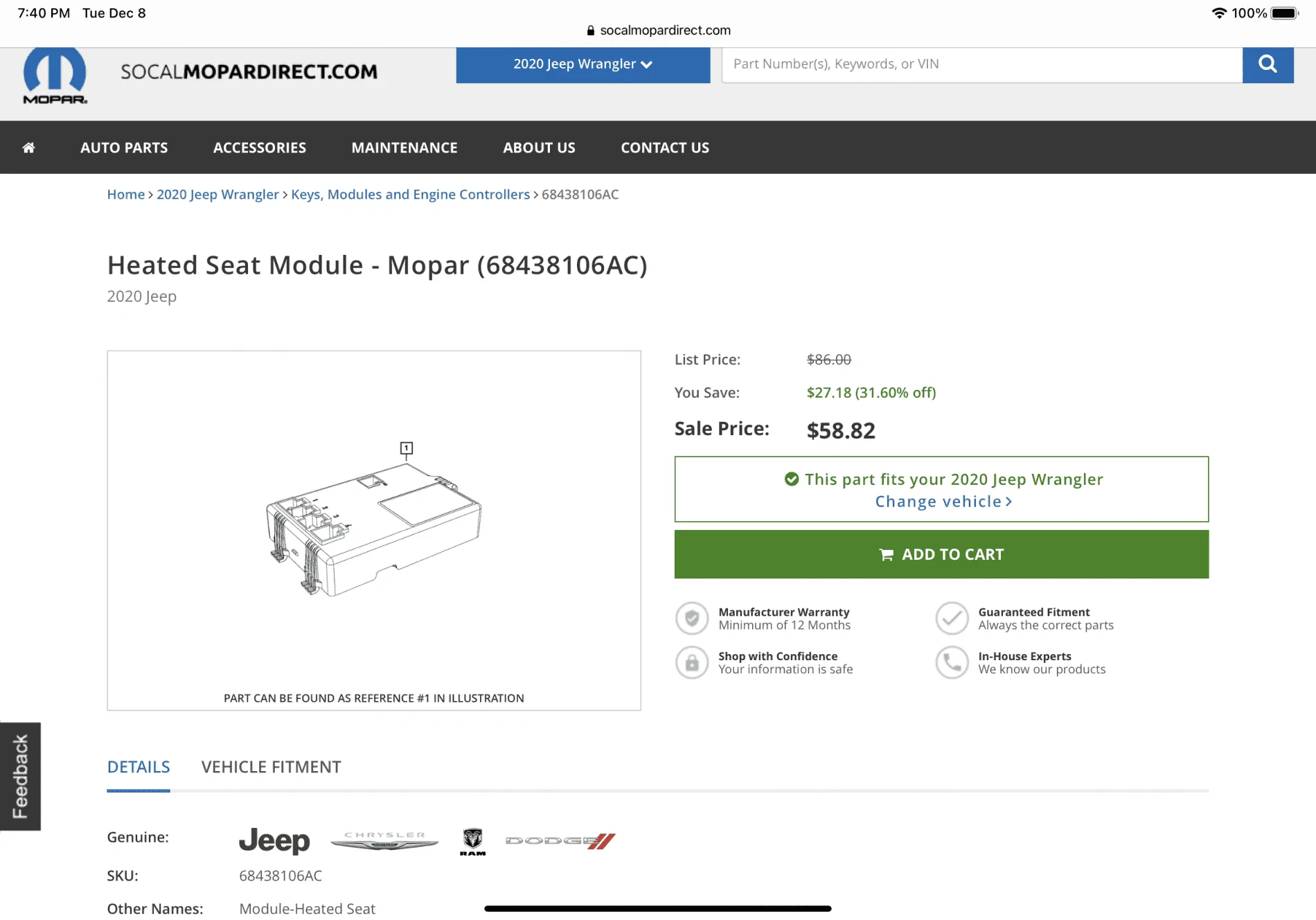

Where does the module fit in, is it under the dash or under the seat?
Under the dash.
