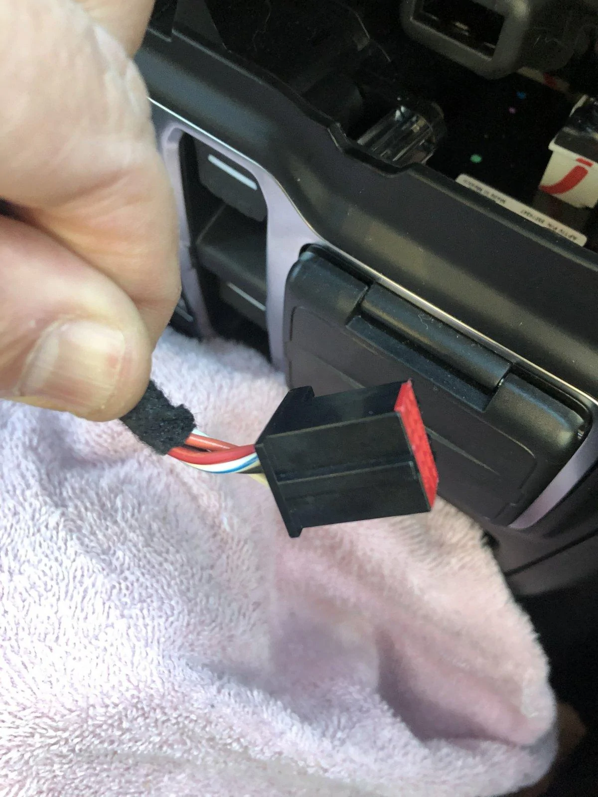

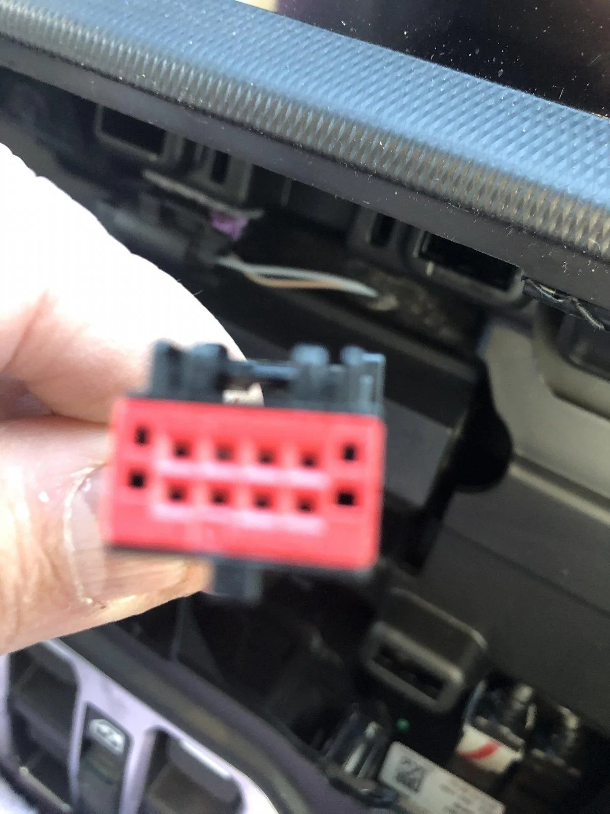

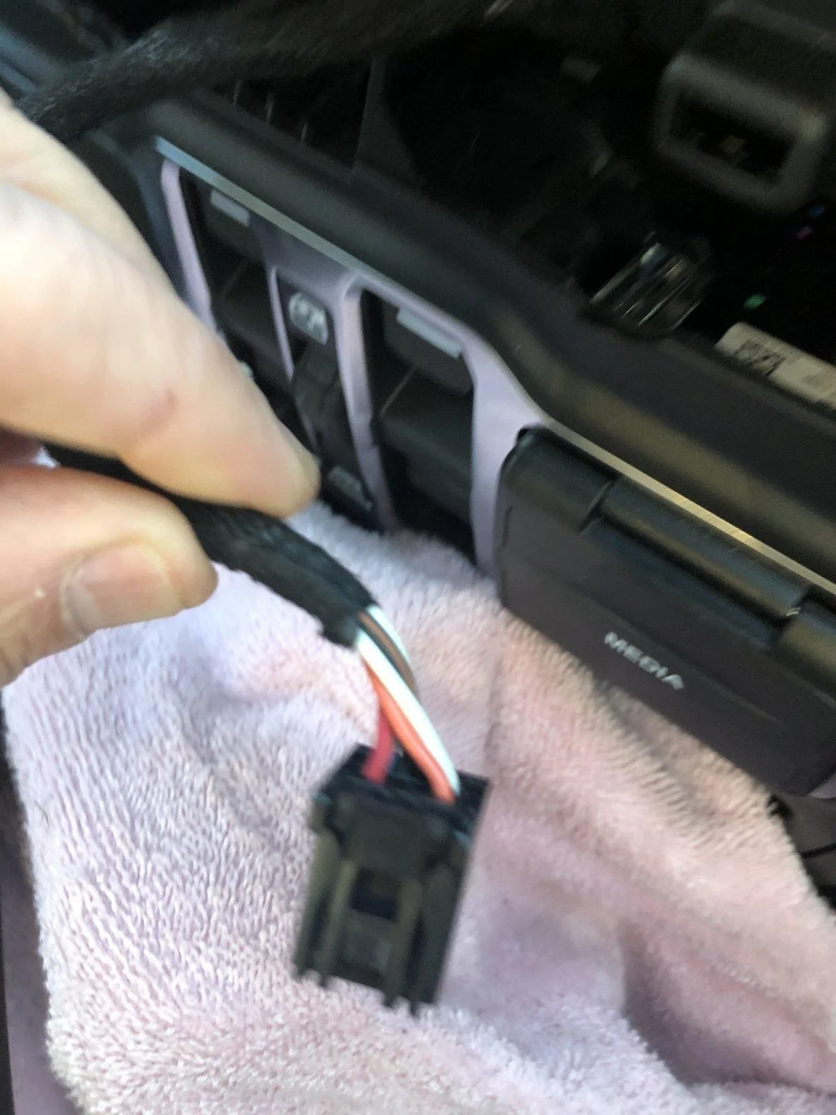

that is exactly what i'm talking about when I say you'll need new instrument panel harness, or you'll need to add a lot of connectors and wires to make it work.
Great, i have an appointment with the dealer tomorrow

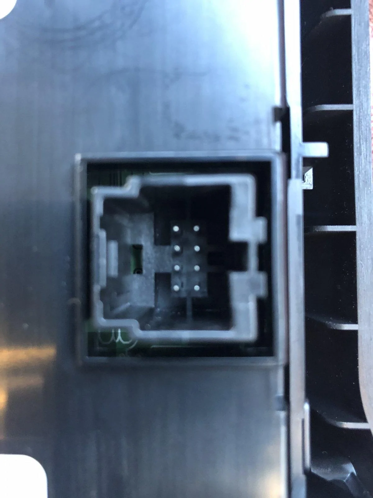

the connector for the center stack is the exact same across all the JLs, the no power to the buttons is because the cold weather package is not turned on. Same thing happed when I did my AUX switch upgrade the buttons did nothing until it was programed.
Edit 1 - sorry i responded to the wrong post haha! my bad!
Great, I have an appointment tomorrow morning with the dealer to add the cold weather. I have the expanded control panel installed and as i said previously all other buttons and knobs work. I will let all know how I make out in the morning

Yea you'll have to take the dash out to do it properly. I did it in other vehicles and Wrangler dash does not look too complicated. You can always just take the plugs, pins and wires from the new harness that you need for your upgrade.
Yes I have correct plugs and harness under the seat for some reason, I suspect it's because AUX switches and towing package, the only option I have. But it's a part of a body harness. My instrument panel harness 100% does not have correct plugs, you guys with your fancy highly optioned Wranglers :) might be more lucky.

I posted a link to wiring diagram in post 56 :) , Just check if you have the correct colored wires in the bigger plug under the seat.
And looks like @Gobs has correct wires in his plug behind his control panel
