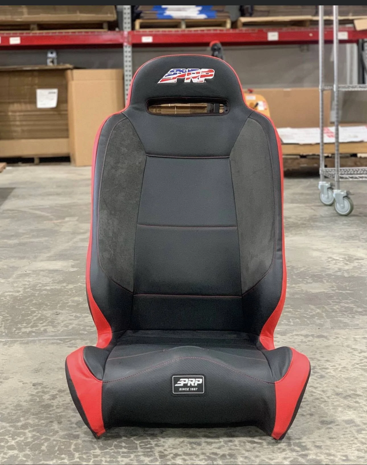

I have question..
I plan to buy PRP seats for my Jeep and I have the cold weather package with the heated seats and steering wheel. Can I remove the heating element from the stock seats and retrofit them into the PRP seats so I can keep the stock buttons and functions and have heated seats in my aftermarket seats? I would prefer this over the $165 PRP option to keep it functioning as stock.
What does the OEM heating element look like in the stock leather seats? It would have to be a two piece setup to work with Enduro Elite seats.
I also plan to run bucket seats in the rear, but I was just going to buy the heated option for that…. But $660 is a little rough for all the seats to be heated and to completely lose the OEM function and go all with custom buttons.

Yes, it's two pads (bottom and back) in each seat along with the occupant sensors. There's nothing you can't strip down and transfer over that I'm aware of.
Thanks, kinda what I was thinking also.
my plan is to run the stock heated seat elements up front and the aftermarket PRP heating elements in the rear with aftermarket switches in the center console in back for control for the rear passengers.
I will probably just order new OEM one for the front and not pull them out of the current front seats, so I can sell them with everything still together as factory. Will just have to figure out the airbag plug and seatbelt etc.. to try to keep lights off the dash.
I also plan to run the PRP Summit seats that don’t have the reclining option.The option is really not need in my setup with the custom cage, I can only recline the seats back set distance anyways. I just want to keep the heated seats and add the rear, as we run without the top on most of the year.
these are my plan.
