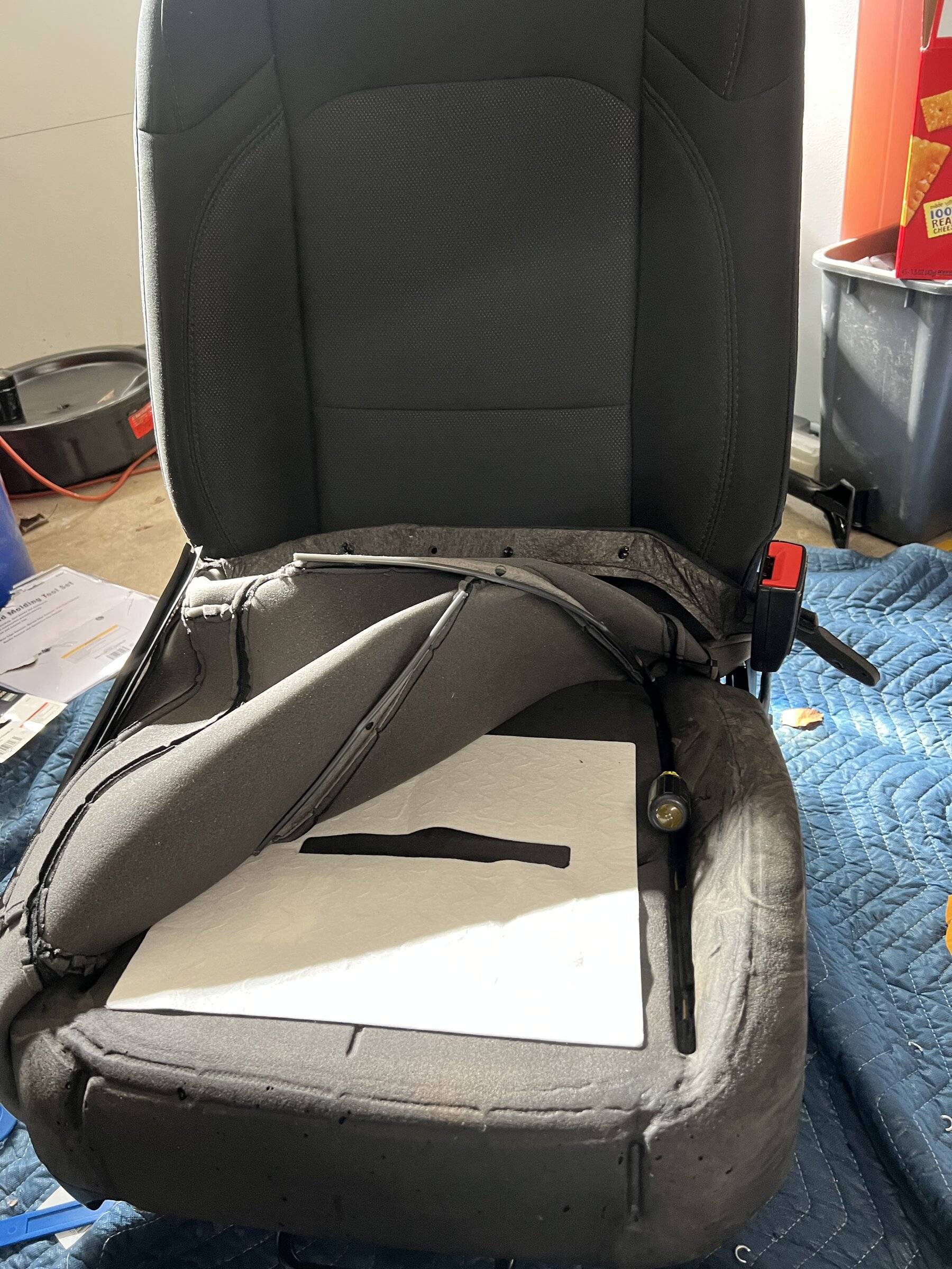

What's involved in installing it (do I need to slice open my seats and whatnot?) and where does the controller go? I am very crafty, but not at all mechanical.
So I ordered the heated pad from Amazon (I’ll send you a link) and a mopar adapter for the 12v cigarette port, and a pair of hog ring pliers (I’ll send you the links as well)

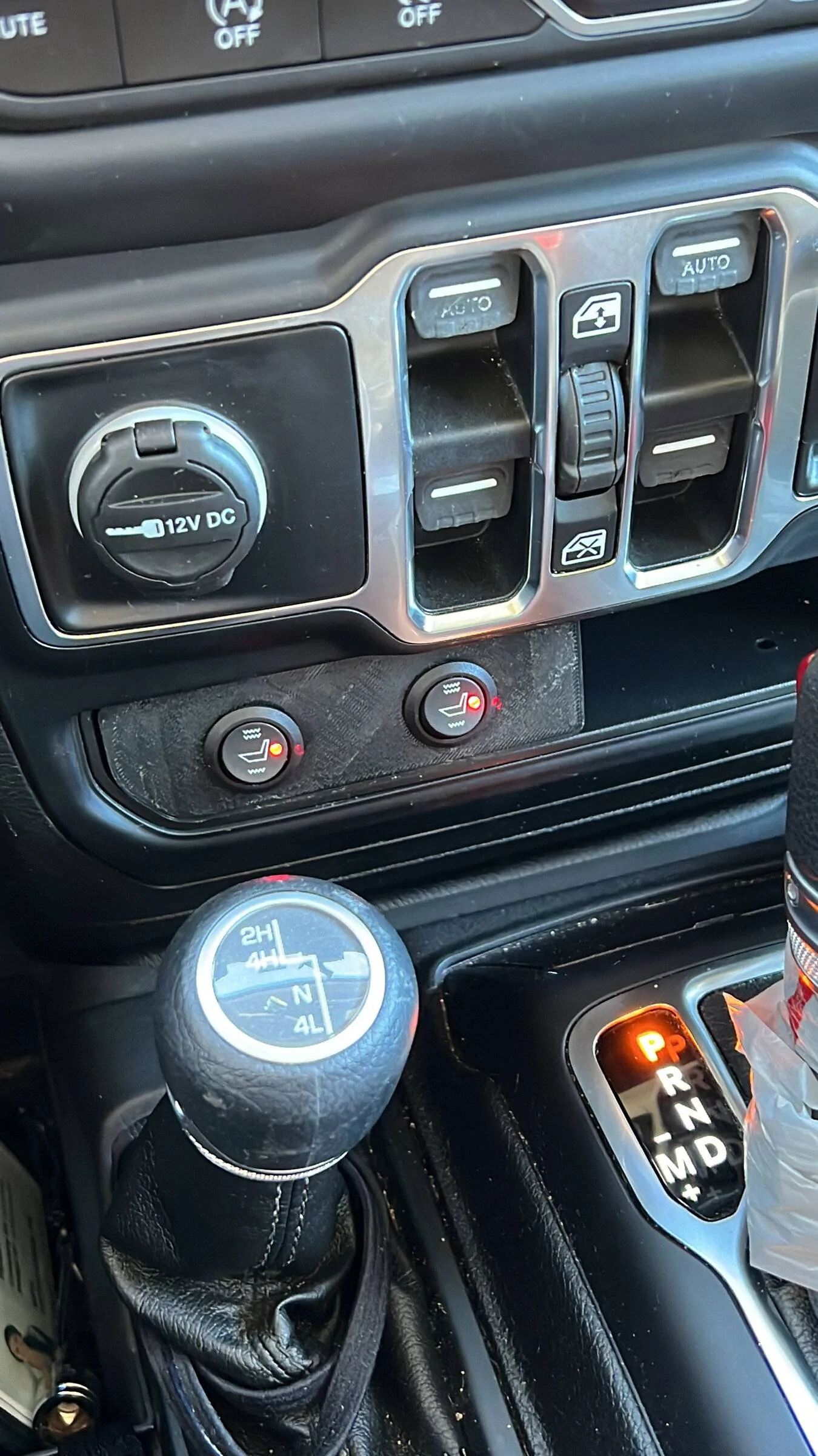

you have to remove the seats and take them 50 percent apart to install the heat pads you’ll need to cut the old hog rings and put new ones in to make sure you seat stays oem tight. I ran the wires under the center console (super easy on the JL) reinstall the seats, plug everything back in and figure out we’re you want to mount the buttons. I 3d printed a cubby mount from someone on this forum (I’ll post the link).
