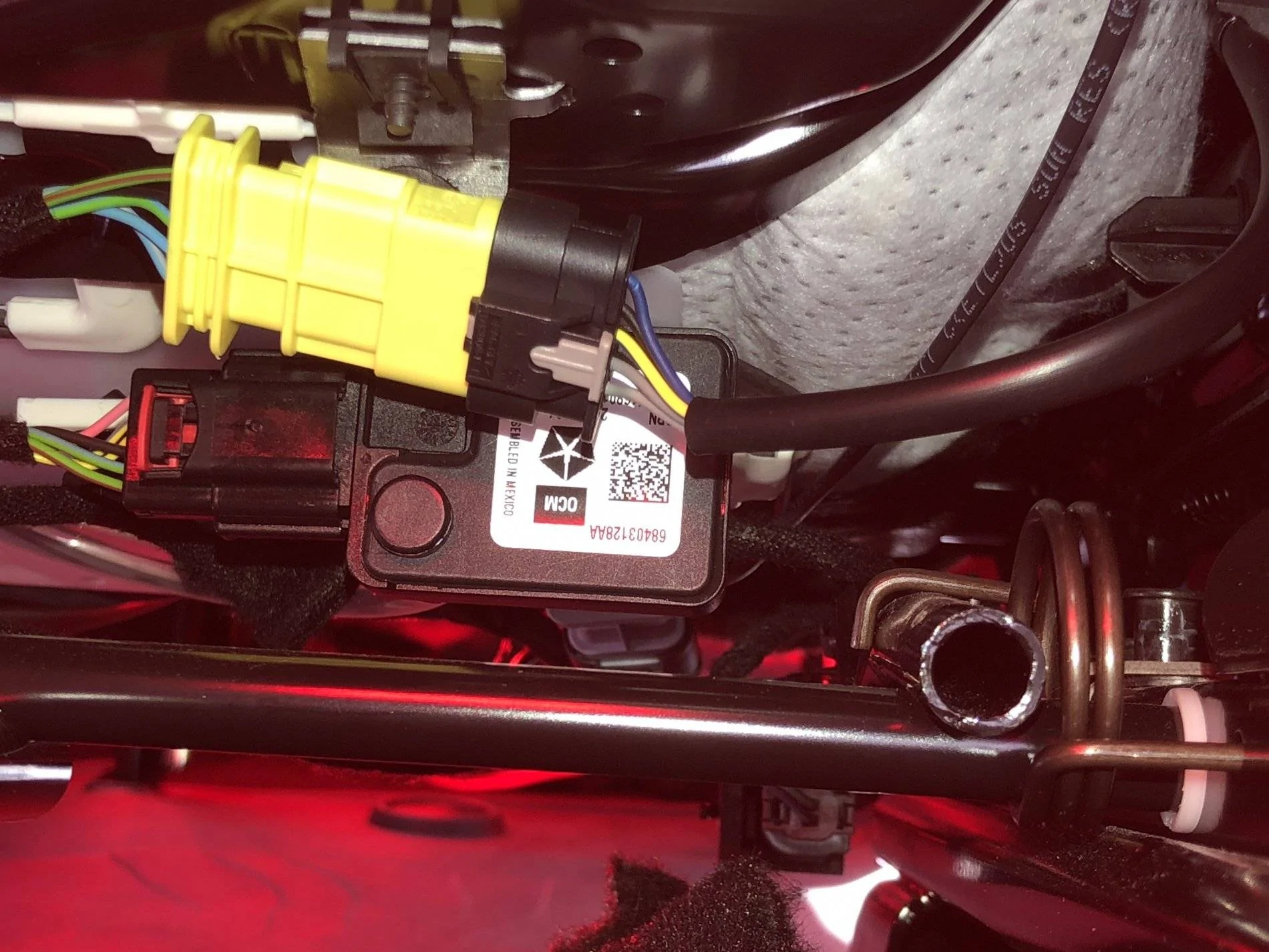

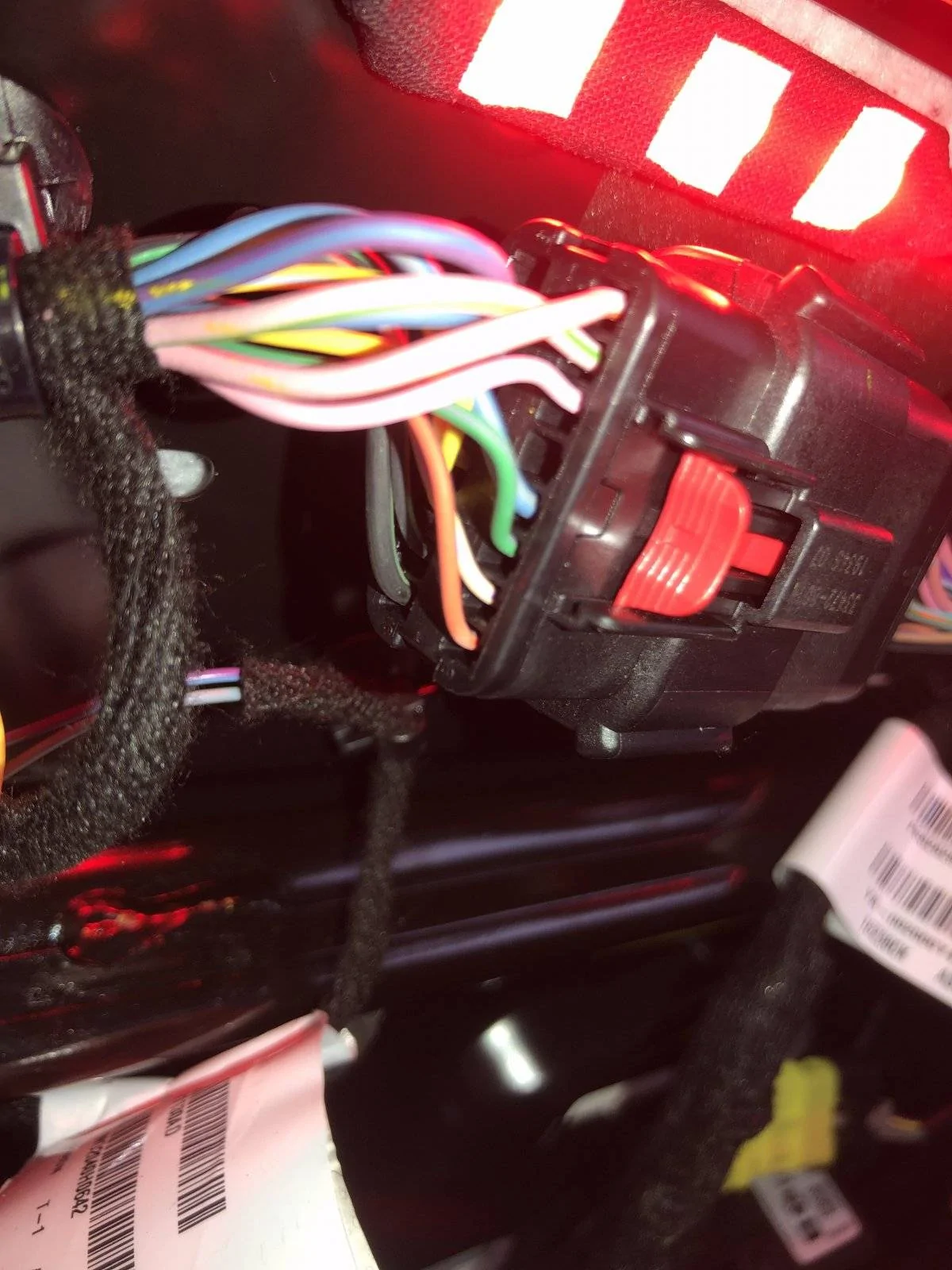

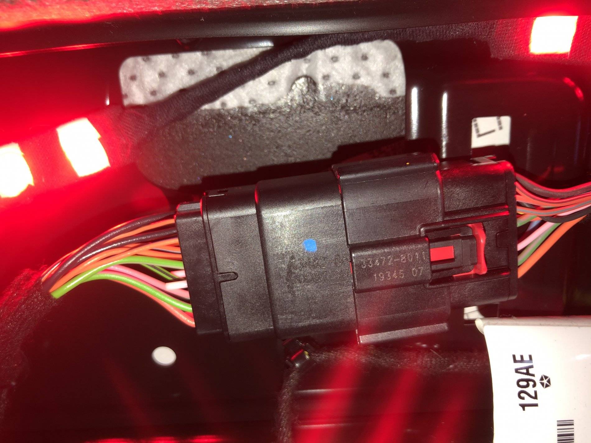

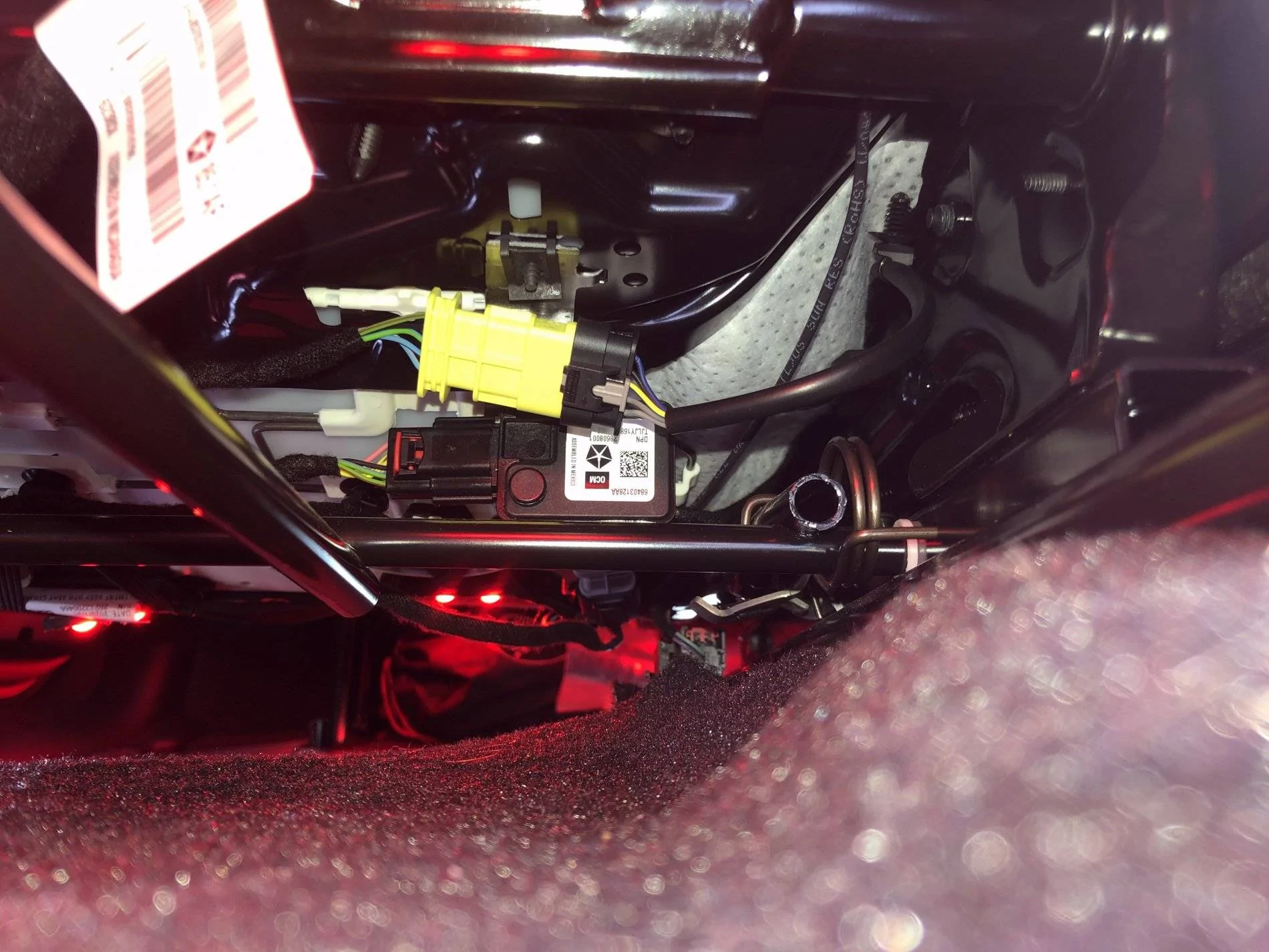

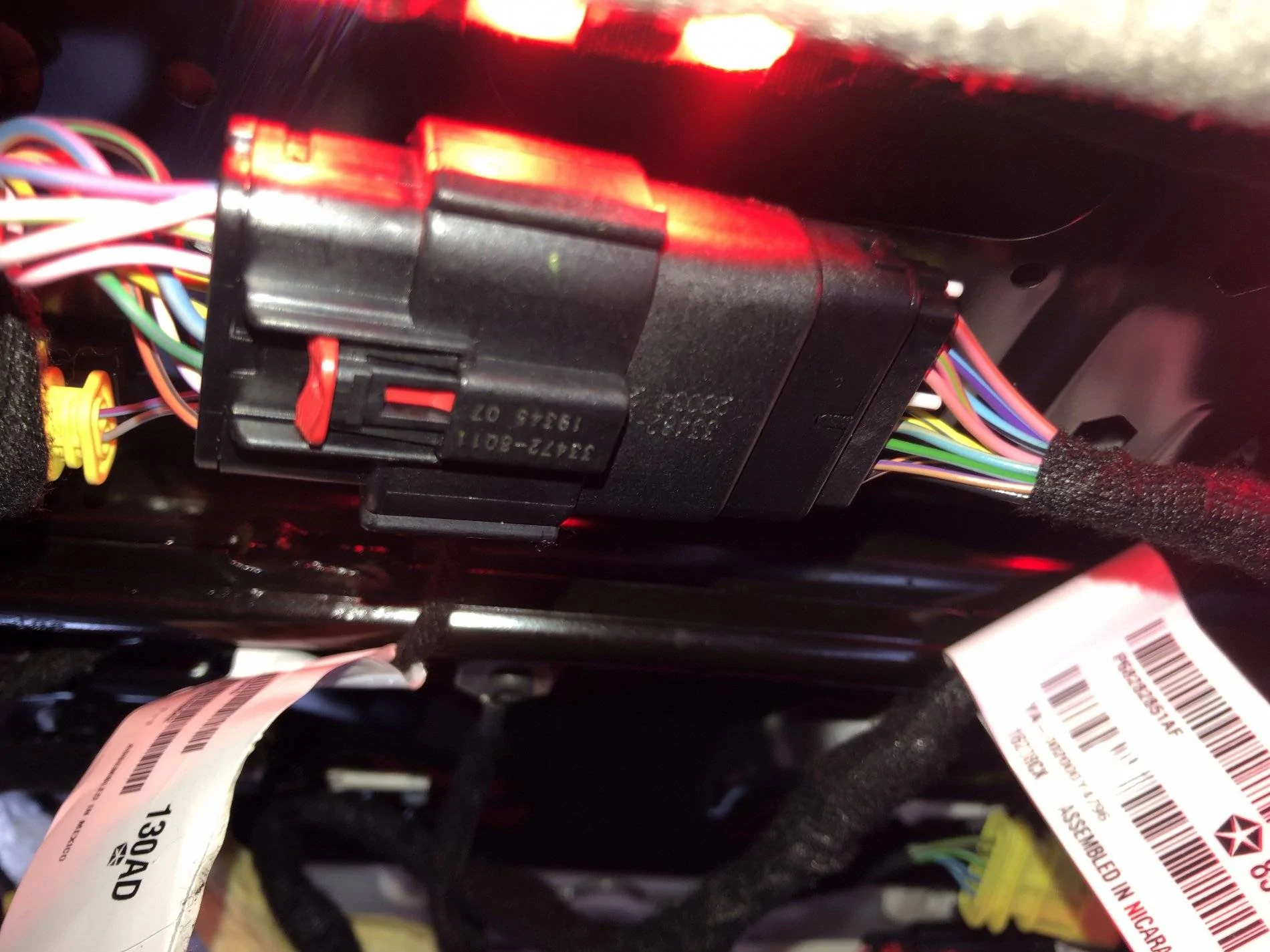

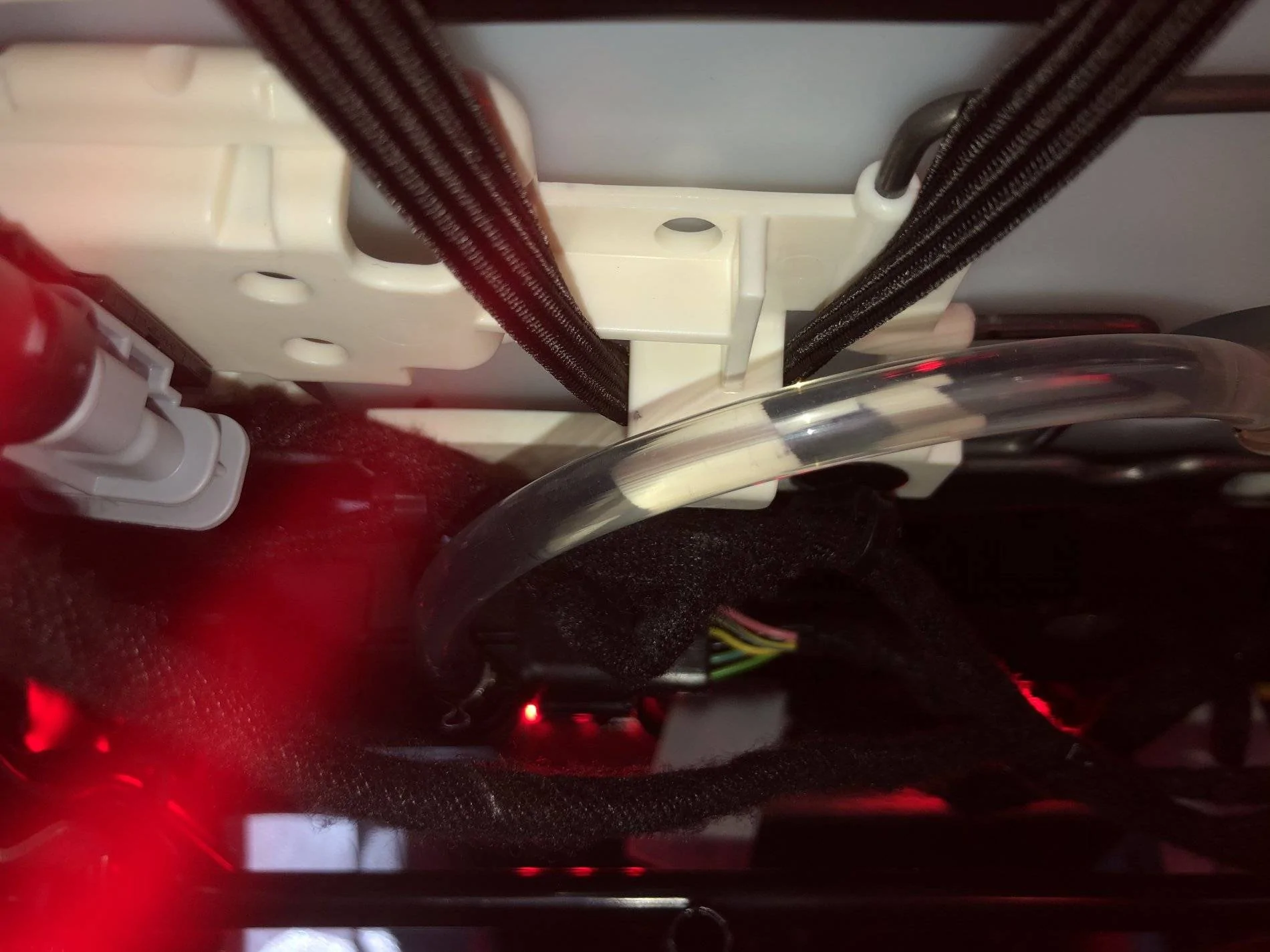

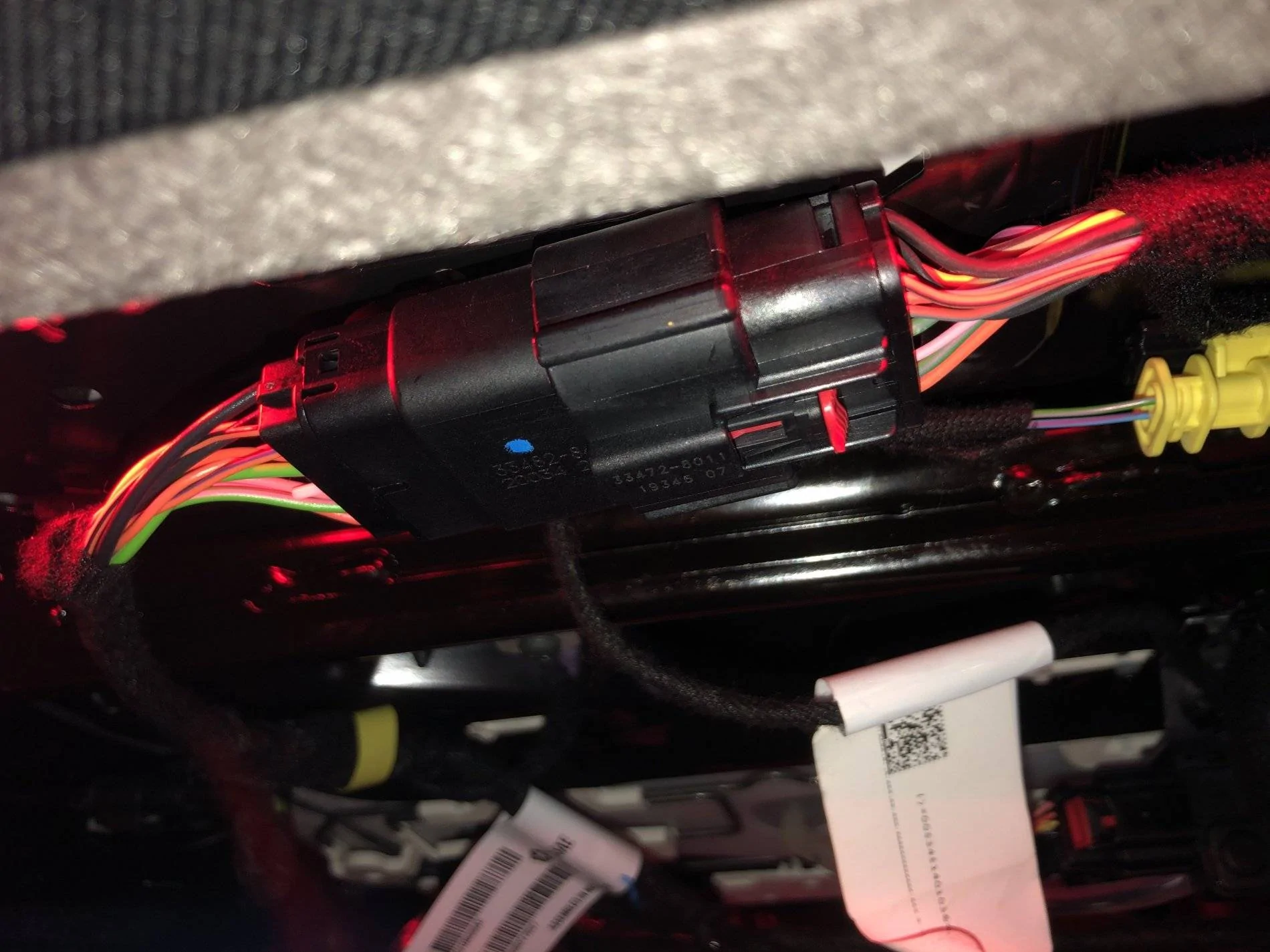

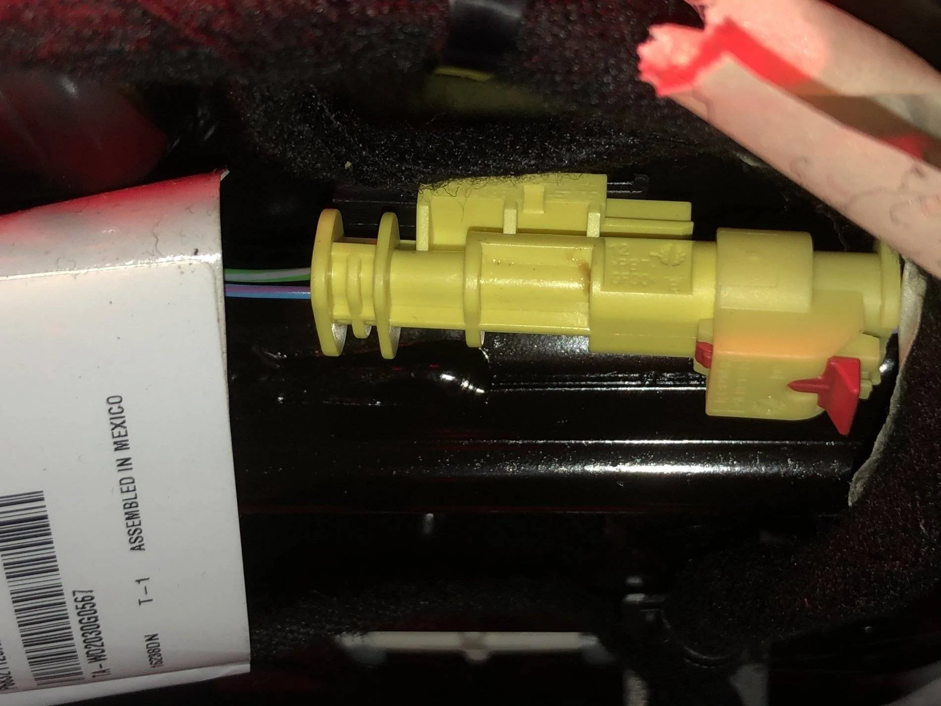

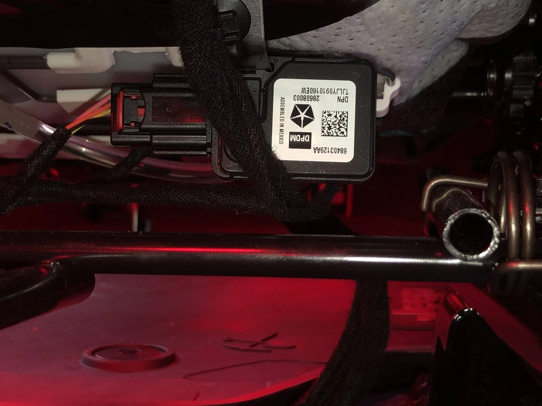

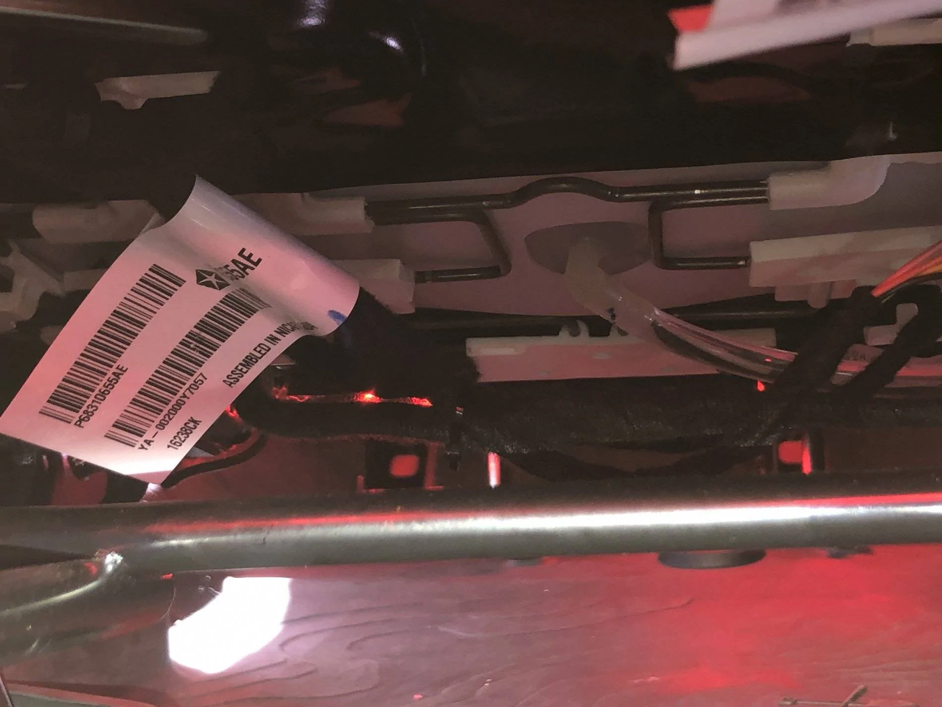

The following photos are all of the driver’s seat taken from the front of the seat looking towards the back of the car:
Jeep Wrangler JL JLU HEATED SEATS MODULE?!?! E36F09D7-50B2-4508-A325-88EBF192E946
Jeep Wrangler JL JLU HEATED SEATS MODULE?!?! 2BAC96BA-C8A4-4547-9274-E6CDB862F9F7
Jeep Wrangler JL JLU HEATED SEATS MODULE?!?! E2F327FF-4598-47ED-9277-B38937E002D8
Jeep Wrangler JL JLU HEATED SEATS MODULE?!?! 4326097B-E4CE-4968-89AC-22D91F474AA4
Jeep Wrangler JL JLU HEATED SEATS MODULE?!?! 5AA1B337-5CA4-408C-9179-7CDFD12015A2
Ignore the red LED’s as that is just an ambient lighting system I fabricated for my Jeep.
I have not given it a detailed look but it appears that there are at least five connectors/connections:
-one large connector toward the front of the seat, I believe this is where the heated seat wires connect to.
-a small yellow 2-wire connector near the large one (which is most likely for the side airbag activation).
- a black 6-wire connector connected to a small black device with part number 68403128AA which is a part of a larger module with the clear hose connected to the large white plastic under the seat cushion. This system is the weight sensor for the airbag to activate when someone its sitting on the seat and also for the seatbelt chime if a passenger is sitting down but not wearing their belt. After looking up the part number, I got the name ā€œOccupant Classification Moduleā€
- a black-to-yellow 5-wire connector that continues up into the seat cushion area as far as I can see/tell.
- a grey-to-black 4-wire connector which I have no idea what is for
If you spot anything else in the photos that are of worth, please let us know!

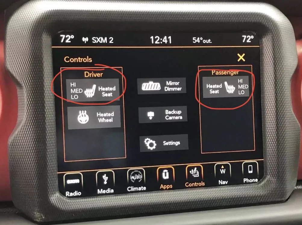

There was no power in those wires because the heated seats weren’t activated. Beside all the wires, you still need to somehow activate it in uConnect so the heated seat buttons will show in the Controls app in uConnect.
Jeep Wrangler JL JLU HEATED SEATS MODULE?!?! 2A3D4B35-6C01-4C8F-8414-7D9382A67C07
As long as this is somehow achieved, the physical buttons will not even be necessary as you can turn them on and off from that Controls app so you won’t have to replace the HVAC cluster with one that has the heated seat buttons.
