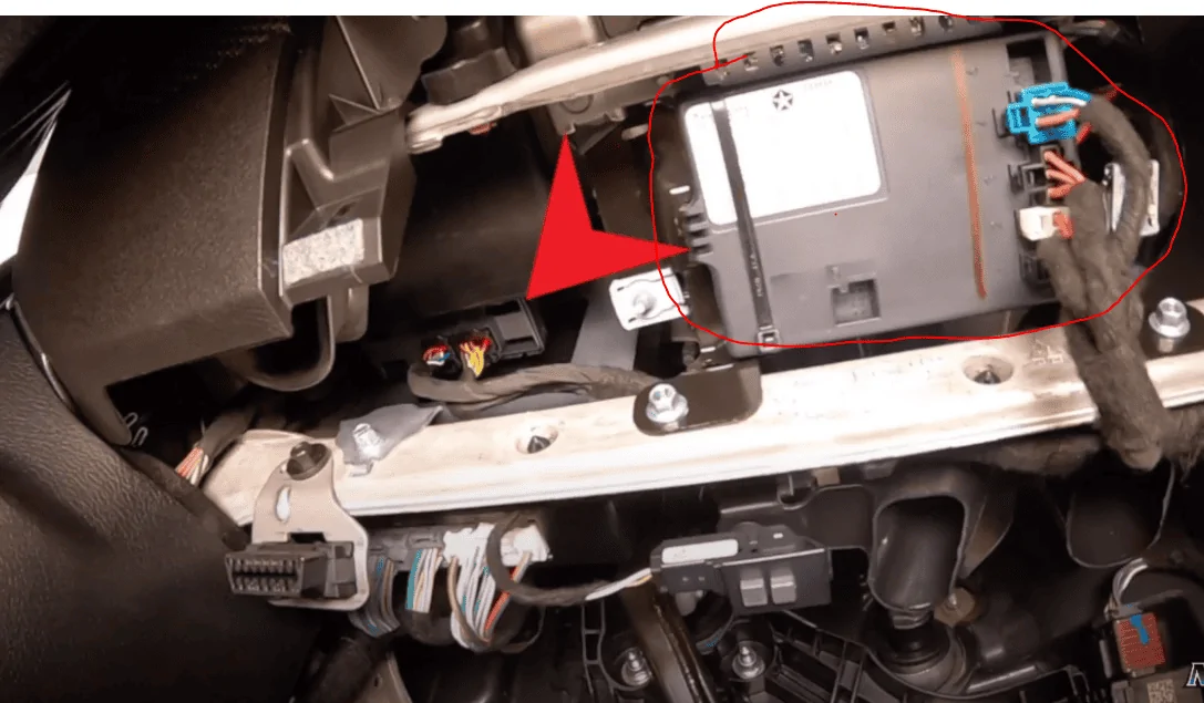

Just for some clarity for me is this the heated seat module? Found this video and they were installing a Tazer JL mini and it looked like the part number I found.
Jeep Wrangler JL JLU HEATED SEATS MODULE?!?! 1603735404800
That it is
