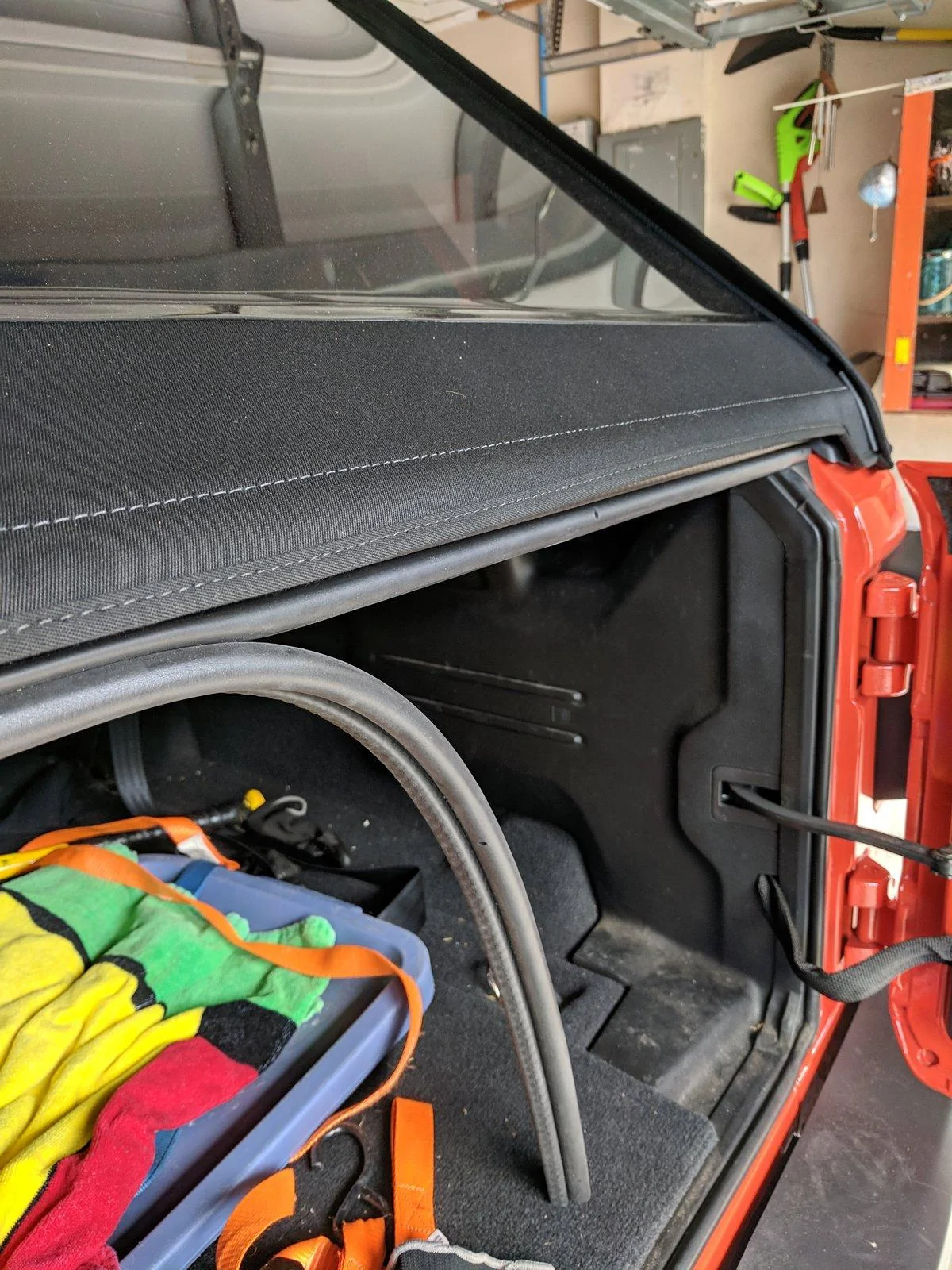

So the other day I pulled into a car wash bay. My son stayed in the back seat waiting while I sprayed some mud off the Jeep. I was using the spray wand. As I made my way around the rear of the Jeep, my son jumped out and said "Stop! You're soaking me!" LOL there was water all over the rear of the Jeep. I blame the crappy seal of the tailgate bar for this also.
Seems like the only part of this top that really needs some work is that rear section. That's where all the water intrusion and wind flapping happens, when it happens.
Overall I still love the top, but I'm just not a fan of the fastback look. I can't wait until summer so I can take the windows out and leave them at home.
I’m having that issue as of last week, I noticed the trim started giving way. I try to re-stick it each time I open tailgate but it just falls off again. I have to jump in back seat to restick. I’ve contacted them about that and the crazy flapping of back window. Both issues have been quite a nuisance, other than that I really love the TrekTop.

Same problem with mine. Started last week! Super annoying!! I contacted BestTop via email today.
They’ll replace that piece with a new seal. I had the same issue. Within a few days of calling I had a new one and it has been perfect since.
Same here. Bestop customer service is phenomenal.
