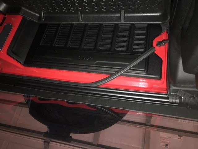

So glad I just found this thread! The flapping has become too much - hard to talk at speeds over 55mph. Plus, within 30 minutes of driving the rubber seal falls out. See attached photo and this video for example of flapping around 60mph:
@BestopTeam I need a fix - the flapping is driving me nuts!
Call or email BestTop...they will send you a better bar that holds the back window in better....Weather stripping came off mine...called them, they sent me a new an improved one....works 150% better.
Give our customer service team a call this morning at 800-845-3567. They'll be in the office all day today and through early afternoon tomorrow given it being New Year's Eve.
I just emailed them the link to your video so give them a little time to take a look at it before you call.
- the Bestop team
