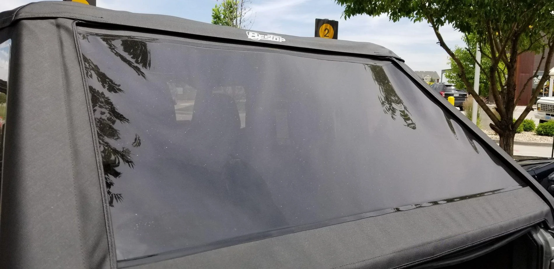

Unfortunately 3 days into my install I have the flappy rear window and failing seal. I haven't even driven over 45 mph or opened the sunrider. On my jk trektop the tail bar would pull tension on the rear window when you rotated it into place, tight enough to bounce a coin off of it. This one leaves the window loose which is visually distracting in the rearview mirror. Attempting to contact bestop now.

Bestop will send you a new top part, rear window and tailgate seal.
Seems they missed something in production, sucks to have to wait but in the end it all works out in your favor, you will have a spare back window and top. The swap takes about 20 minutes.

Damn. So far, I’ve only gotten a new bar and seal. The rear window is still super loose. Guess I’ll call back and ask for the rest.

I have not gotten a new bar, seal, rear window and top. not real impressed with the added velcro, the window still looks a bit loose to me, being its only been on for a few days I expect it to get looser over time.
Overall I really cant complain, BT has been a pleasure to work with, the dealer would have said "unable to duplicate problem" or "working as designed" or some other bs they always come up with.

1) diamond here,
2) windows up, down makes it much worse but thats to be expected right?
3) nothing changes
side notes;
the hotter the day the worse it is,
the additional velcro did not improve it much,
looks to me like the back window need to be a bit shorter and a bit narrower, I don't think the stretch factor was considered.
