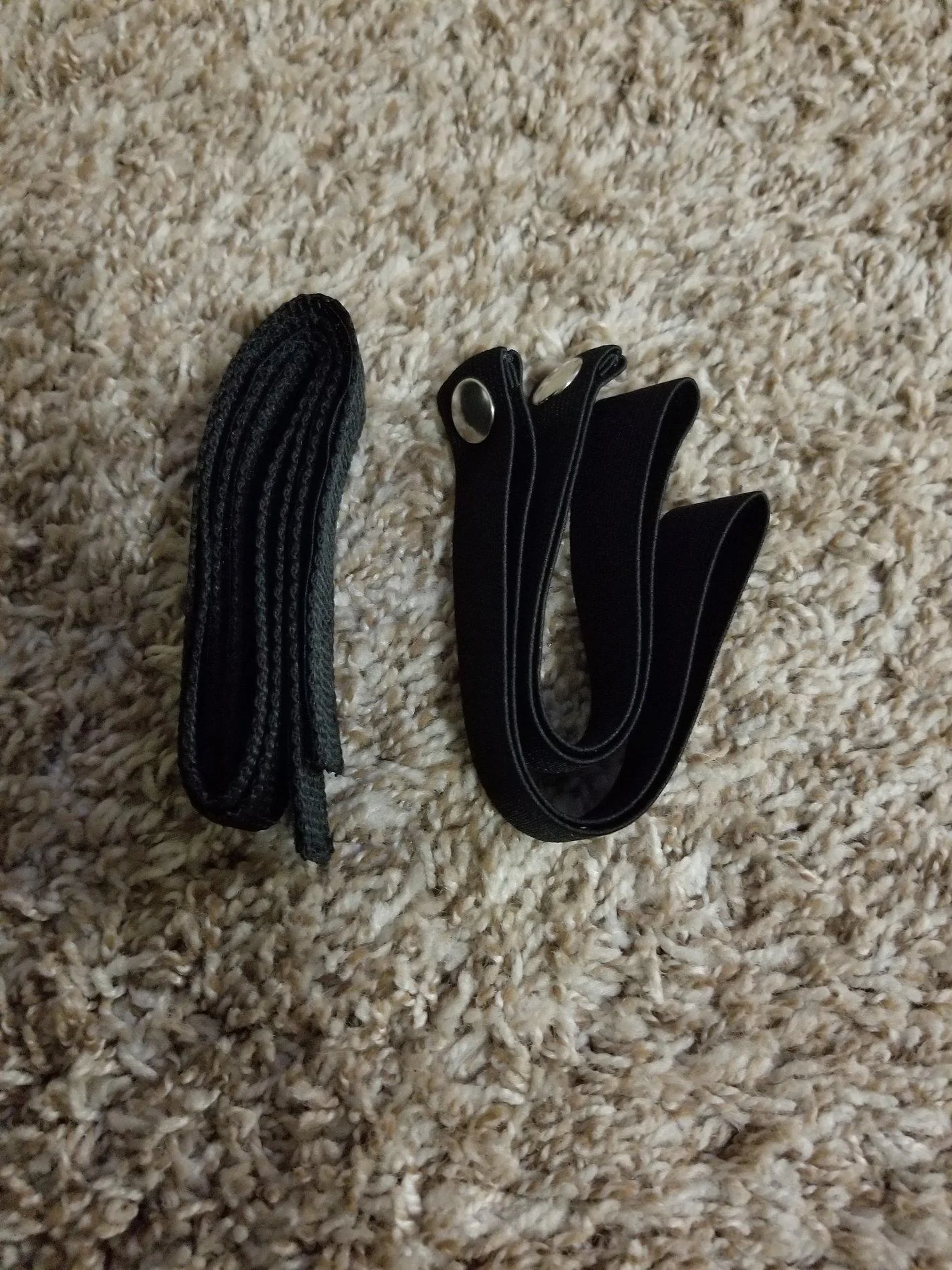

Do you guys know what these straps are for?
I'm installing my soft top tomorrow and I'd like to know what they are for?
please and thank you in advance!.
For tying down the top when it’s in sunrider mode or all the way down.
