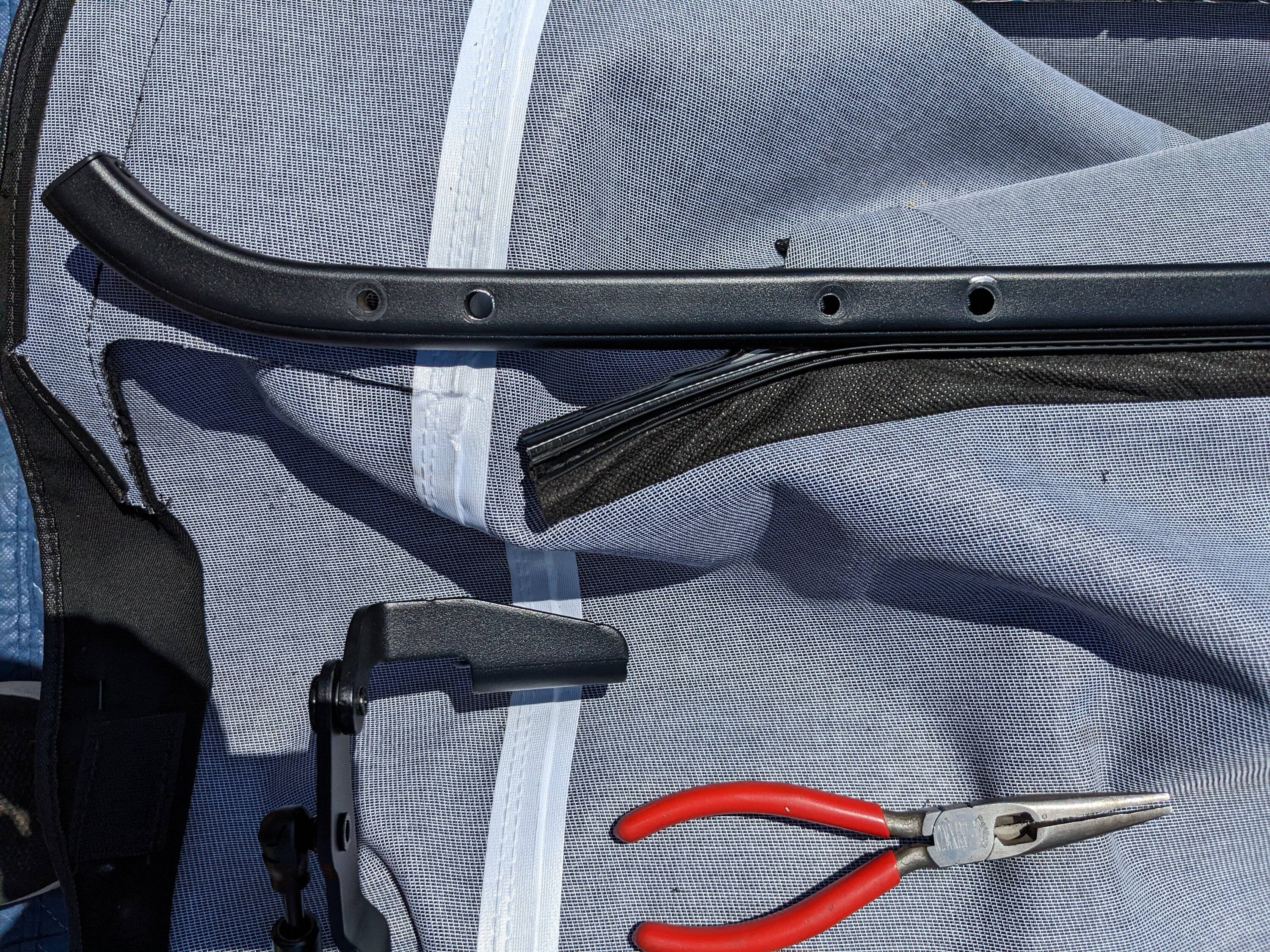

Now here is where I differed a little from JP29's install. I started by removing the screws holding the arms to the crossbar because I thought that you had to slide the fabric off and on each crossbar individually. Instead, I discovered that the fabric has a spline on it that looks like an arrowhead. If you grab the edge of it with some pliers, you can actually pull it out of each of the crossbars with a lot less disassembly.

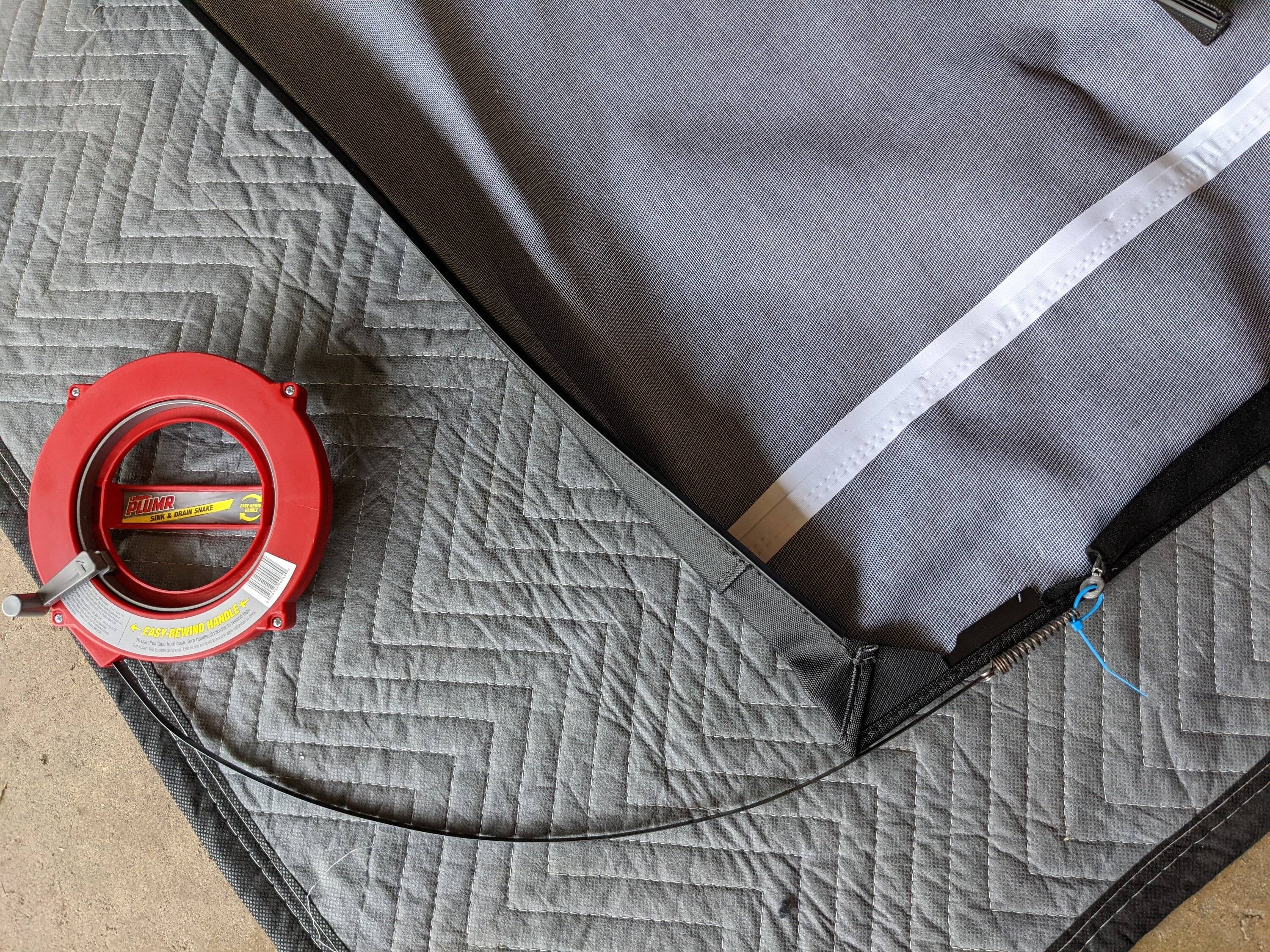

I didn't have a fishing tape, but instead used this sink and drain snake to run the cable through the new top, which worked surprisingly well.
Jeep Wrangler JL JLU Soft Top Replacement Fabric Install PXL_20220704_134718458
Make sure when you're fishing the cable through that you enter and exit the top through the double slits near the rear window area.

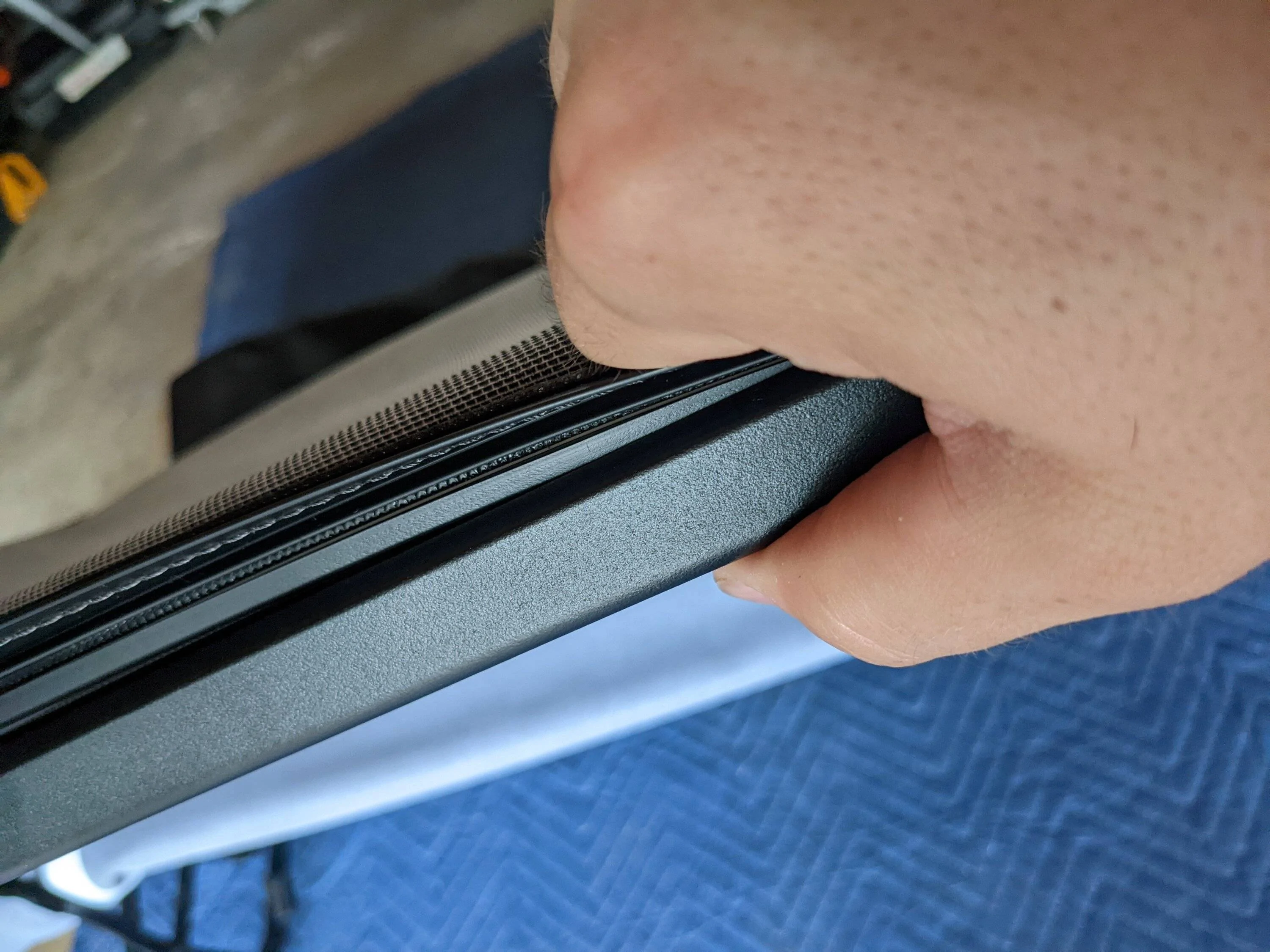

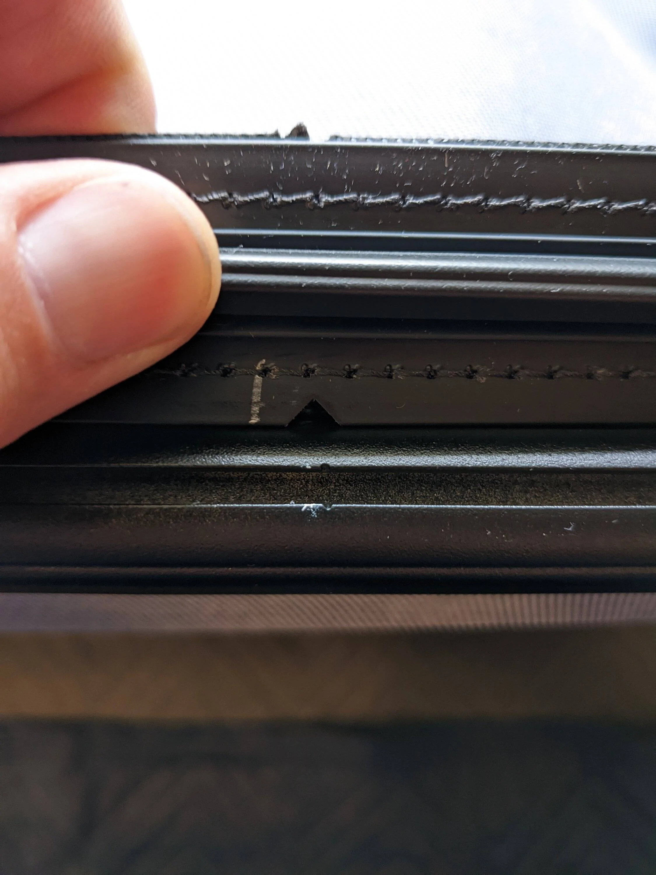

At this point, I connected the new fabric top starting with the 2nd crossmember. Line up the middle notch with the mark on the crossmember, and then squeeze it together with your hand. The arrowhead shaped spline will compress into the slot, then expand and click into place, securing it.

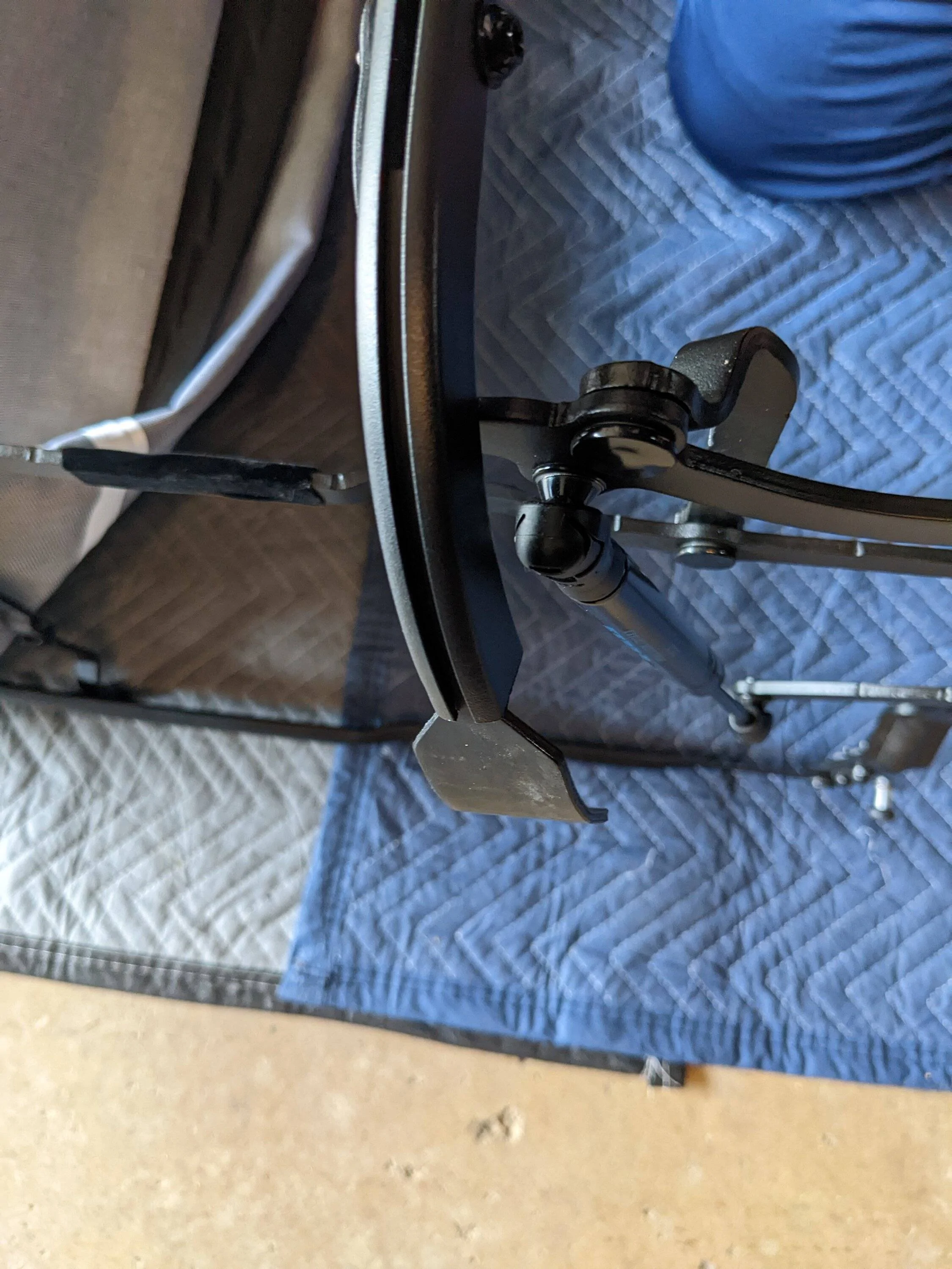

Next I placed the paddles back into the ends of the crossmembers, but the new top did not have the fabric loops to secure them. Quadratec stated that you needed some additional brackets here, but I haven't yet figured out how those are attached or useful. If anyone has a newer style top either without the paddles or without the loops to secure the paddles, I'd appreciate it if you could upload some pictures! In the meantime, I ran a thin bead of 3M Weatherstrip adhesive along the length of the paddle to help secure it in the channel in the crossmember, then reinserted them.
Jeep Wrangler JL JLU Soft Top Replacement Fabric Install PXL_20220704_140323778

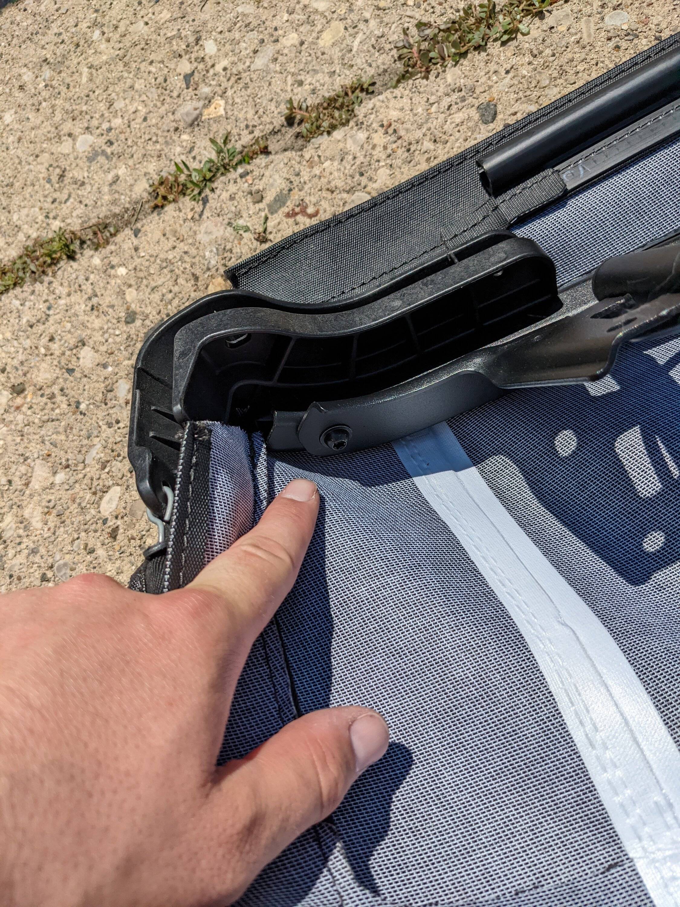

Next I reinserted the fabric toggles into the support arm brackets. I struggled with reattaching the rear corners in place for a bit due to the tightness of the fabric, but eventually got there. Just remember that the screw goes in through the support arm, through the crossmember, through the reinforced top fabric, and then into the corner block.
