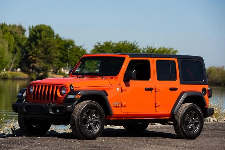

Works great, put JK Recon wheels on the wife's Punk'n. Looks much better with the darker wheels.
Jeep Wrangler JL JL/JK wheels interchangeable? Punkn_Wrangler2
