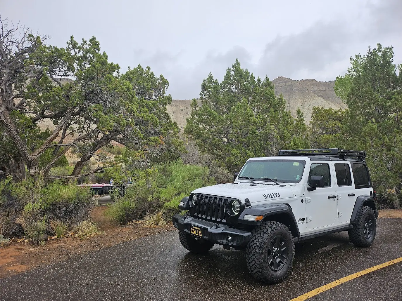

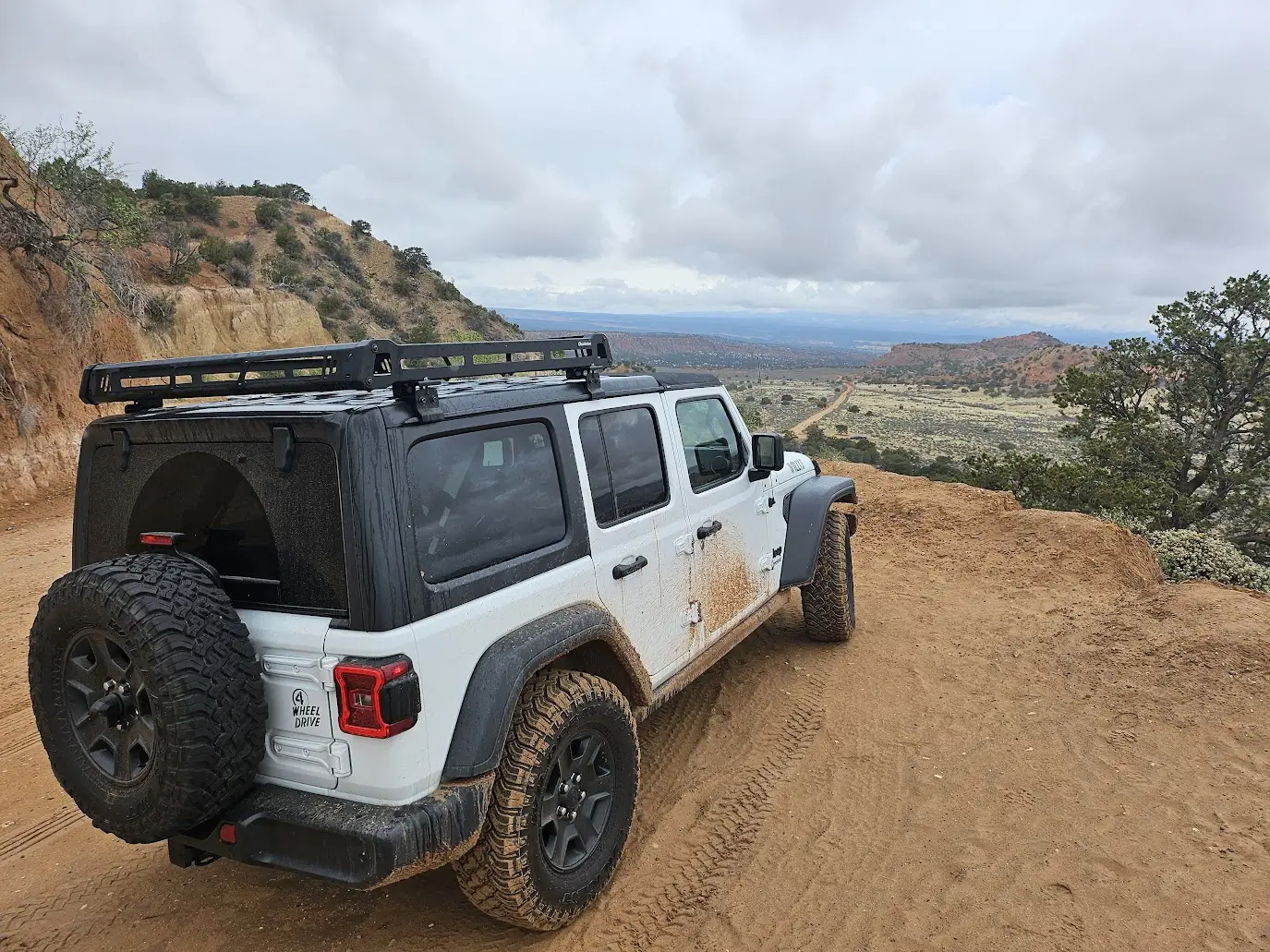

I put Gladiator Mojave wheels on mine as I got a great price with 33" MT on them... had to buy a single for the spare though. Added bonus for me was the offset is a little less at 37mm vs 44mm which moved my wheel out about 1/4" to align with fender better.
Jeep Wrangler JL JL and Gladiator wheels interchangeable? 1755331987652-nj
Jeep Wrangler JL JL and Gladiator wheels interchangeable? 1755332200875-9a
Jeep Wrangler JL JL and Gladiator wheels interchangeable? 1755332280735-my

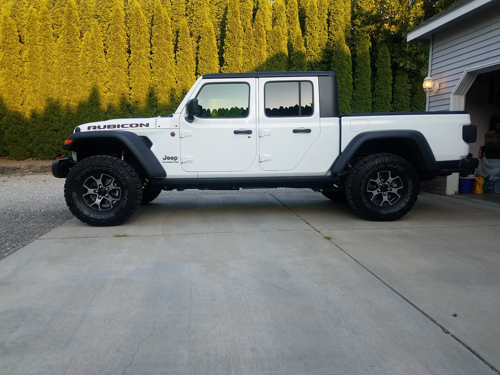

Yes
Jeep Wrangler JL JL and Gladiator wheels interchangeable? 20200702_195441
