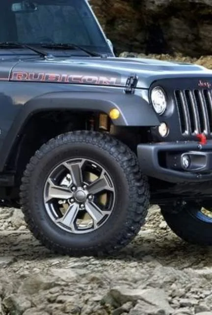

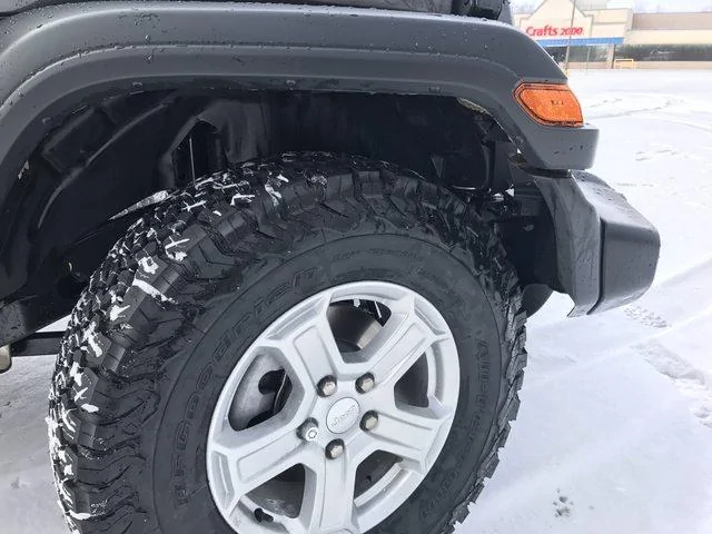

Well i sent it on some JK Willy’s wheels. I have a sport s. Used the stock lug nuts. Used the stock sport s tires mounted to the JK Willy’s wheels.

Jk wheels are fine on a JL, and the other way around. Just use JL nuts on a JL and JK nuts on a JK. I had JK wheels on a JL, and now have aftermarket JK wheels on a JL.

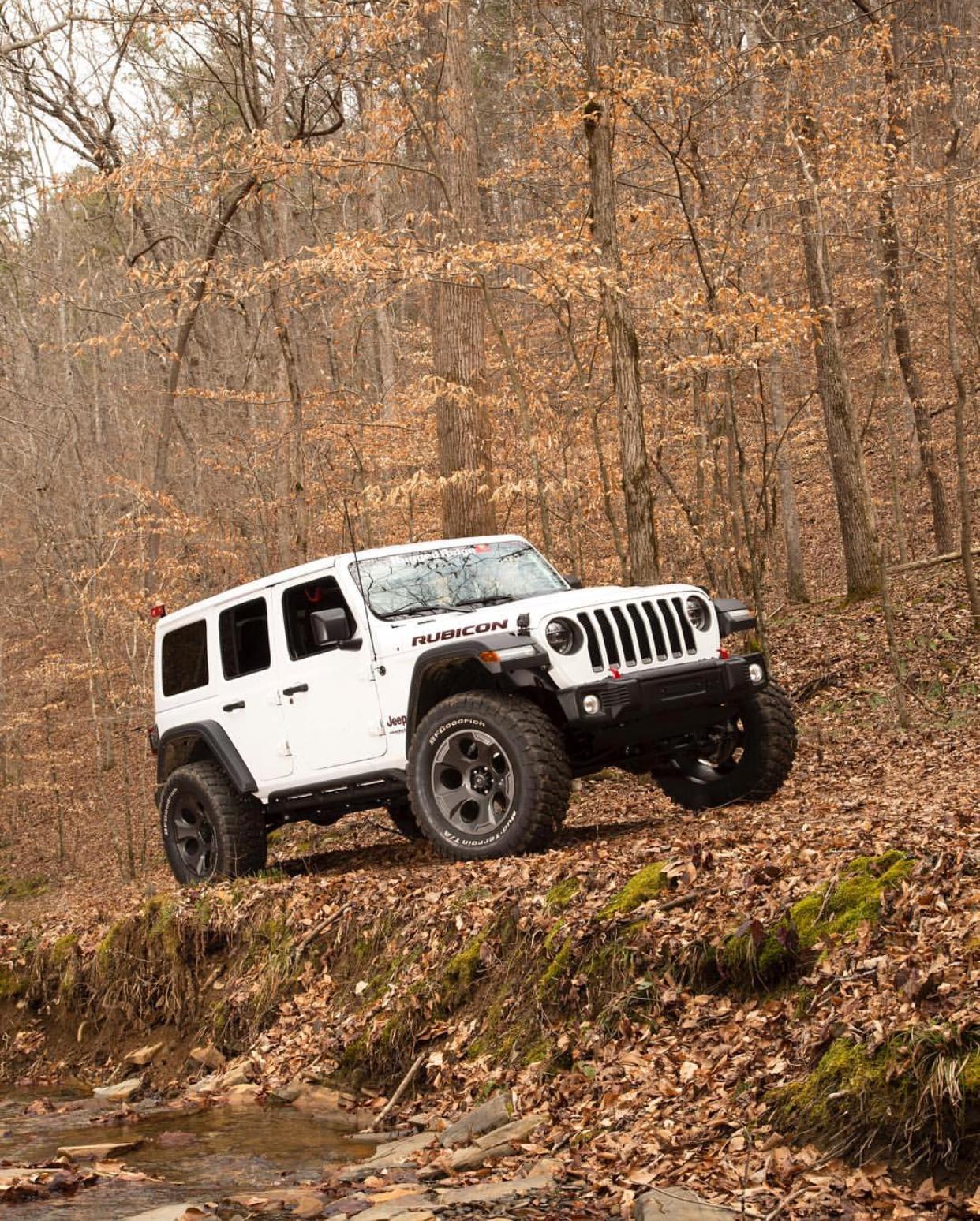

I have AEV Pintler's on my 24 JLUR that were once on my JK Rubi. Offset/backspacing is slightly different so even if those new Goodyear Boulder MT's weren't wider they still would have stuck out just a bit. The stud size for my new JLUR is larger as well as a different thread, and, the outside diameter of the factory lug nuts was to large to fit the lug nut hole in those AEV Pintler's so I couldn't use the factory lug nuts. I called Gorilla Automotive Products and they had me fixed up with the exact part# for the one I needed then passed me over to their parent company wheelacc.com who had them in stock. They shipped them out same day I ordered them and I had them in hand the next day. I'd have to go look to get the part # but Gorilla makes a couple different lengths. I ordered the shorter ones so they wouldn't stick out and everything turned out perfect. Gorilla Automotive's service was beyond what I expected and couldn't be happier with my experience from them.
