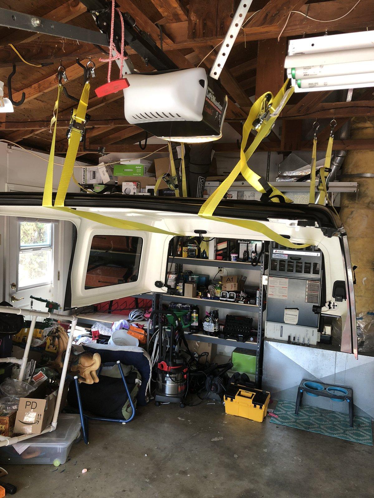

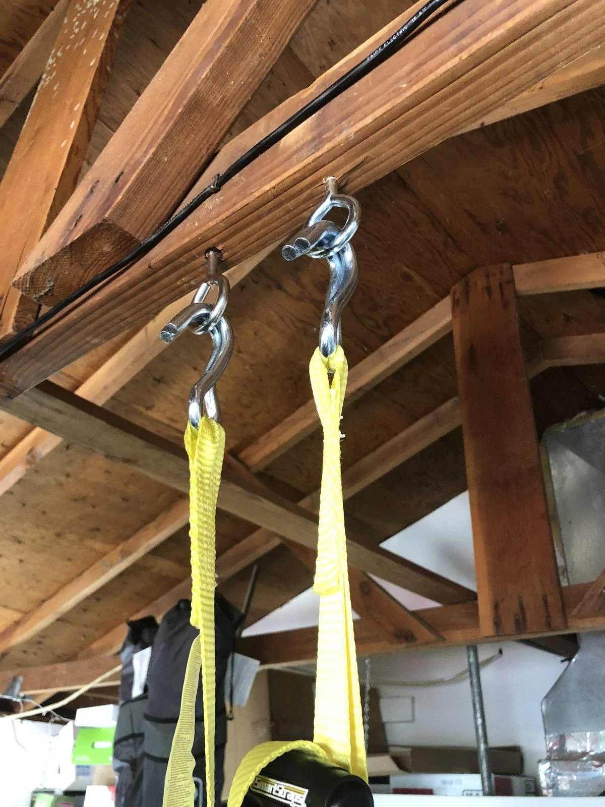

Built this setup yesterday. Took about 30 minutes to install, about $40 in parts and I can remove and reinstall in about 10minutes each way. Not the prettiest setup but it’s solid and works well and I can do it all myself.
How's installing the top back on? Won't the top just fall when ratchet is released? Thanks for sharing
Not at all. I have one ratchet on each corner, unlock one corner and it loosens that strap and each corner lowers by about 1/4” at most. Then relock the strap and move to the next one. Walk around the Jeep two to three times unlocking the strap on each corner and it lowers it back on very gently. It’s been getting chilly here in Northern California so maybe this weekend I’ll post a video of me putting it back on to give you a better idea.
Sweet, I'll have to do that this weekend, thanks! Hey, I'm in NorCal too, nice having the top off but I'm so ready for these cooler temps. Take care!
