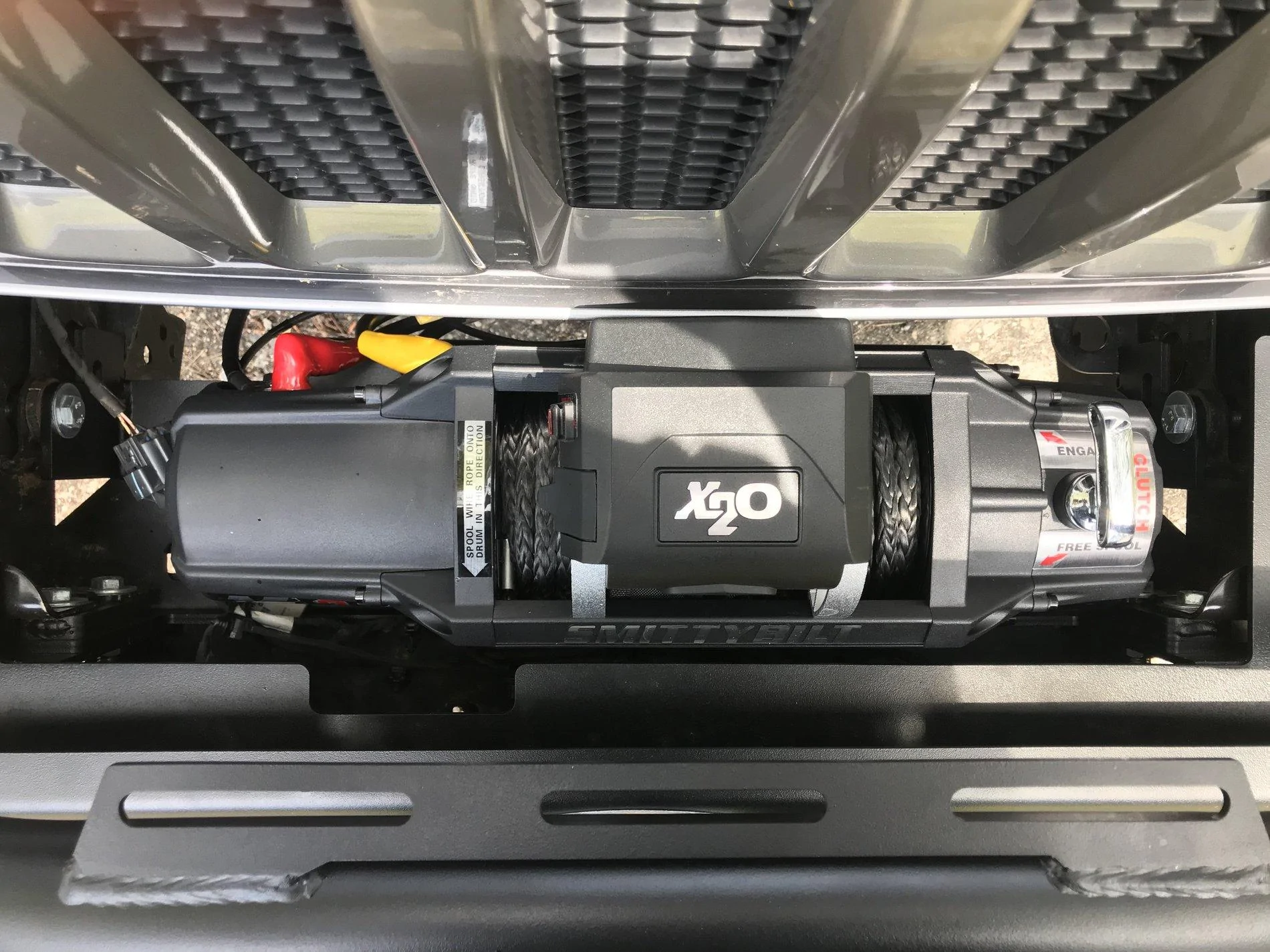

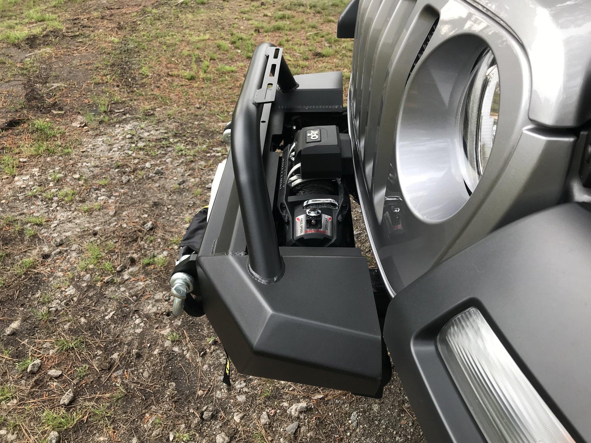

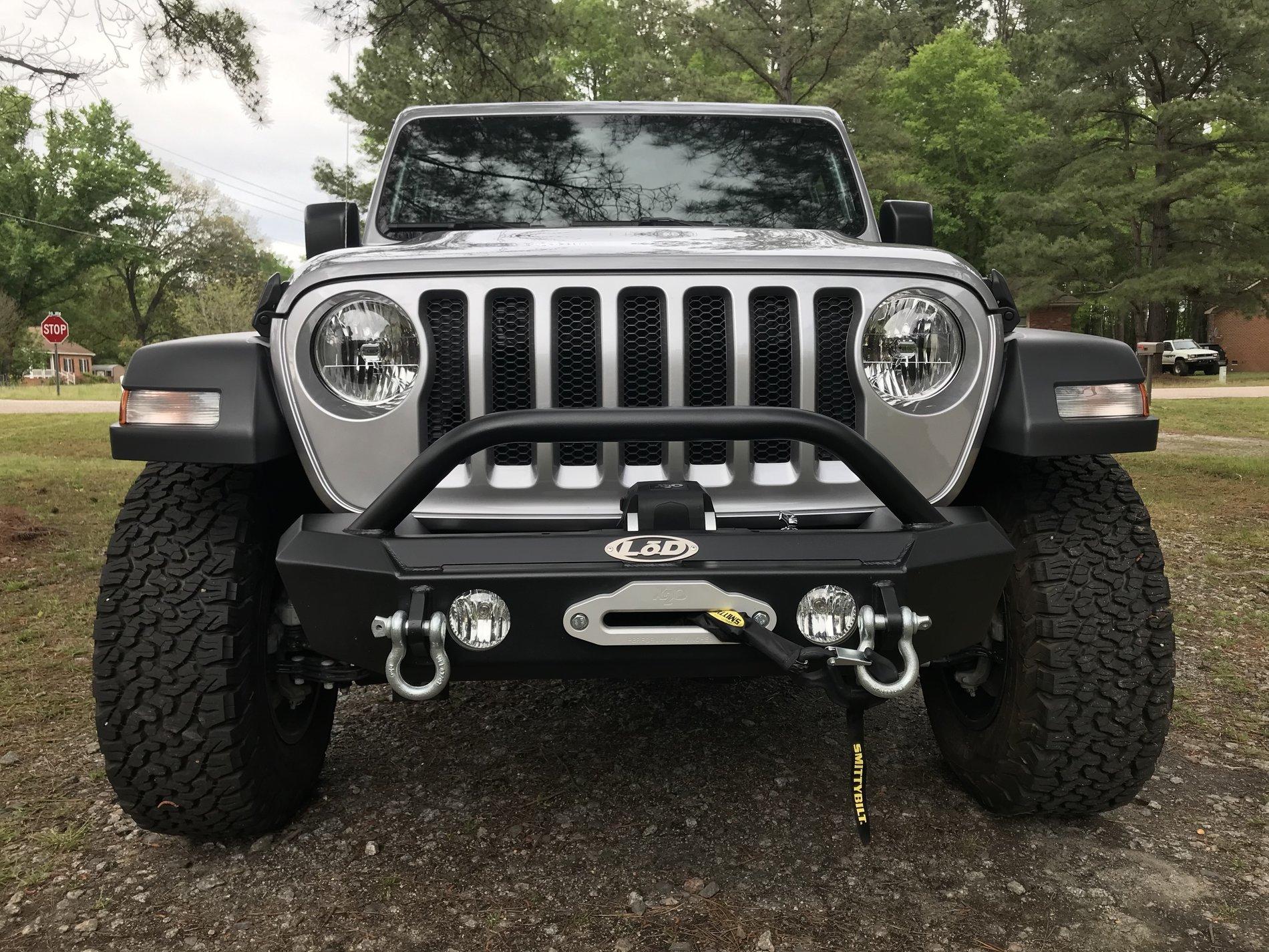

Winch install went smooth. I had to remove the front bumper but without a winch it was easy to remove. The winch fit great on the LoD winch plate that came with the bumper.
Jeep Wrangler JL It's just a sport PlLVpe+JS5Kc17+dqHFqkw
Jeep Wrangler JL It's just a sport dNgGnDfETP2nh8CDaFzlo
Jeep Wrangler JL It's just a sport pimA0NMLQuydMiaQipN%kA
The winch still has plenty of room between the frame rails on either side. The solenoid box is pretty close to the grill but fits perfect. I wanted a low profile setup and I'm really happy with the way everything fit together.
A few pictures to show how close everything fits. The solenoid box is not touching the grill.
Jeep Wrangler JL It's just a sport NCGEsgFoQ8OAR5cgHYGbv
Jeep Wrangler JL It's just a sport n81orXTXQuGjswA8BZHaz

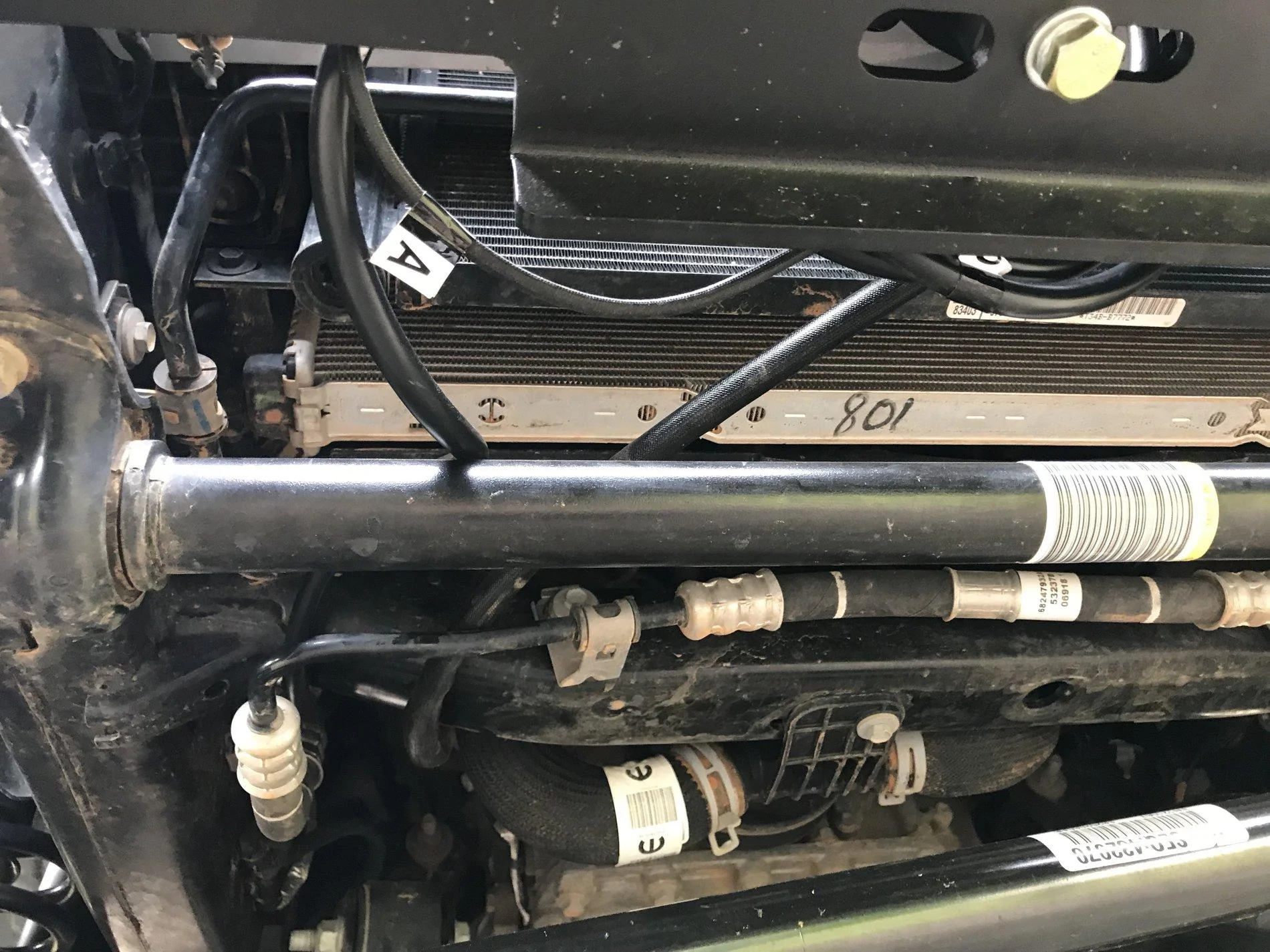

Next for the wiring, I am still thinking about how to clean up the power and ground wires.
I ran them both above the sway bar and under the subframe.
Jeep Wrangler JL It's just a sport pM0g8rPtTZqSq2y0VU1bKQ

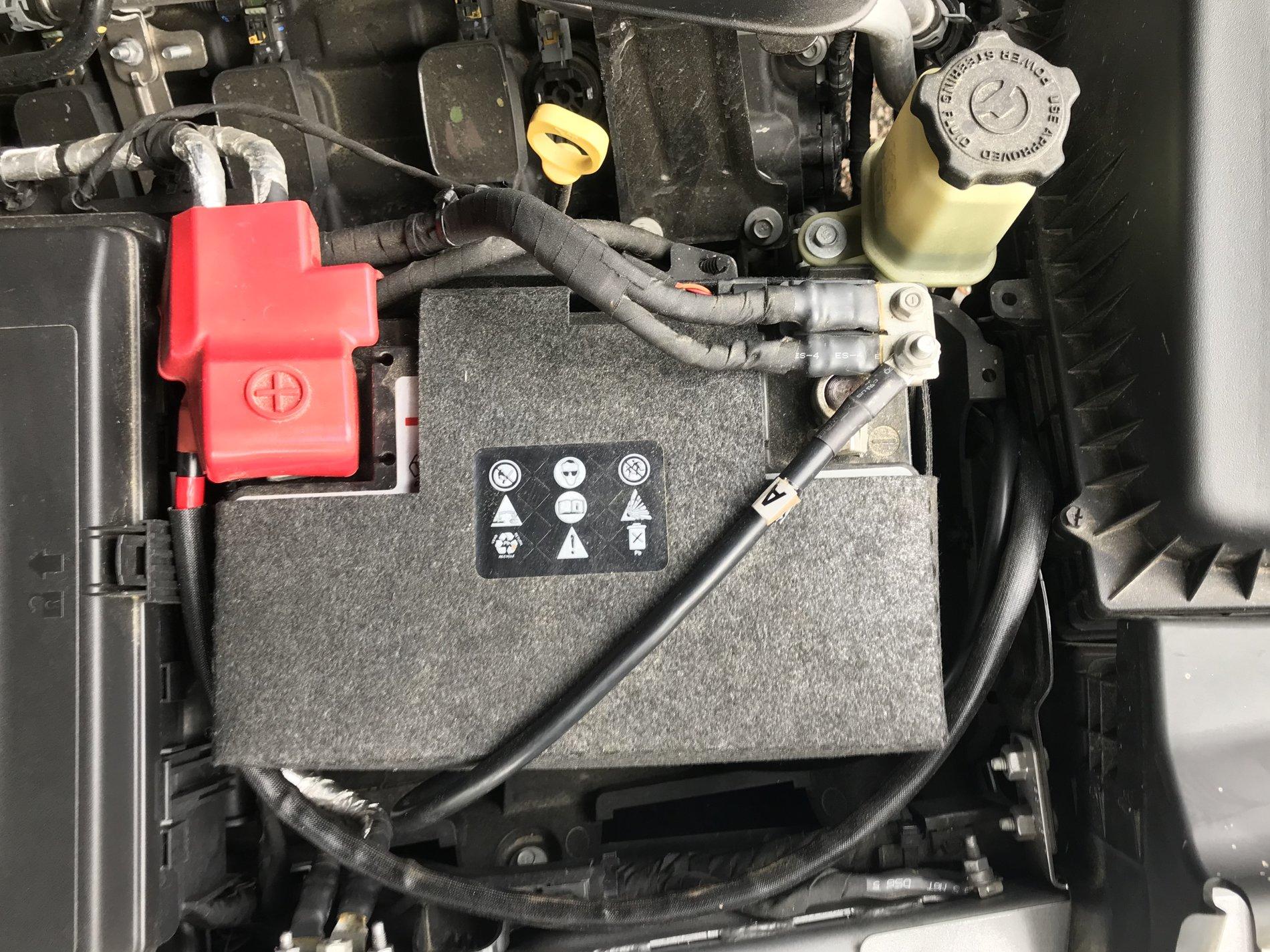

After running under the subframe I ran them both up here between the airbox and the battery
Jeep Wrangler JL It's just a sport EKiIsq1sRg+peQEfMwCoGQ
I finally attached the wires to the battery which I will clean up. I want to open the hood and have myself convinced the winch wires could have been installed from the factory.
Jeep Wrangler JL It's just a sport fullsizeoutput_5bc
If anyone has ideas on the wiring feel free to comment.
Overall I am really happy with the bumper and winch combo. I'll have to pretension the winch rope soon I just wound it up using hand pressure for the moment.

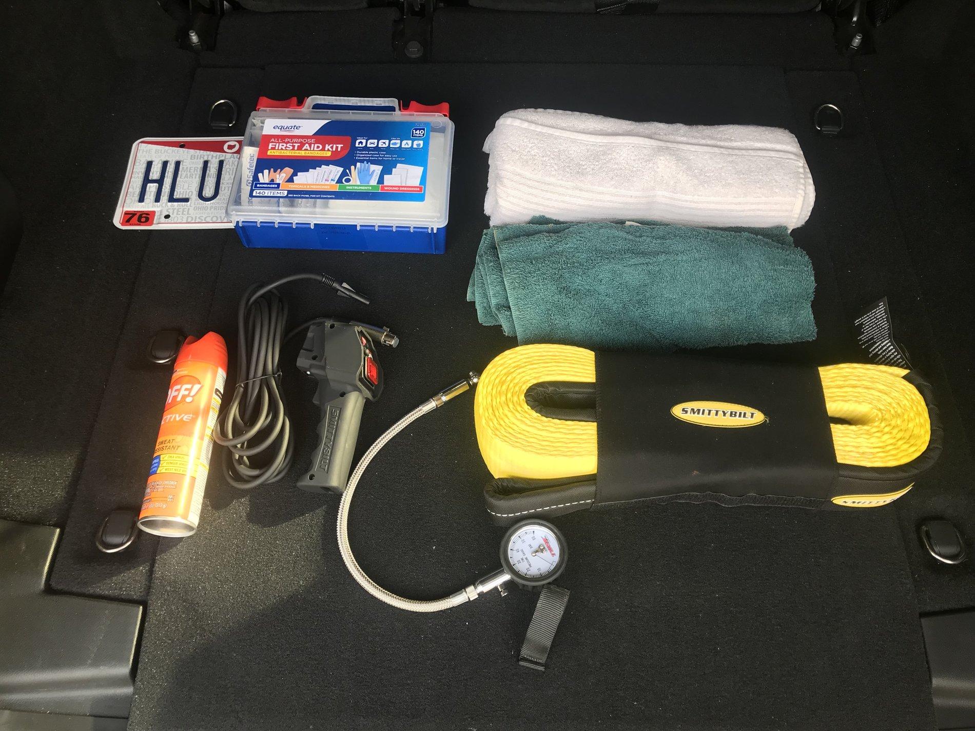

This is what I currently have in the back storage area.
Jeep Wrangler JL It's just a sport fullsizeoutput_5c0
I have:
Smittybilt tow strap
two towels
first aid kit from Walmart
air pressure gauge - I could later replace with a deflator but this works well for now.
off bug spray
winch controller and cable - I'll move this to the glove box when out on the trails.
Useless front license plate
All this tucks away just fine.

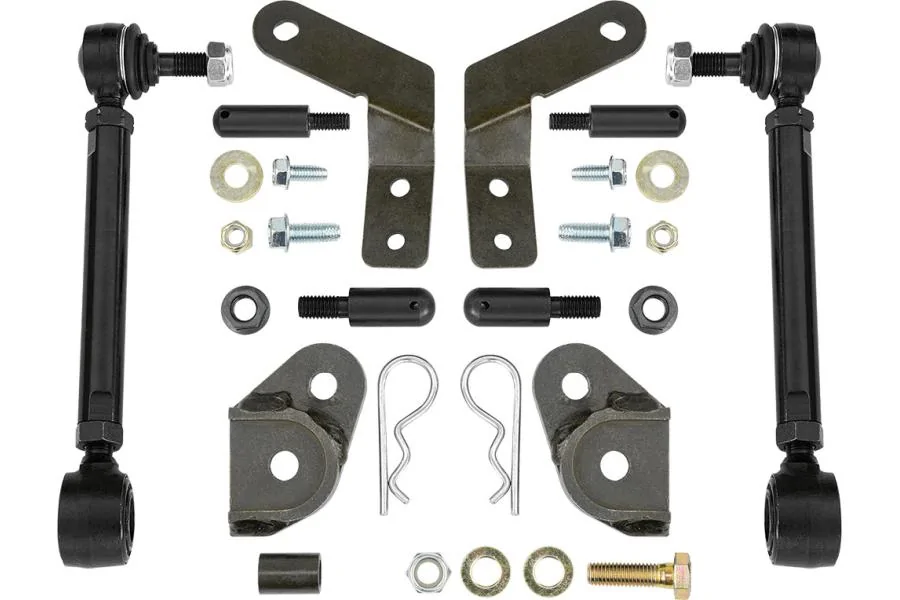

With all that weight on your front you really need a lift anyway. I installed the Rancho 3.5" lift with the RS 9000 adjustable shocks I cold not be happier with the ride.
They are adjustable however do require a 2"-6" lift, there is an extension bracket included in the kit. Get that lift as I am not sure disconnecting without a lift would have some clearance at full flex, I could be wrong though. Definitely if you have larger than stock tires...
The Brackets center bottom are the extensions, the Brackets center top go on the frame with the post that holds the bars when up. It is a great setup.
