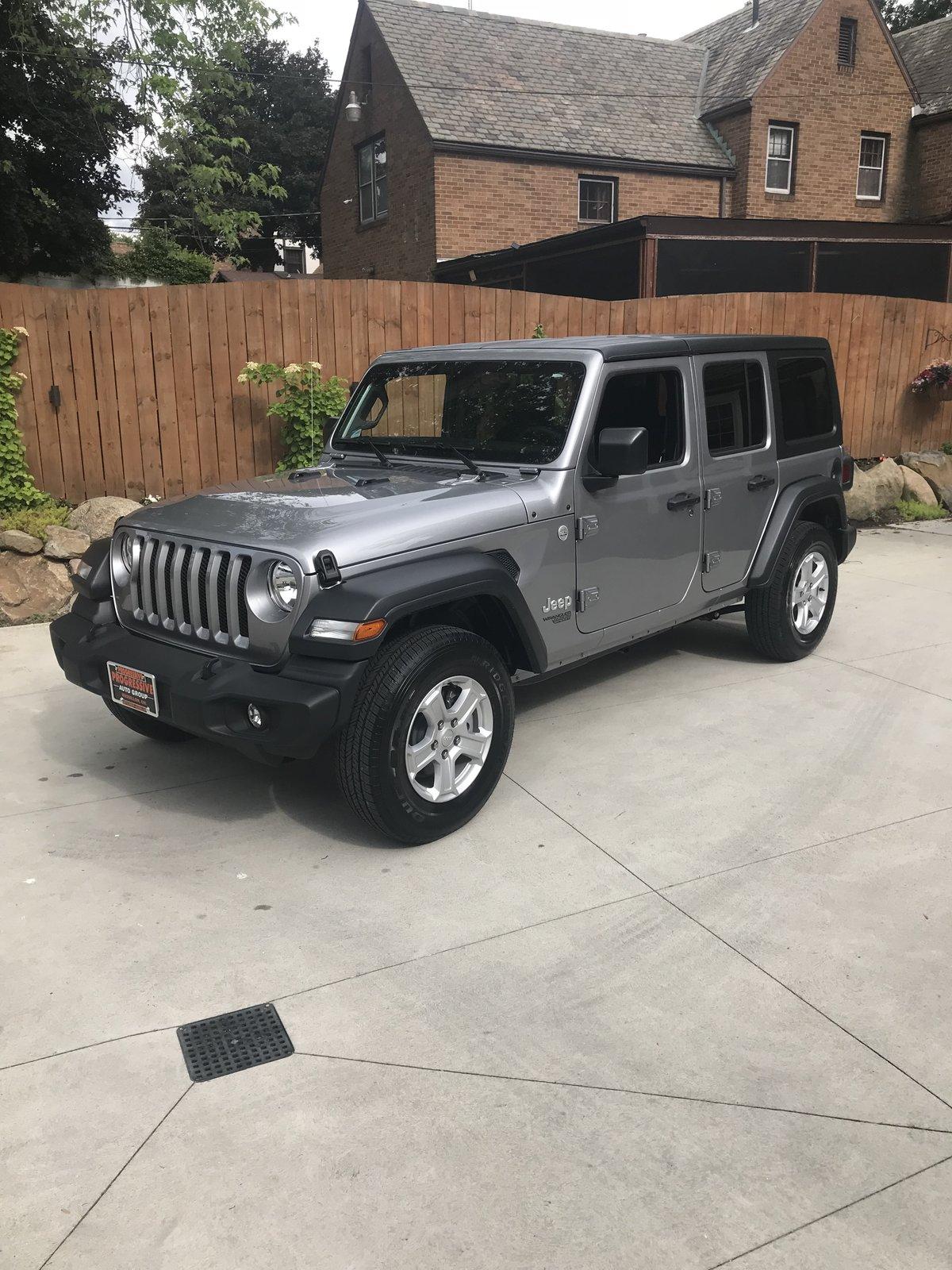

This is right after I brought it home from the dealership. This was the most exciting day ever. The Jeep is a billet silver sport s with the Uconnect 7" display, convenience group, mopar floor mats, and my favorite part a 6 speed manual. I learned billet silver is the least photogenic color but I think it looks great in person.

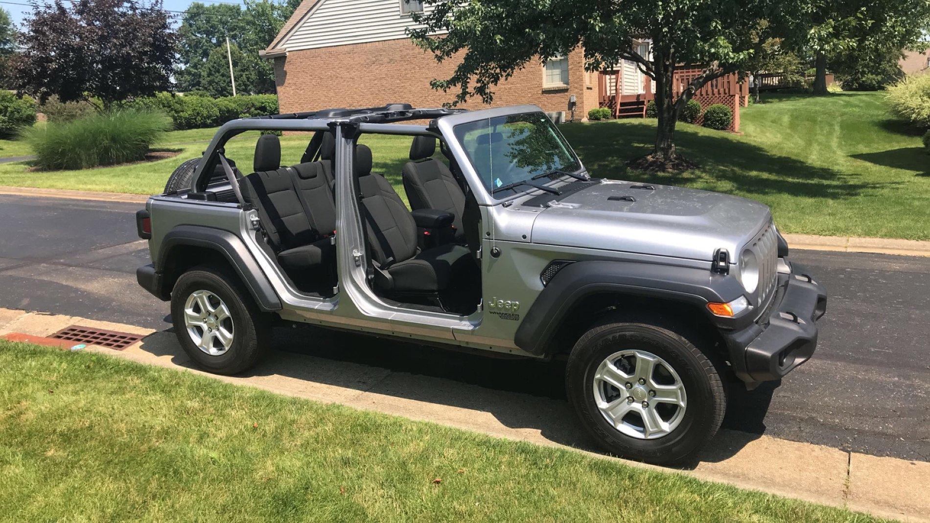

Of course immediately I had to get the top and doors off. Last time I was in a jeep topless and doorless was in my dads when I was a little kid.

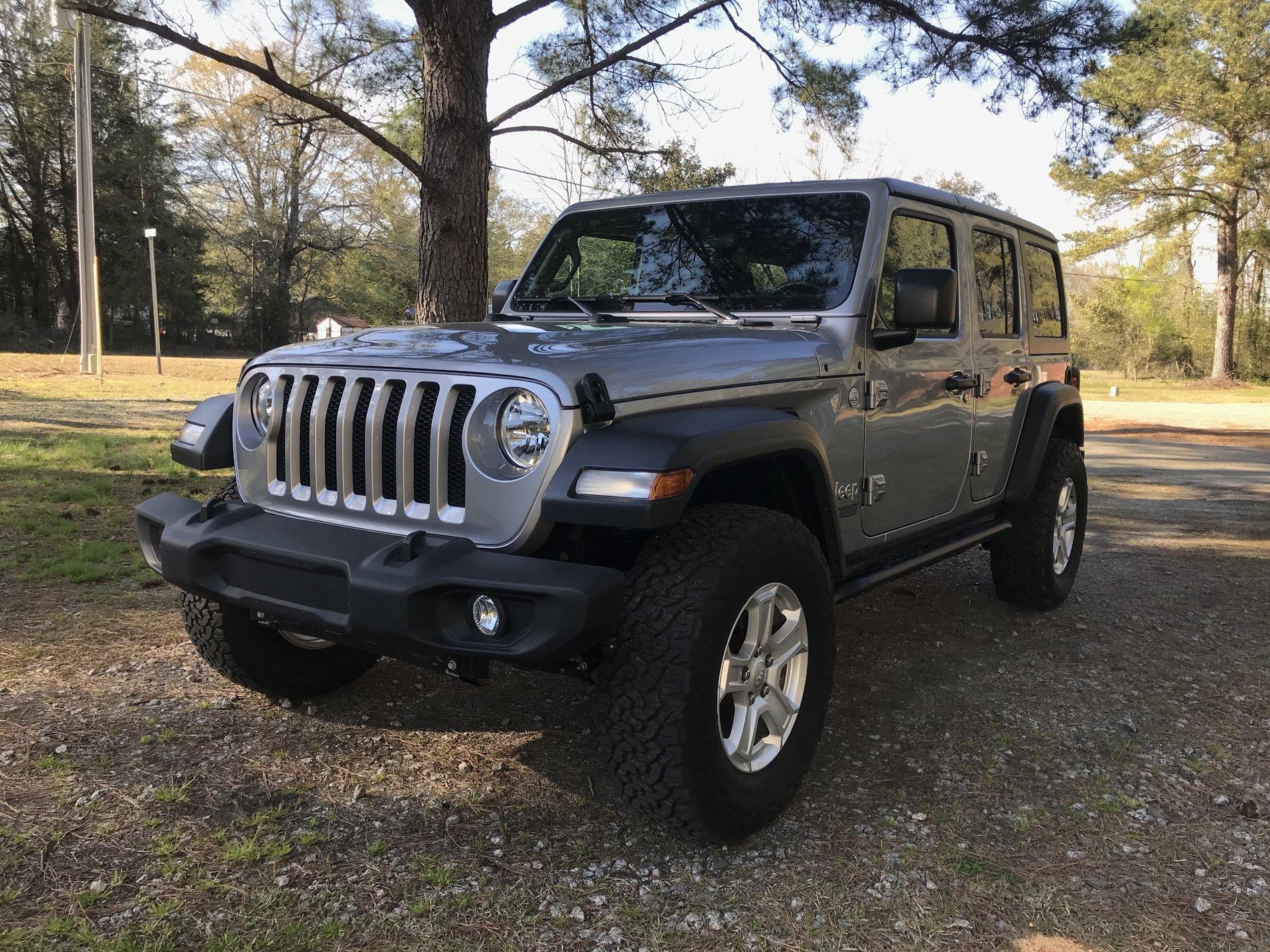

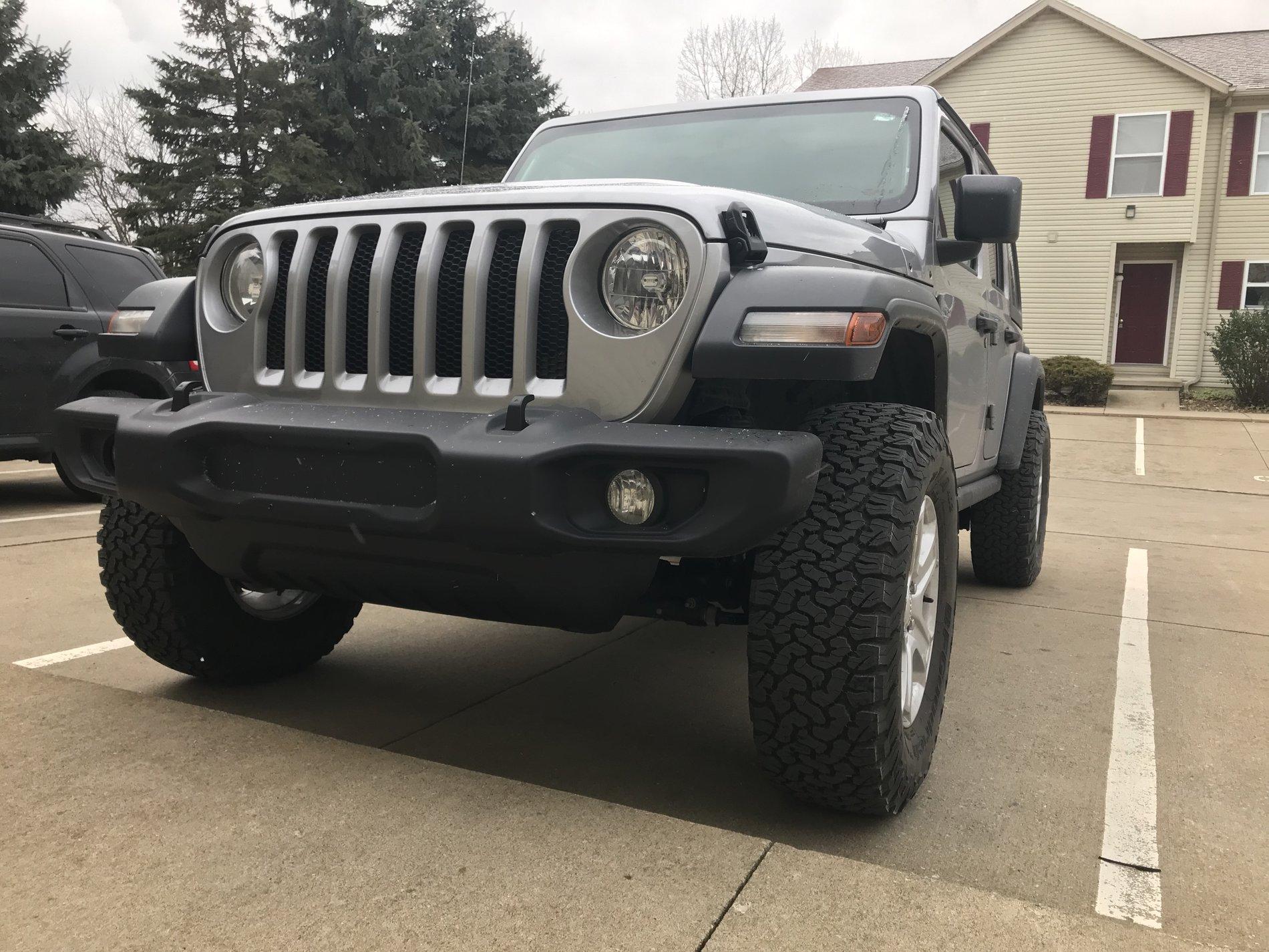

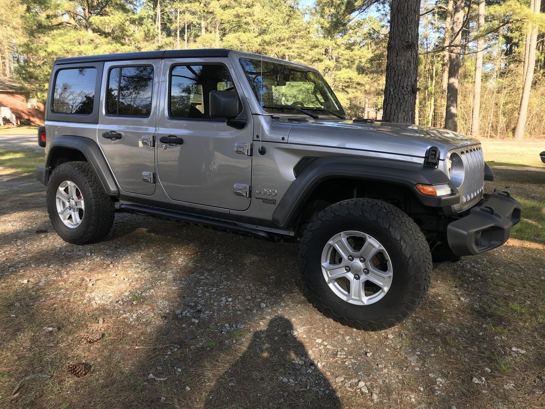

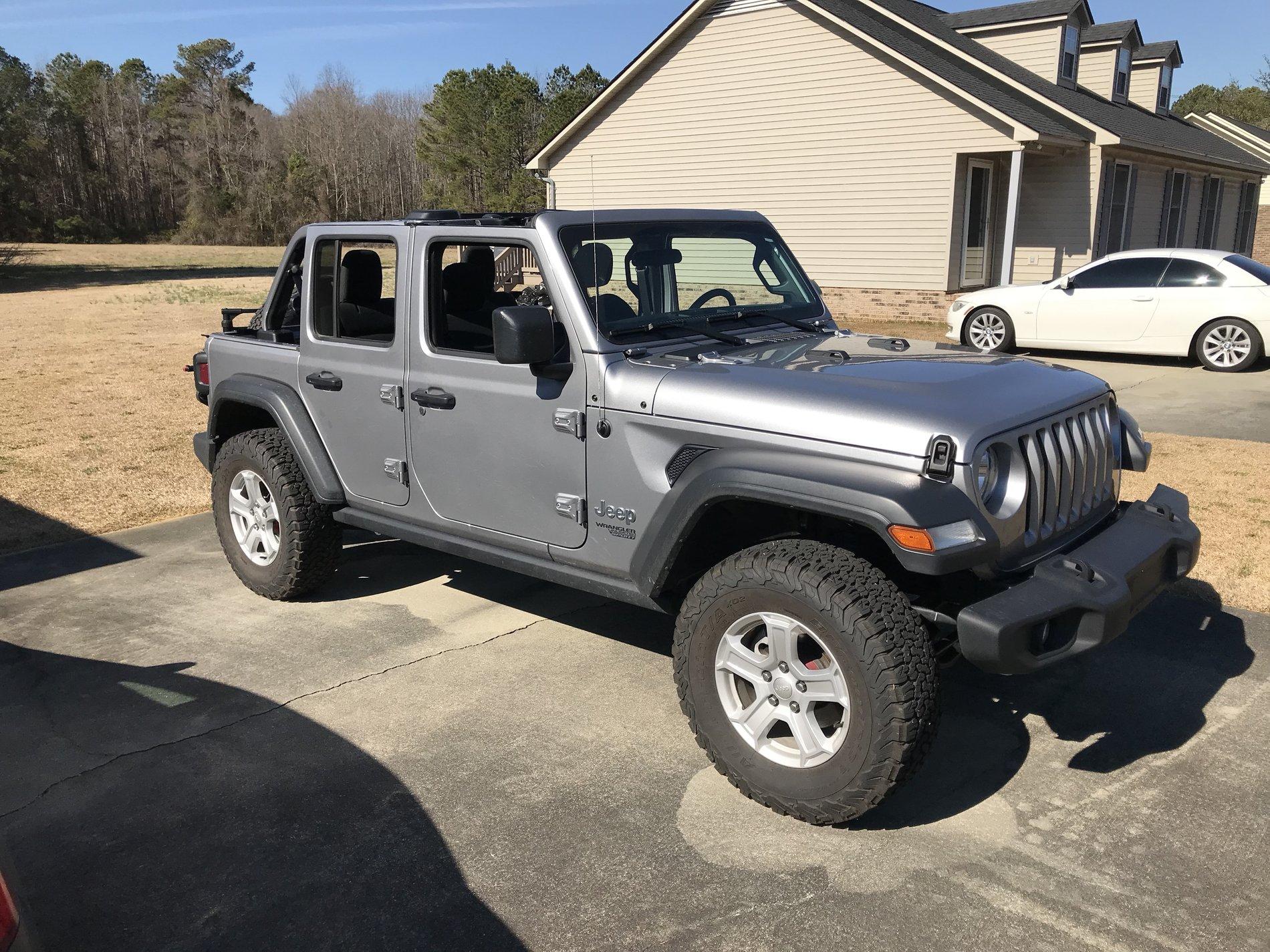

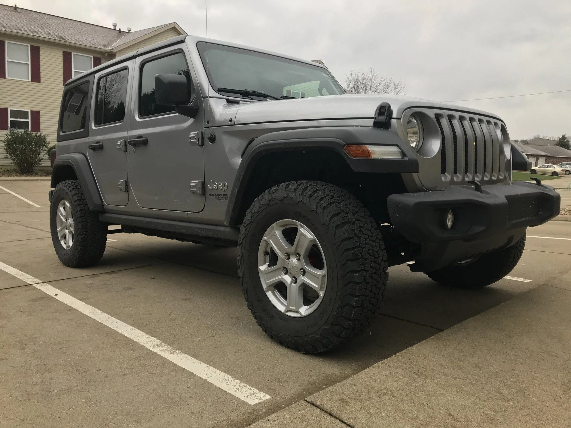

First thing was to put on the 285/70/17 ko2's. At the time I thought this was a great idea but doing it over I would skip them and go to 35's. I also removed the aerodynamic piece on the bumper somewhere along the way.
I thought that this size tire would be fine leaving the suspension stock but honestly I think the tires looked a stuffed in the wheel wells and then I wanted it lifted up a little bit more.
That lead to rubicon takeoff springs and shocks as well as the rubicon rails.
Along with this went the synergy 1 5/8 wheel spacers. I thought since I was going up might as well go a little wider.
With the rubicon rails on I felt good enough to go offroad so I wouldn't smash the pinch seam.

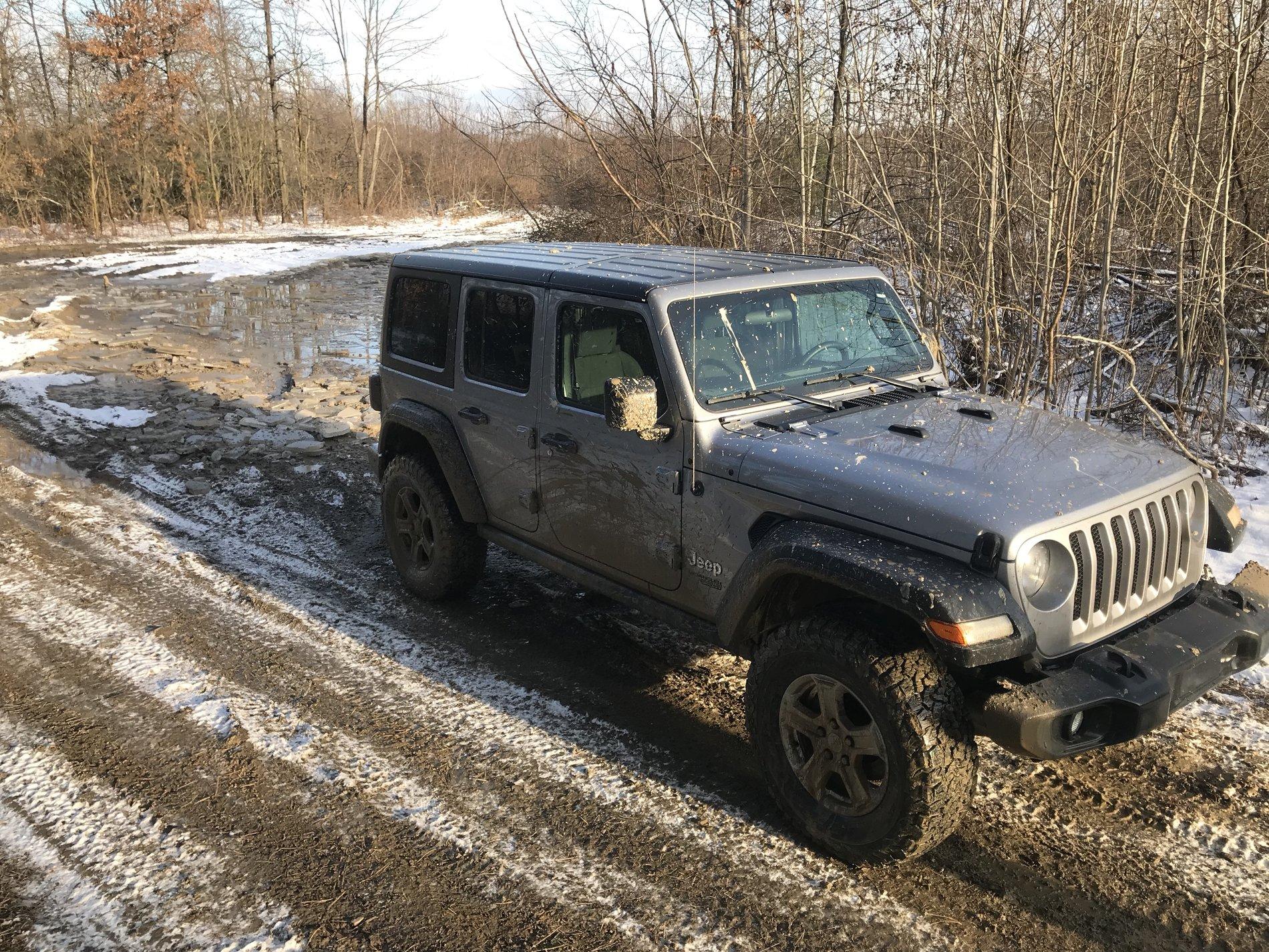

I still had the sway bar connected and left the tires at 36psi. With this setup the rear tires just barely rubbed the rear fender. Nothing that would cause damage. Looking back at this I'll disconnect the sway bar every time I'm out I didn't need to be leaning this far and I'd prefer to let the front suspension work without the sway bar holding it up.

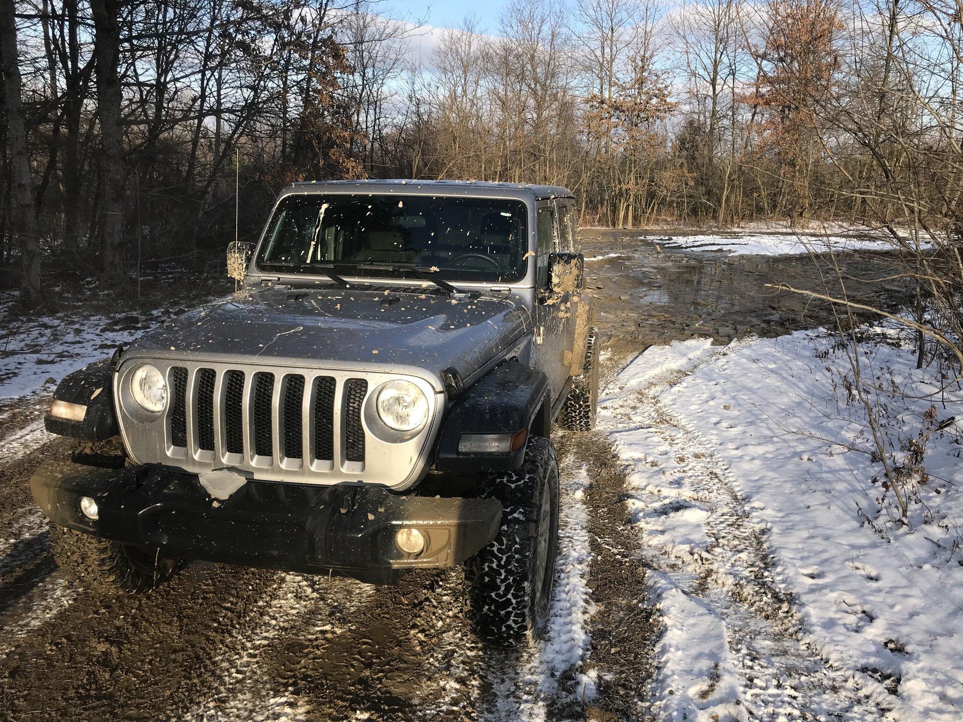

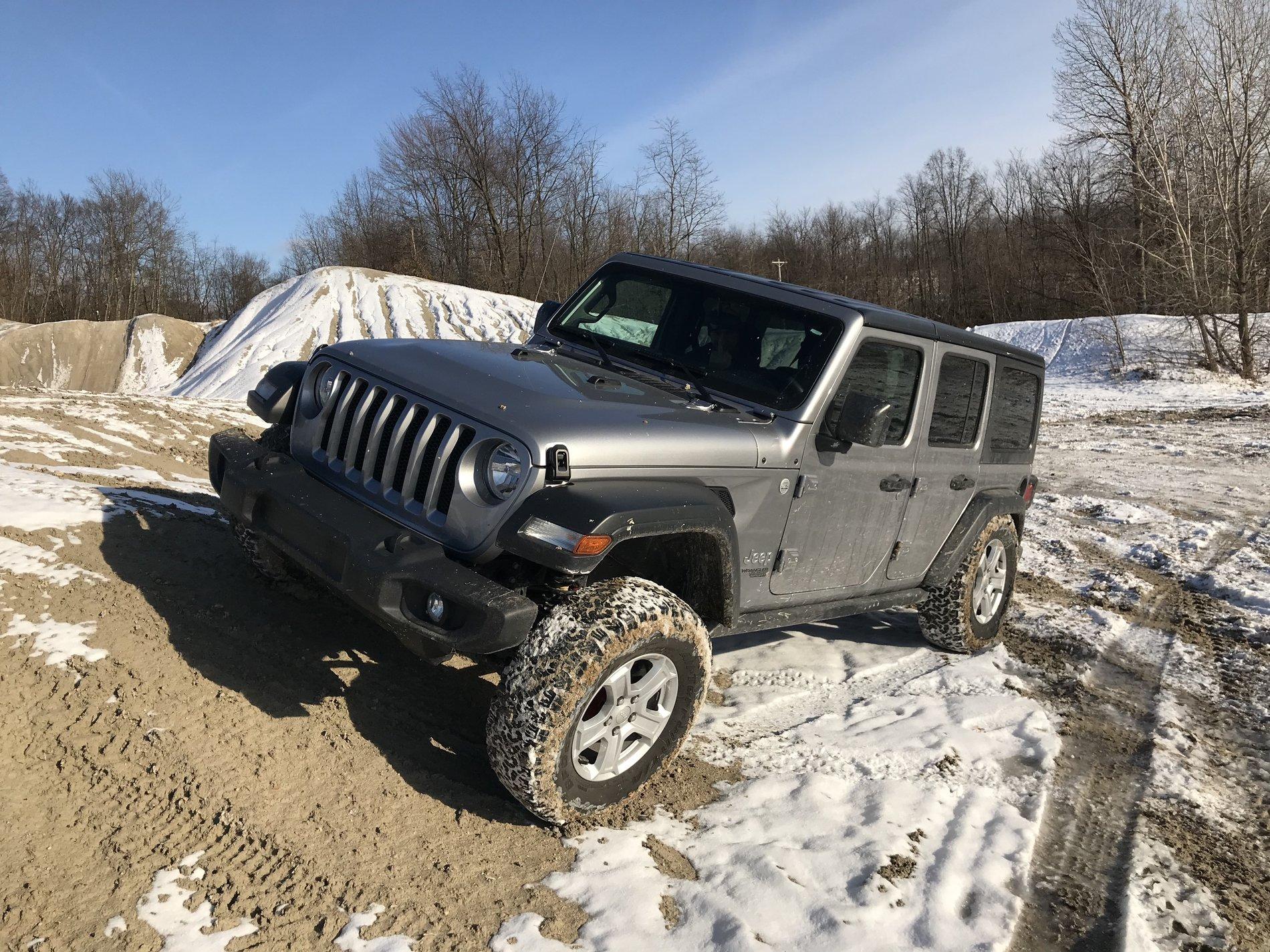

I wasn't intending on getting muddy but the jeep fell through the ice and right into the mud. I tested the water fording first time out unintentionally.

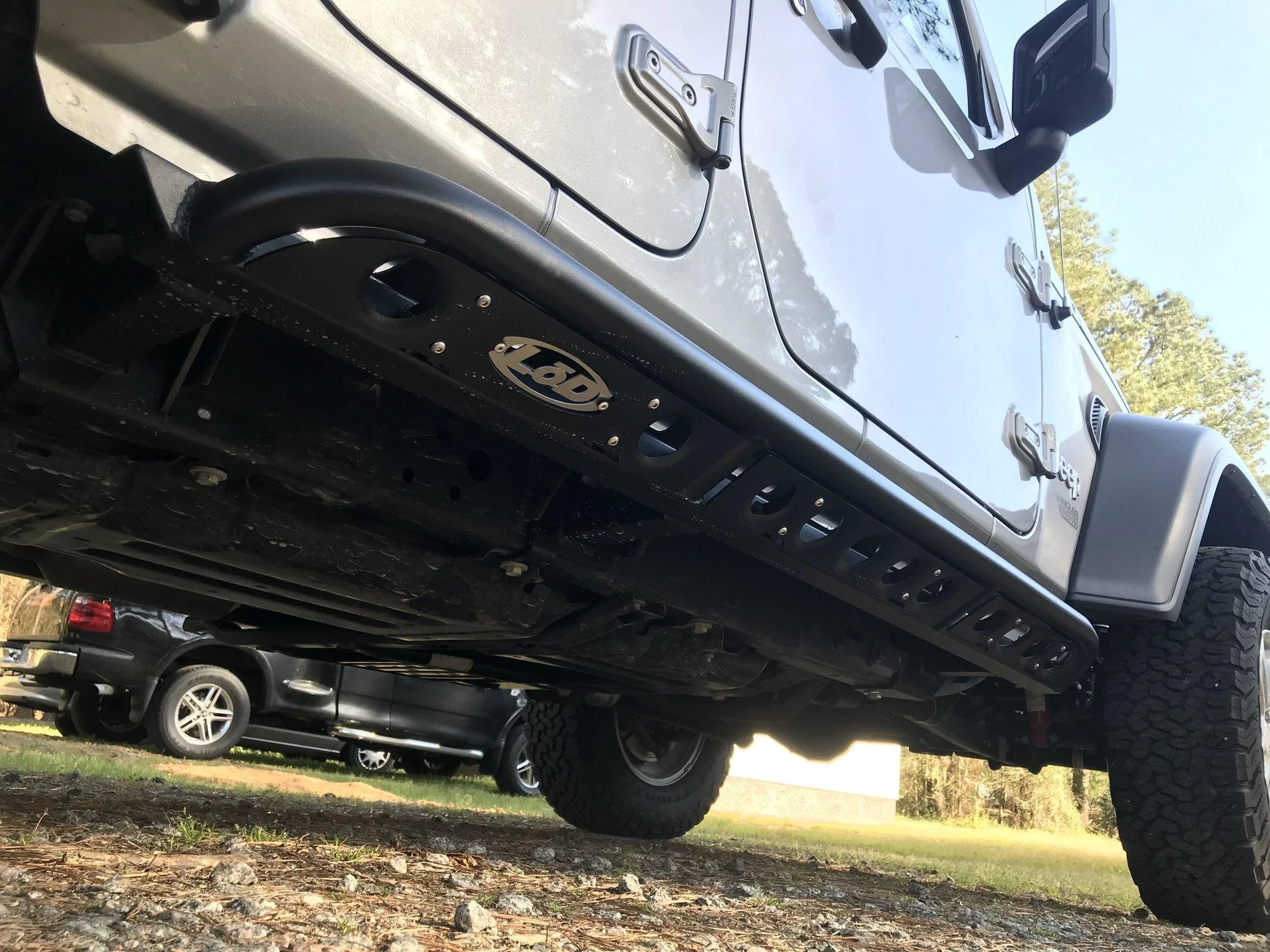

Next thing was replacing the rubicon rails with some LoD signature series rock sliders. I wanted a little more protection and plus the little thing they call a step on top will help my case for a lift and tires when I tell the girlfriend it has a step for her.

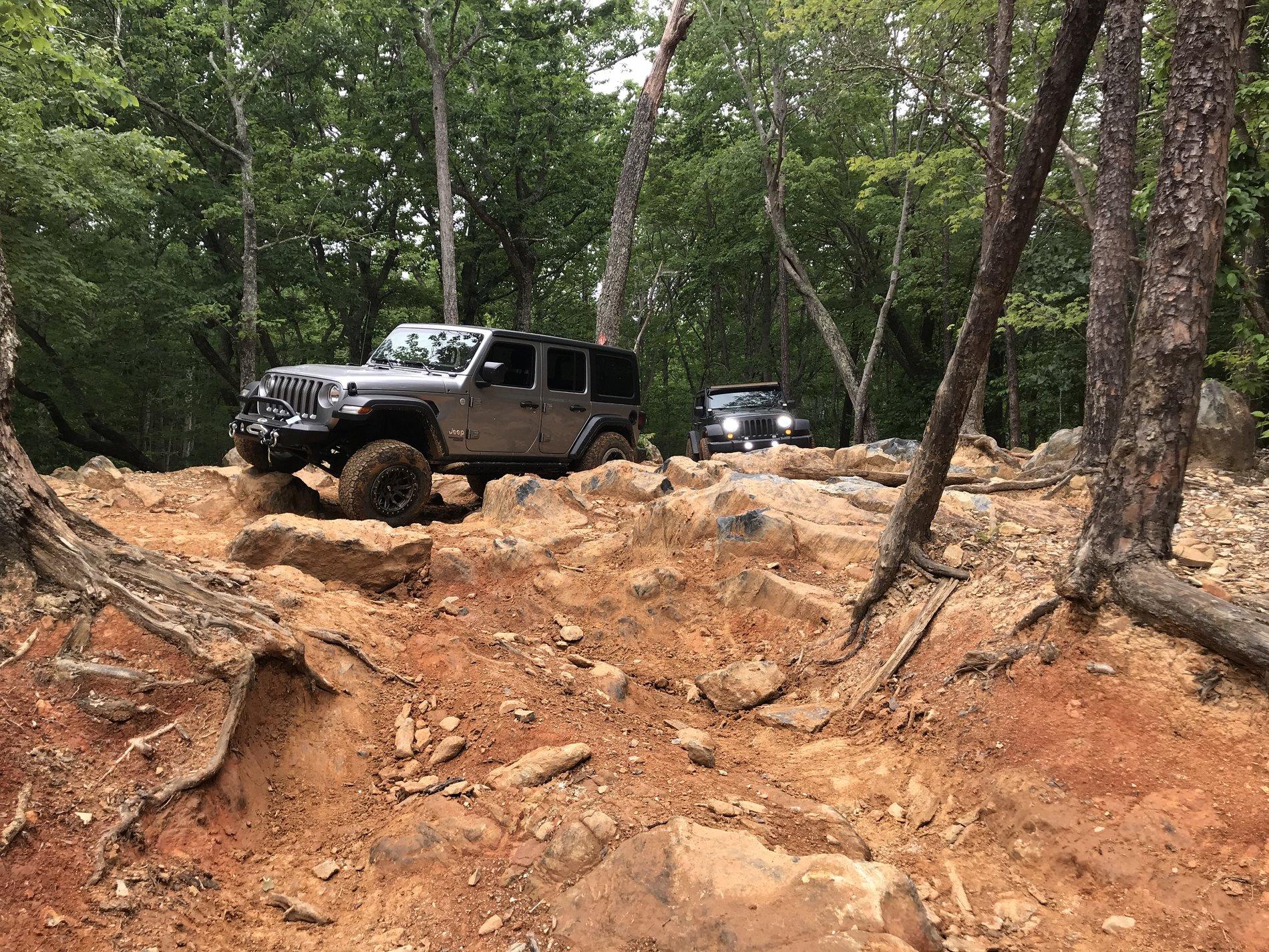

I met some people at work and we ended up planning a weekend trip to Uwharrie OHV park an hour north in North Carolina. This place is a blast and I would recommend going if it's a reasonable drive for you. I went with a Toyota 4Runner lifted 3 inches with 285/70/17 ridge grapplers and a 2010 bone stock jku on highway tires. Luckily the 4Runner had a warn winch and I had a tow strap and D rings so we figured we would be alright and we wouldn't be on any trails to hard anyways.
Since I was going on this trip I finally made some big purchases I've wanted to do forever and I ordered the Dirty Life DT-1 9303 wheels in 17x9 -12 offset in the matte gunmetal color. Along with this I wanted a stubby bumper so I wouldn't tear up the factory plastic bumper and have better angles to get on rocks which would help a lot with the size of my jeep. Of course the wheels were back ordered and the bumper took to long to make so I had to go on my trip with the jeep as is.

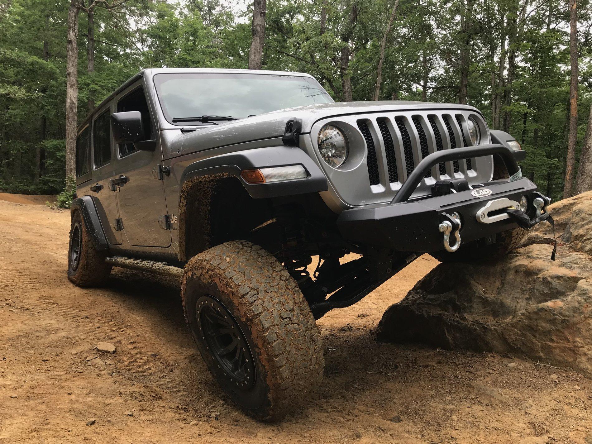

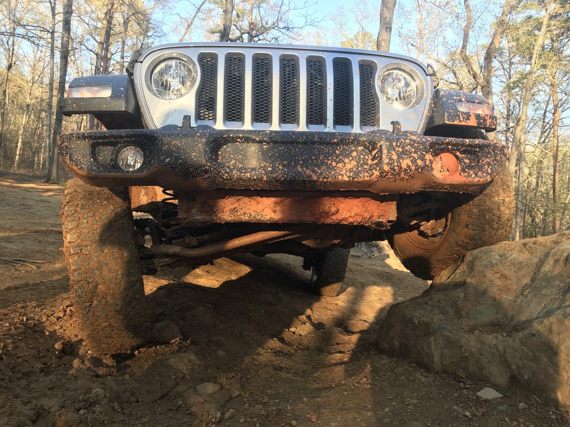

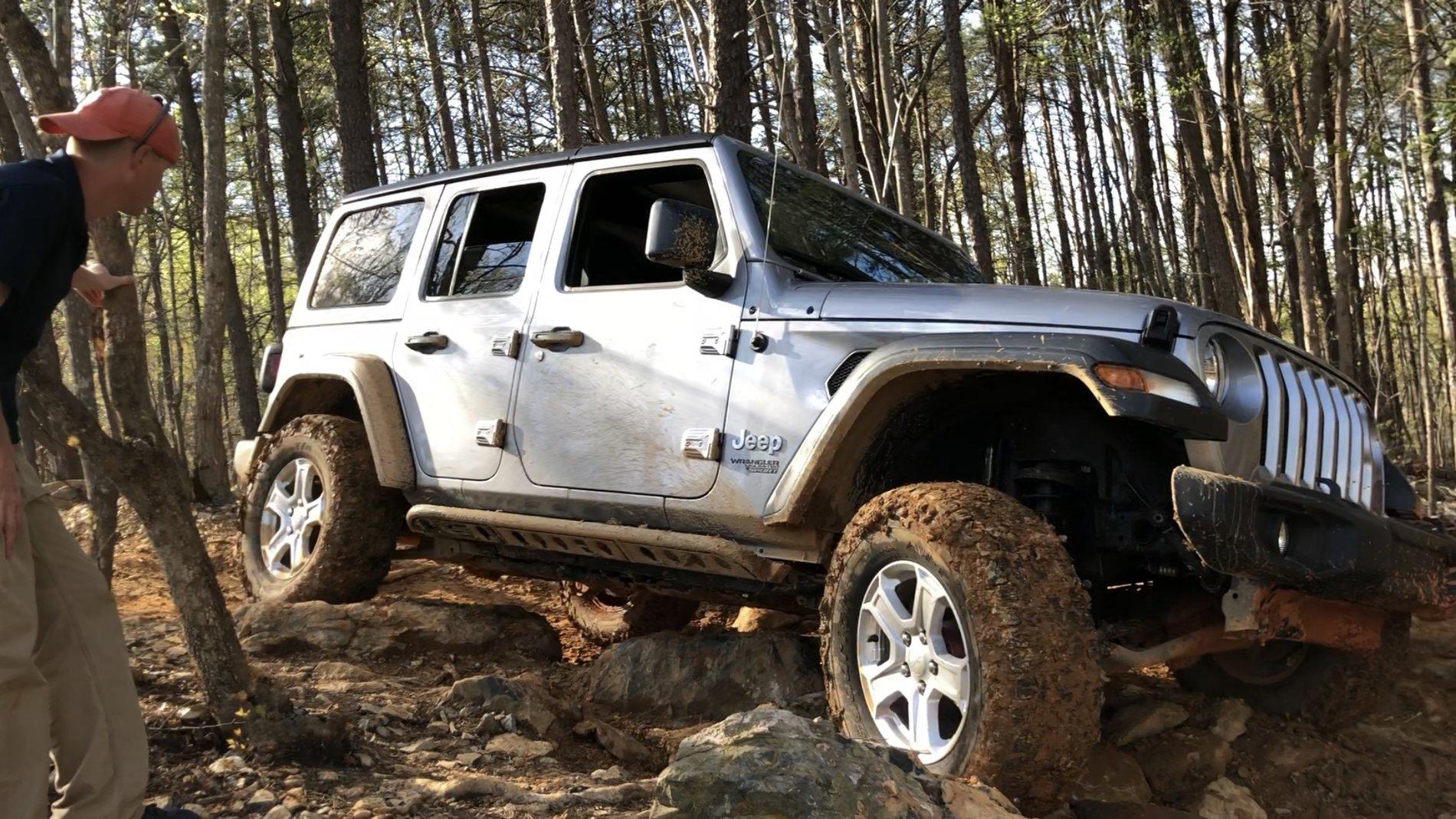

It was blast getting on the rocks and after watching every Lite Brite and [Banned Site] youtube video's for months I wasn't even phased scraping the sliders and skid plates across the rocks. This trip I disconnected the front sway bar and dropped the tires to 20psi.
We were all new to this and I think this guy spotting me thought I should stay off the rocks. Looking back at this I think maybe if my front right wheel was on the rock to the right I wouldn't have dropped the frame and sliders on the rocks as much going across this. It was a learning experience and we know what to do next time and no damage was done.

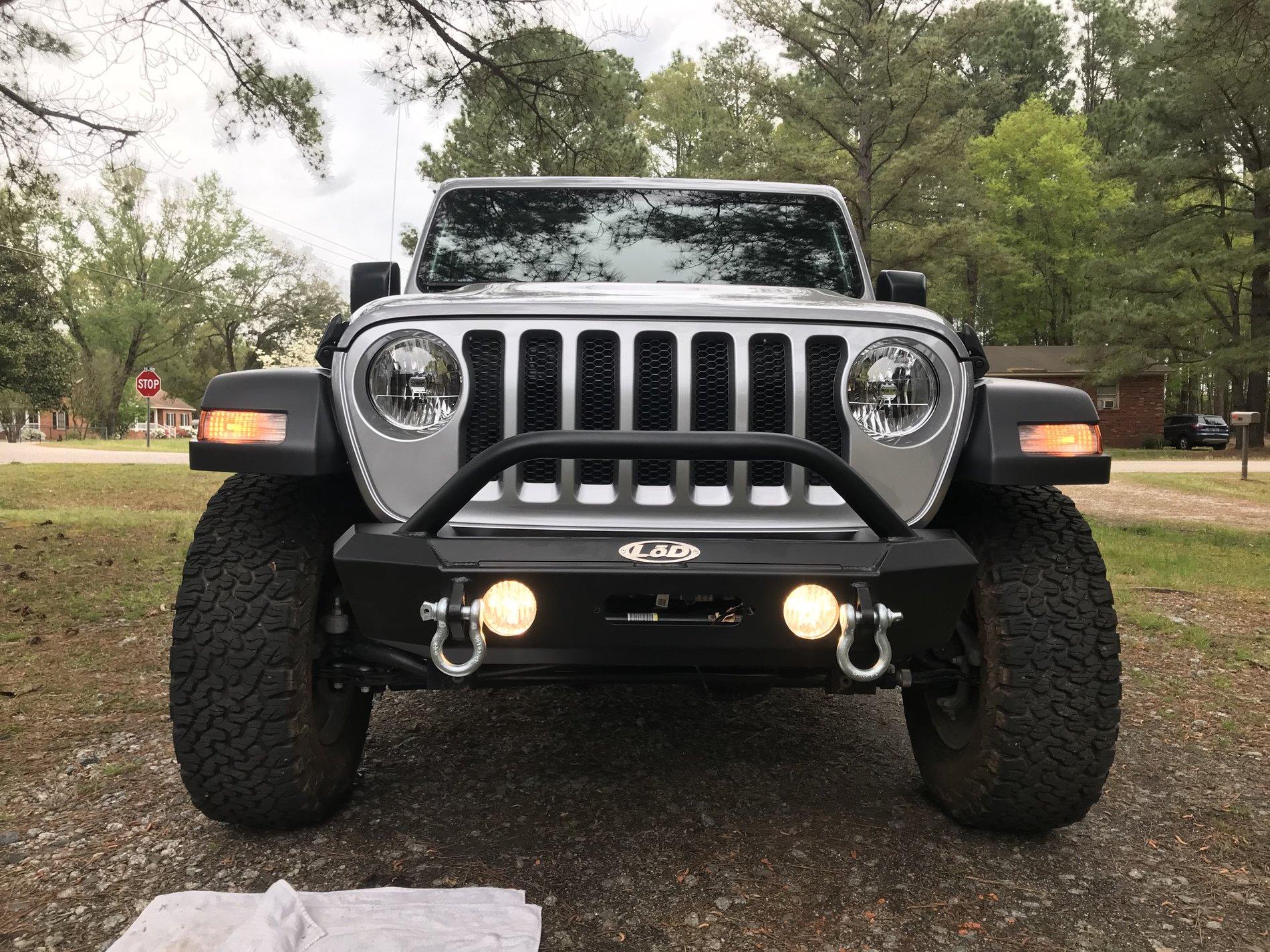

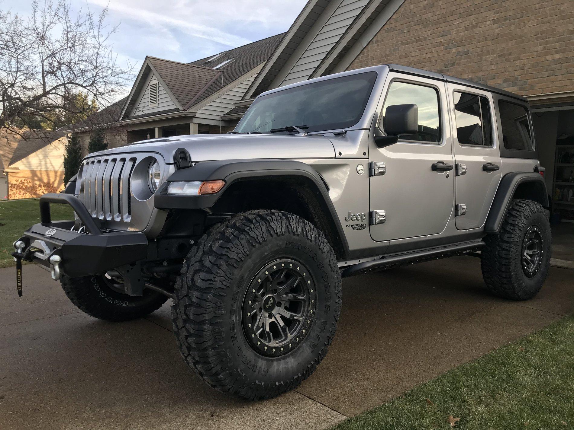

That trip was on a Saturday and two days later on Monday the bumper showed up. I ordered an LoD signature series shorty bumper with bull bar. I actually liked the looks of the destroyer bumper better but I liked that the winch was integrated with this one and that was more important to me. This is what I will consider as the beginning of "phase 2".
This bumper was easy to install for the most part. The fog lights were tricky but if you know someone with small fingers they could get the bolts in with ease. I actually got them in fairy fast considering I was racing the rain.
Following this, the wheels came in on Wednesday.
I am really happy with the way the jeep looks and everything is a functional mod. The wheels have the normal ring installed now but if I tear them up too bad I can switch the wheels over to the beadlock ring. I really want to get some better pictures with the jeep cleaned up and in the sunlight. This is the current state of the jeep. I have ordered a smittybilt x20 10k winch with synthetic line that I am waiting on.

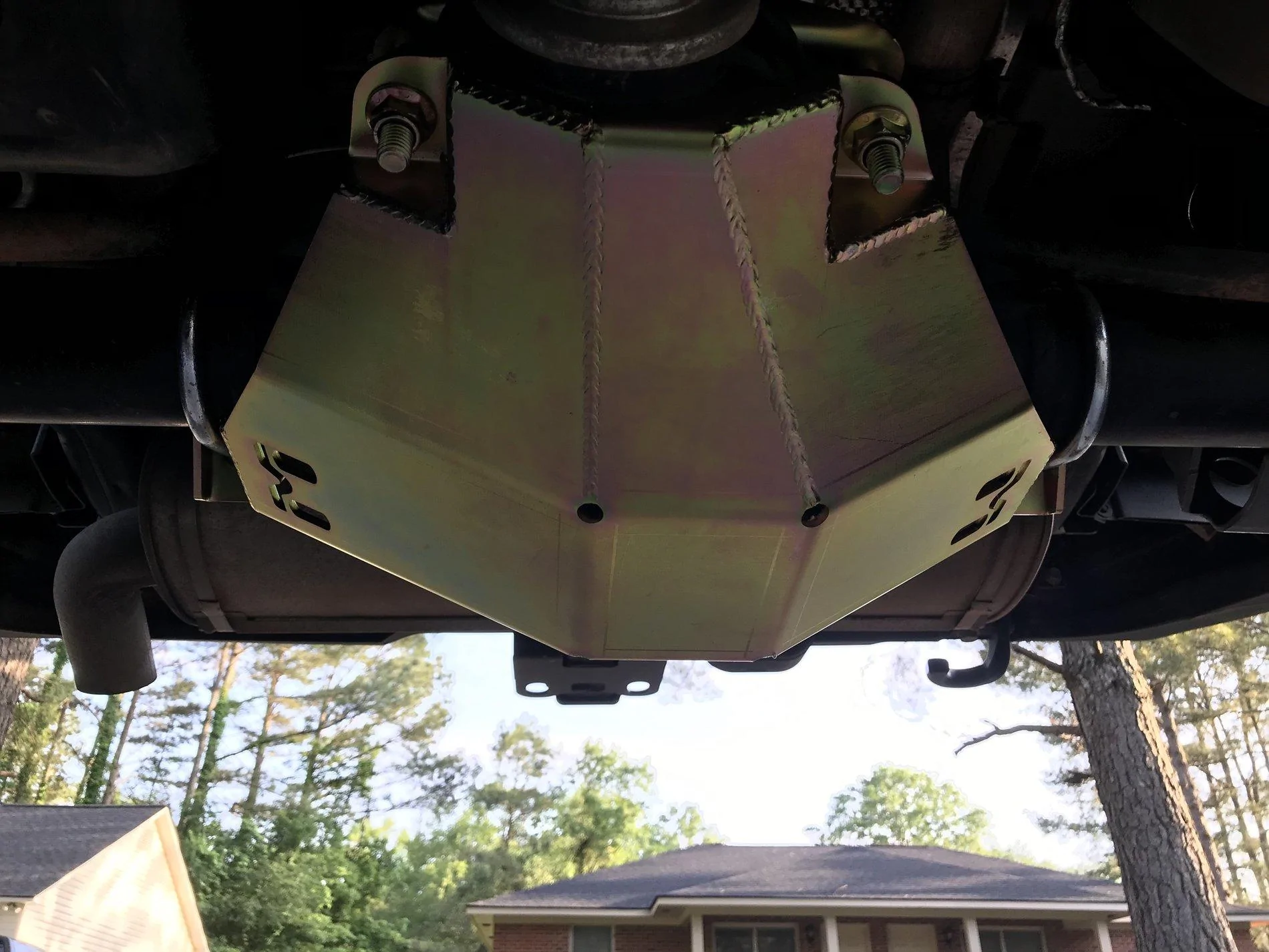

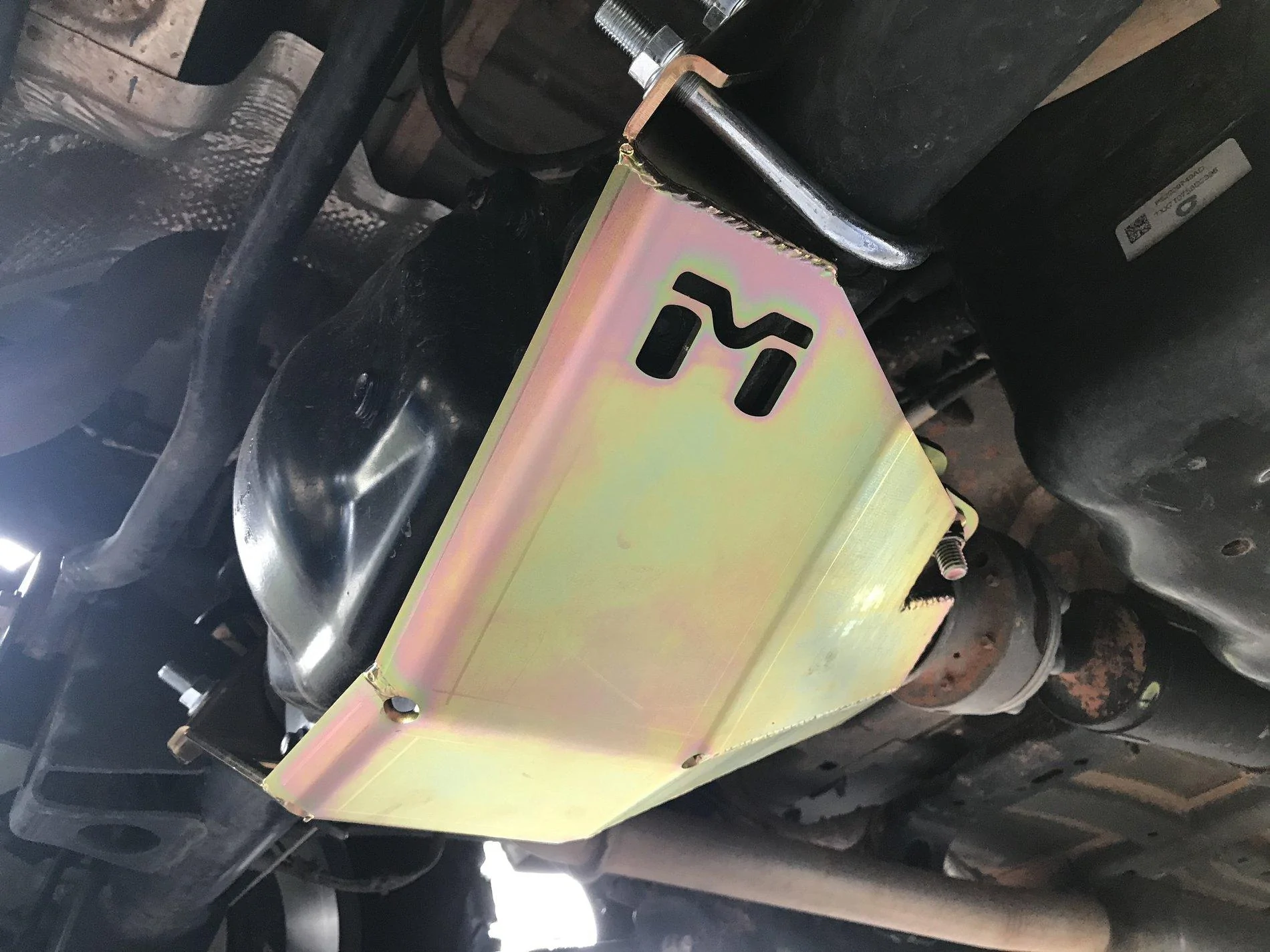

Added a @Metalcloak diff skid just in time for some wheeling tomorrow.
Install was easy, it may not have even taken 10 minutes.

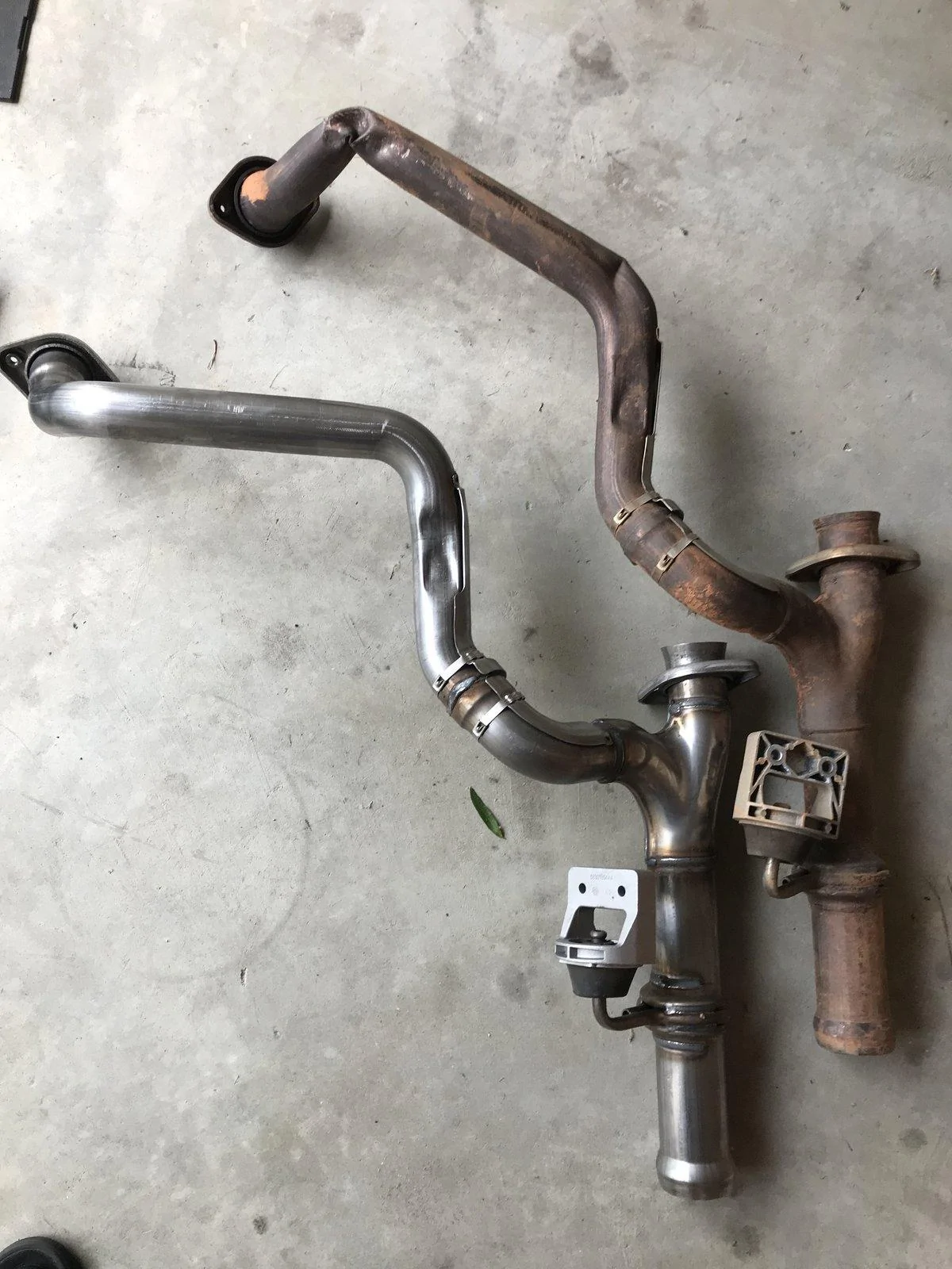

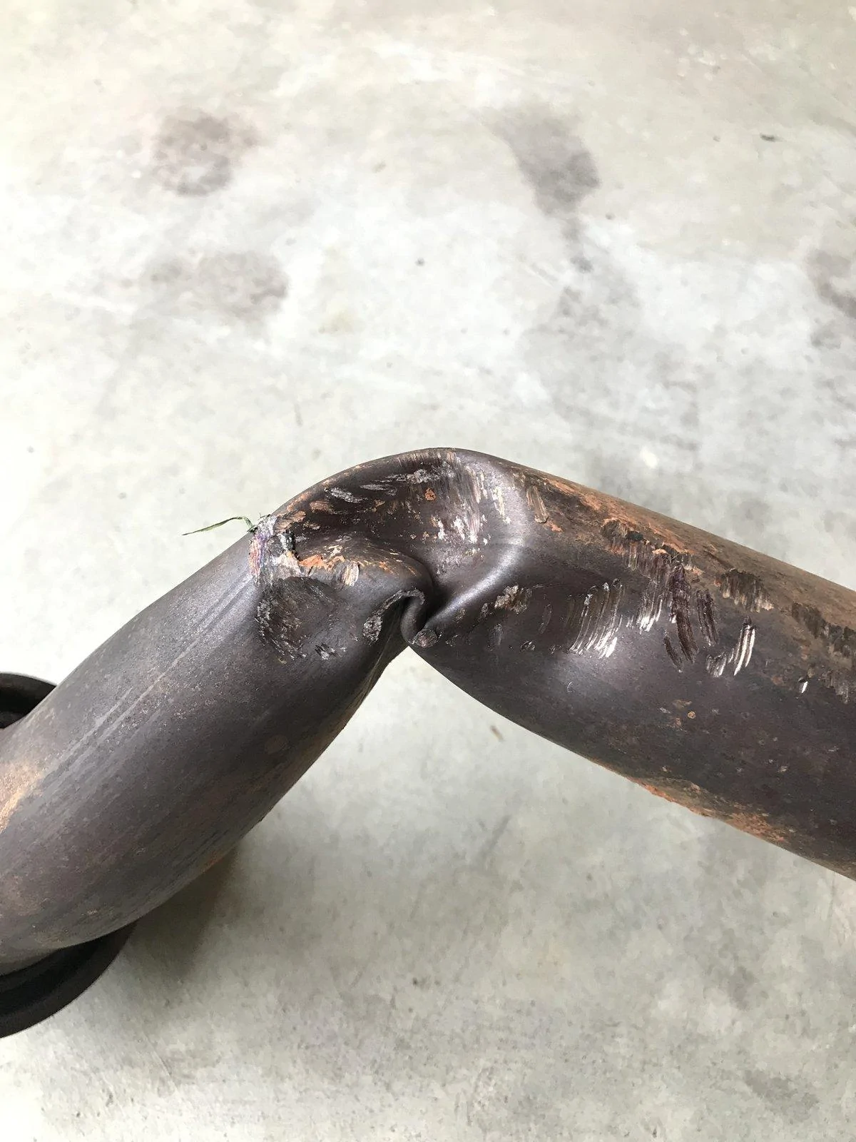

Another weekend at Uwharrie. Managed to mangle the y pipe Iā€™ll have a picture of the new and old when it comes in the mail.

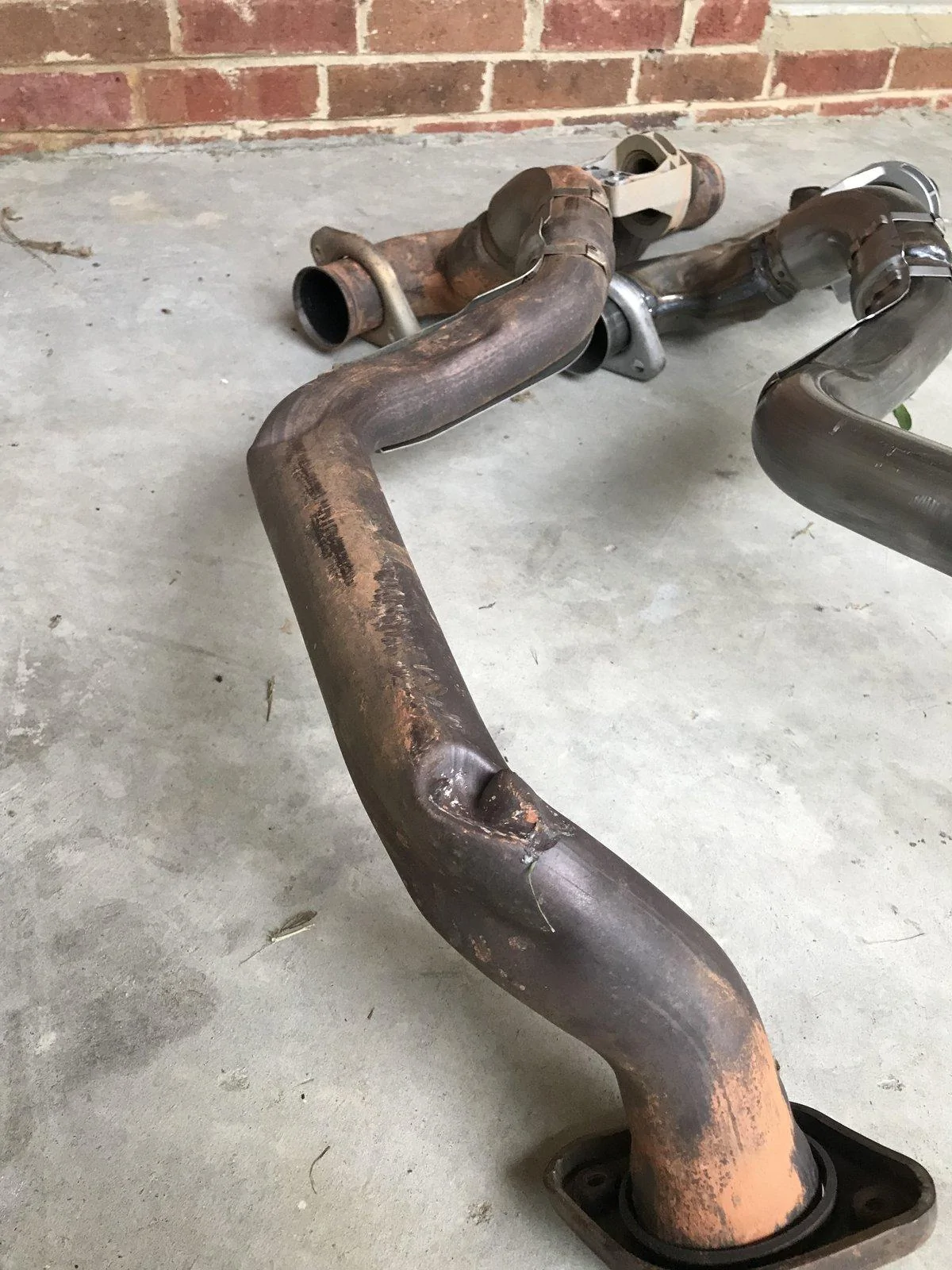

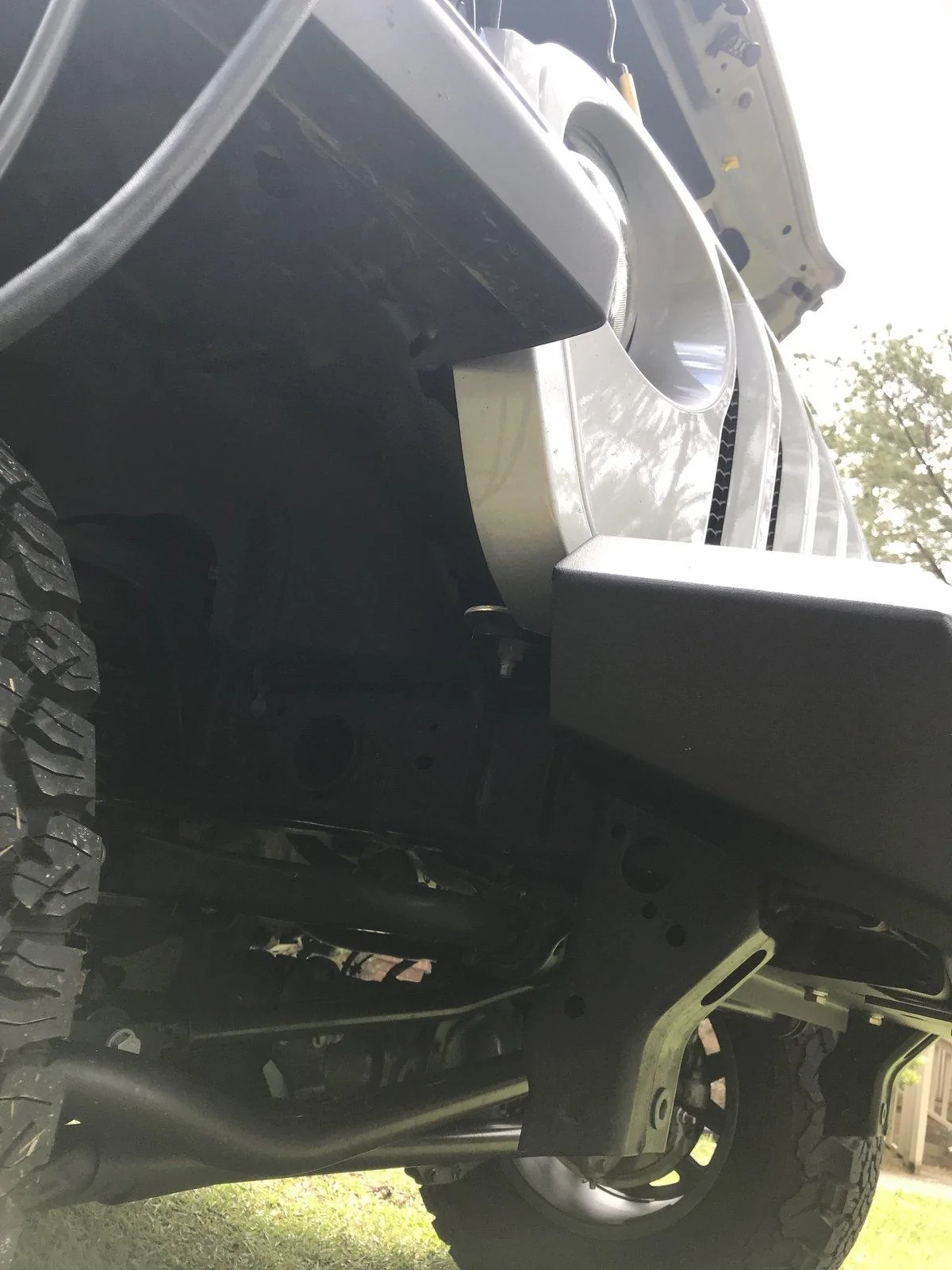

As for some trail damage after last trip I went to swap out the crushed Y pipe and while installing the new one I thought I had received the wrong part since the right side wasnā€™t even close to lining up. Next I looked at the catalytic converter and noticed that pipe was smashed as well. I pretty much destroyed the connection of the two pipes in that area so I had to order a catalytic converter as well and Iā€™m waiting on that.
As you can see the original isnā€™t even close to where itā€™s supposed to be.
What really surprised me was then I went to remove the original Y pipe the flange bolts were finger loose I didnā€™t even need a wrench.

Got back from vacation and swapped the new cat and y pipe on and the Jeep is so much smoother now. I knew the kink and bends made it a little bogged down but it feels nice like stick again.
The pipe coming off the catalytic converter should be pretty close to straight.
The only reason the pipe didnā€™t buckle more was because it was resting on the transmission. This is a good excuse for a lift and bigger tires :clap:
