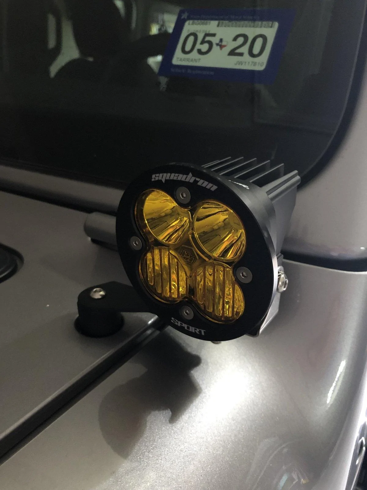

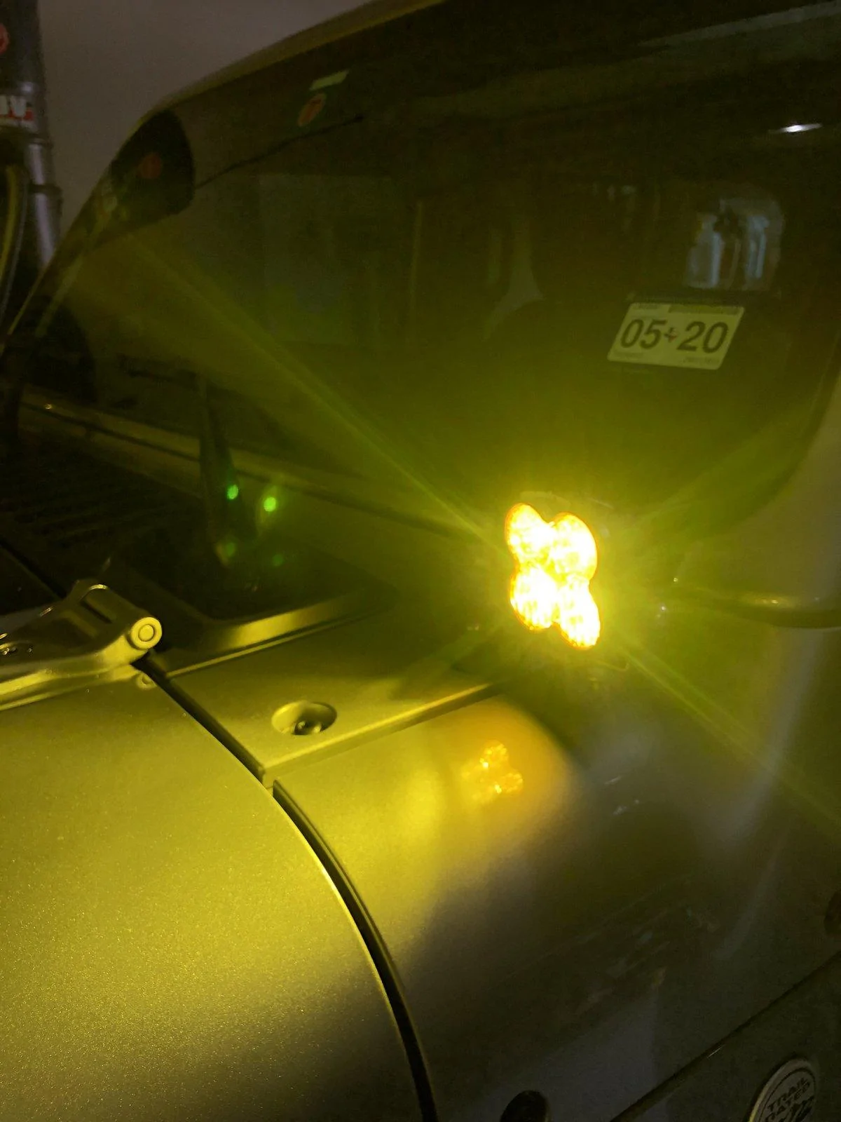

Nice those look great! Are those the spot or flood? I was thinking pods in that location with a light bar mounted on the bumper. I was looking at the squadron lights like yours or the rigid D-SS. Also how do you like the color vs. a color a clear lens would give off?

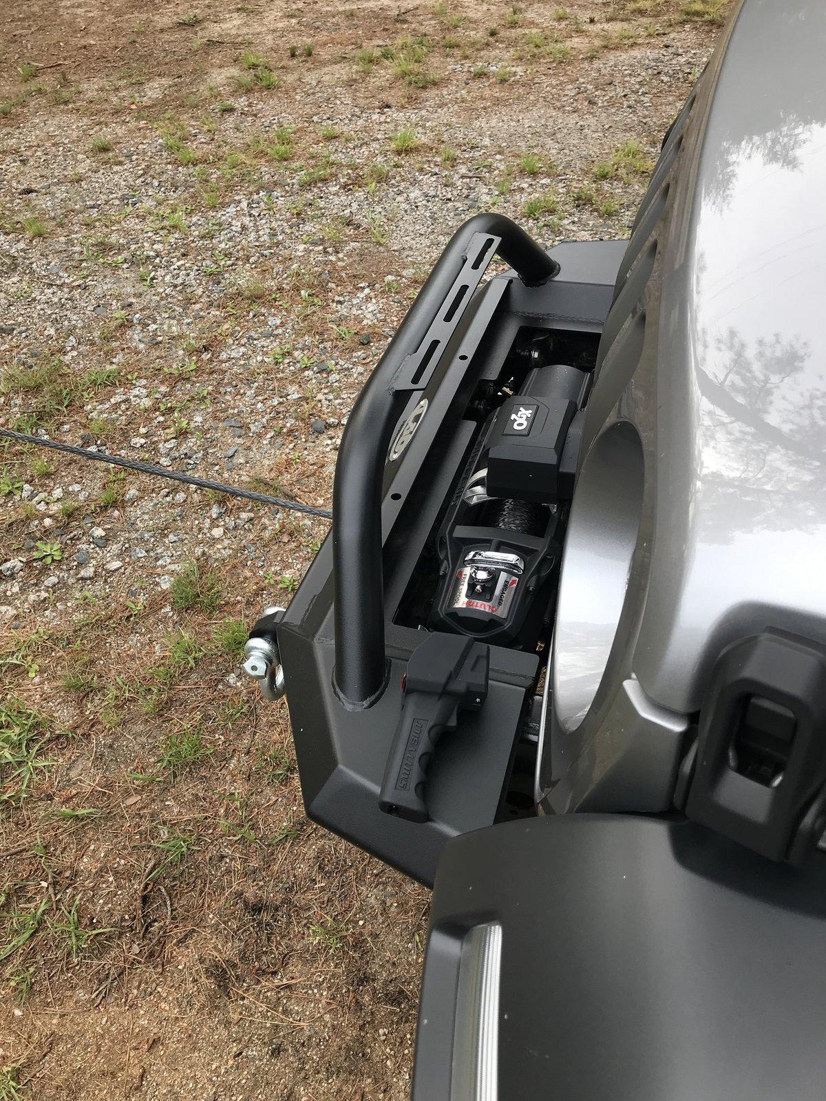

I pretensioned the synthetic winch line today. I simply used a tree on the side of the housing my company has me living in at the moment.
I used the bulldog winch tree saver from northridge. I'd recommend it to anyone that needs one. Mine was a little different that what the picture shows, It actually comes with some pads on it and an elastic loop to hold it all together when it is rolled up.
I pulled the jeep in till this far then wound the rest in under hand tension.

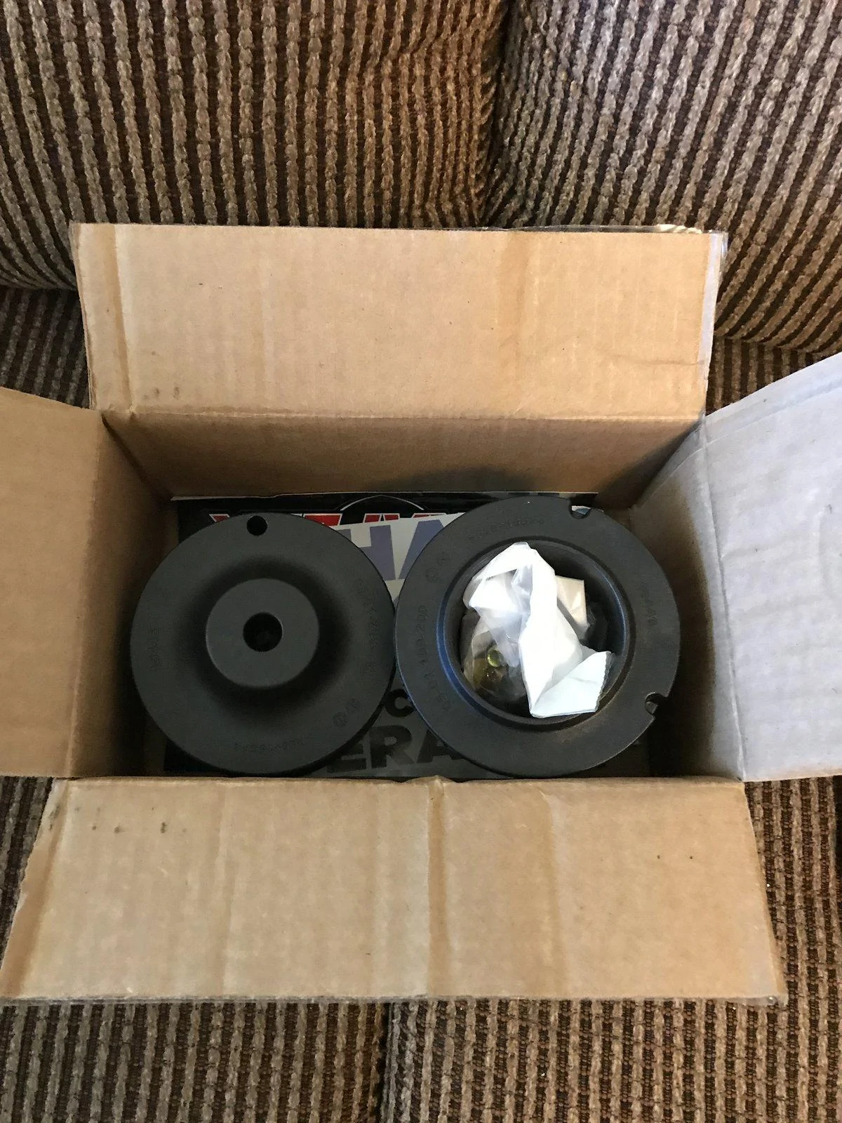

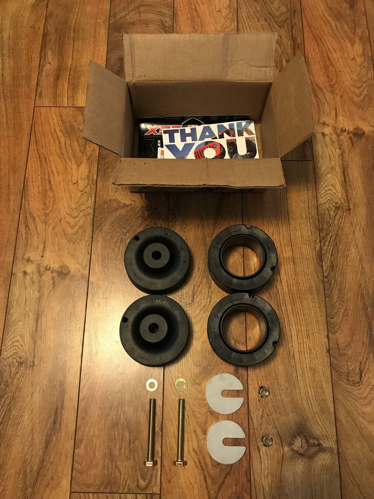

The Teraflex spacers showed up today
I can’t wait till the weekend so I’m going to see if my friend can let install these tomorrow.

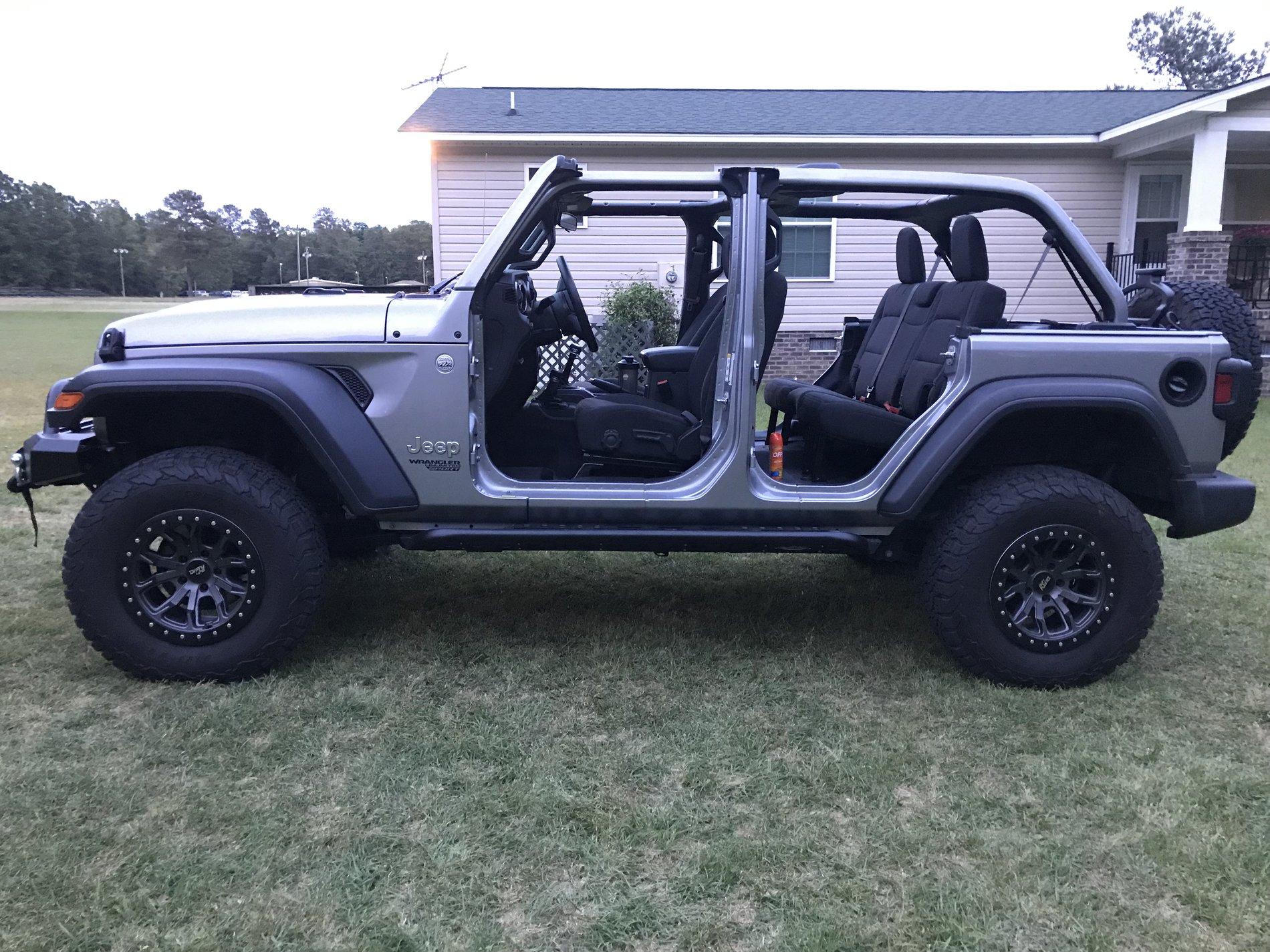

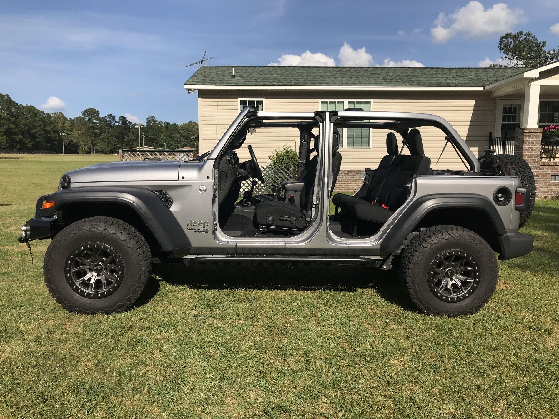

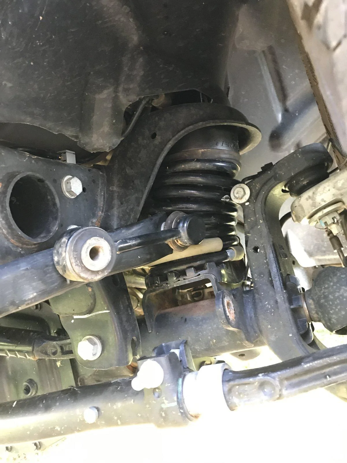

I installed the TeraFlex 1.5” spacer lift yesterday. I would’ve taken install pictures but we did this in the side yard and used 3/8 drive tools and an adjustable wrench to do this. I thought my friend had a shop to get this done and I probably have more tools on the trail but it’s ok we still finished the job.
Before
After
We were also on a slight incline I’ll have to take better pictures. To the guys that wanted install help, TeraFlex has a video where they do the full install of this lift as well as having very detailed instructions packaged. If you’re thinking about installing it on your 2 door still I’d say go for it, once you get going you’ll see it isn’t very difficult. Since I had limited tools and jack stands I just did one spacer at a time.

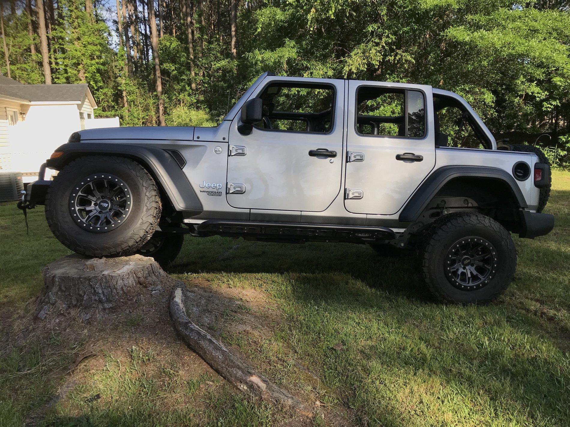

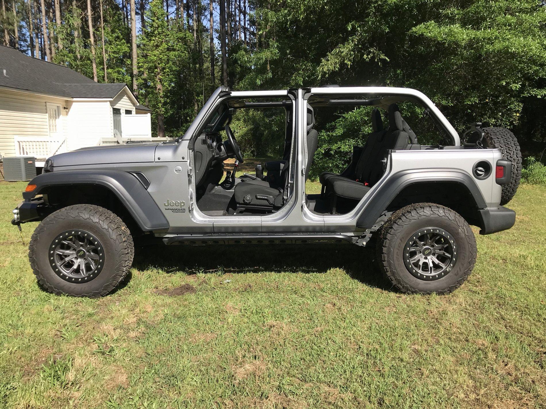

Here is a better picture on decently flat ground.
Of course with a suspension change I wanted to do a flex test.
With the front sway bar connected I could not get onto the stump, the front right and left rear tires were spinning. BLD tried to help and probably would've but I knew I was going to disconnect the sway bar anyways so I backed off before I pushed it to hard. With the sway bar disconnected it crawled right up the stump like nothing.
I would like to believe the jounce was firmly into the bump stop but it is hard to see through the coil.

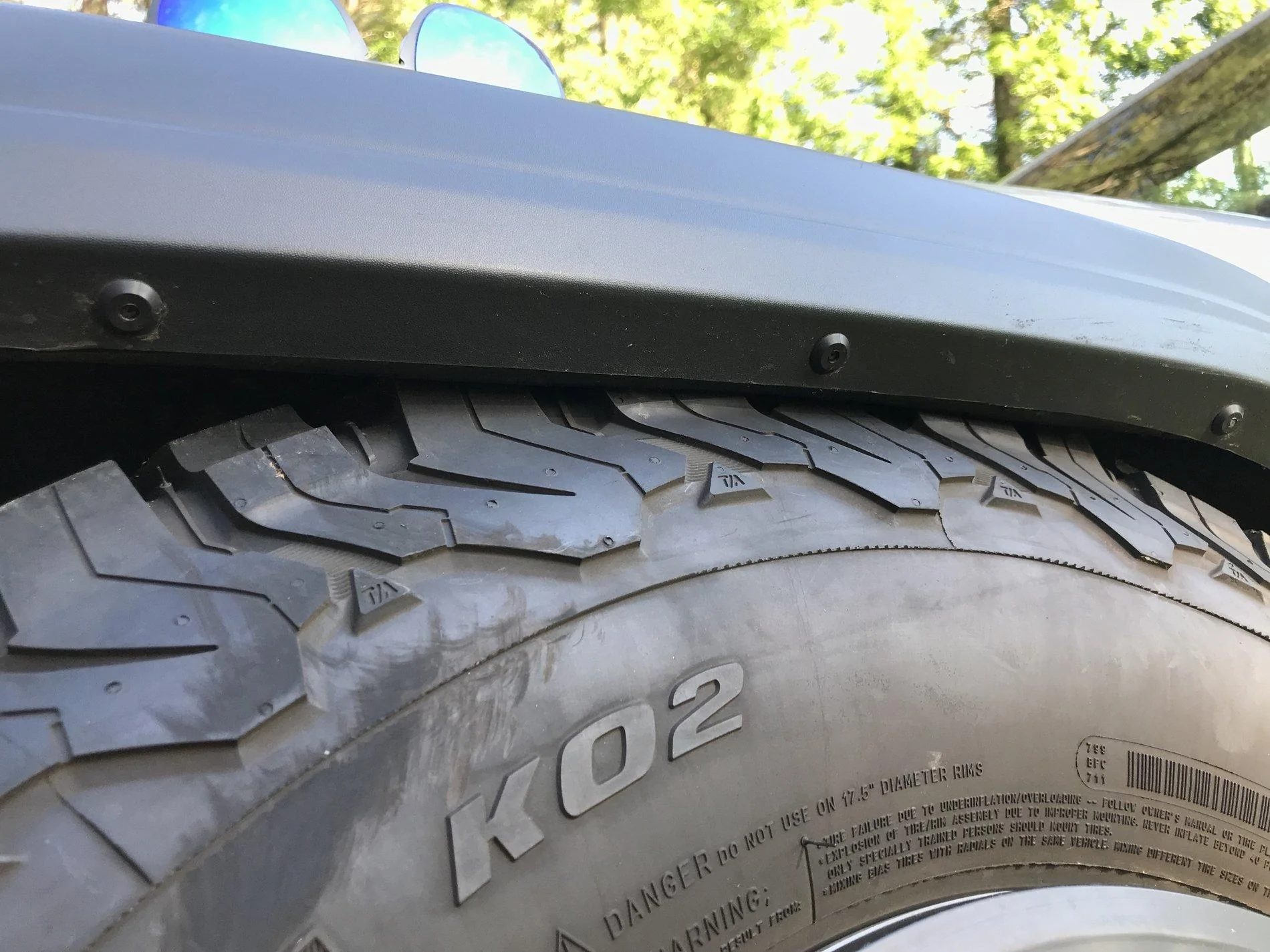

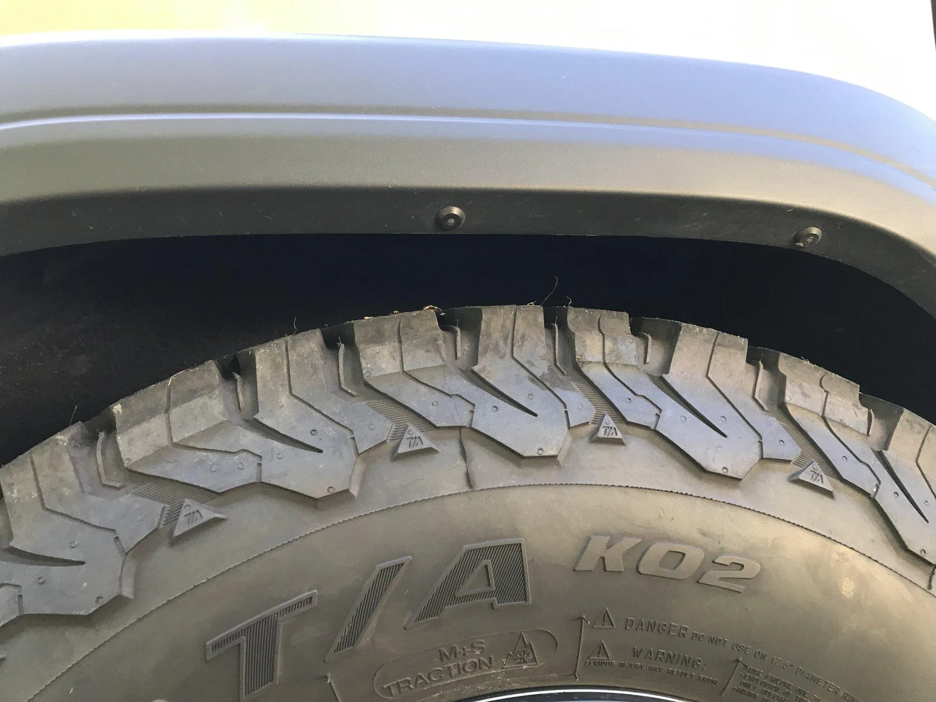

The front tire is just barely touching the fender liner, this may be an issue while turned but straight on I don't think this will be a problem.
The rear tire still had plenty of travel into the fender as well as on the bump stop. I needed something taller to get a full test but that probably won't happen till I get back to Uwharrie. I am planning to do a trip there next weekend.
Overall I am pretty happy with the Jeep right now. Going to add a few more extras soon.

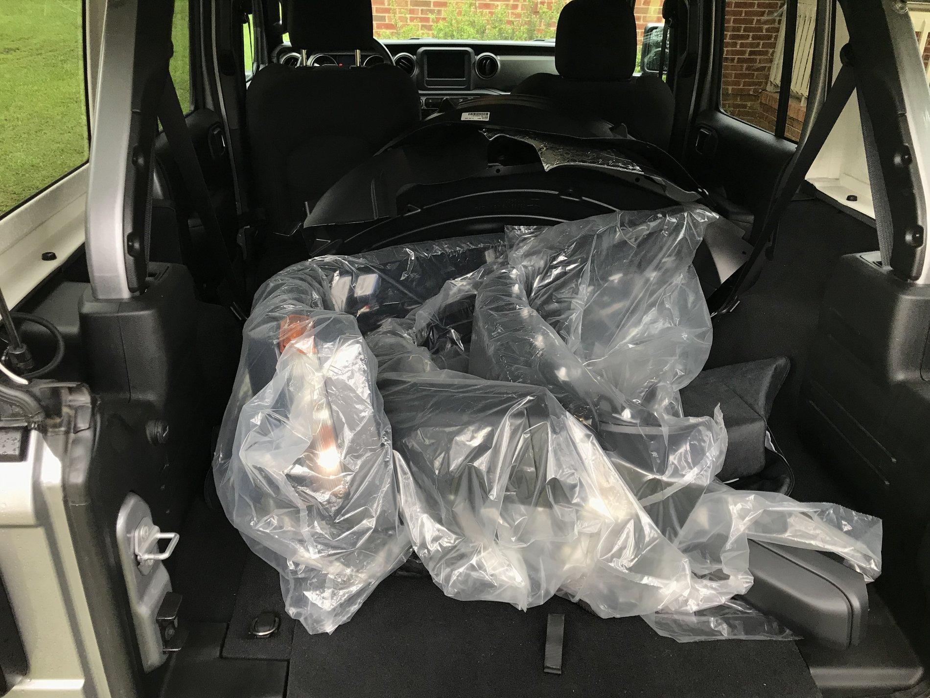

I picked up some brand new rubicon fenders, inner fender liners, and hardware. They are also the LED fenders. I’m not sure if I want to install these or not without a bigger tire.

I was under the impression all you have to do was order the fenders, or did this all come together under one part number?
I bought these off a forum member new and I believe the part number comes with the fenders, inner liners, and hardware. I have everything to install them. Also have a superchips flashcal to change the computer to LED.
