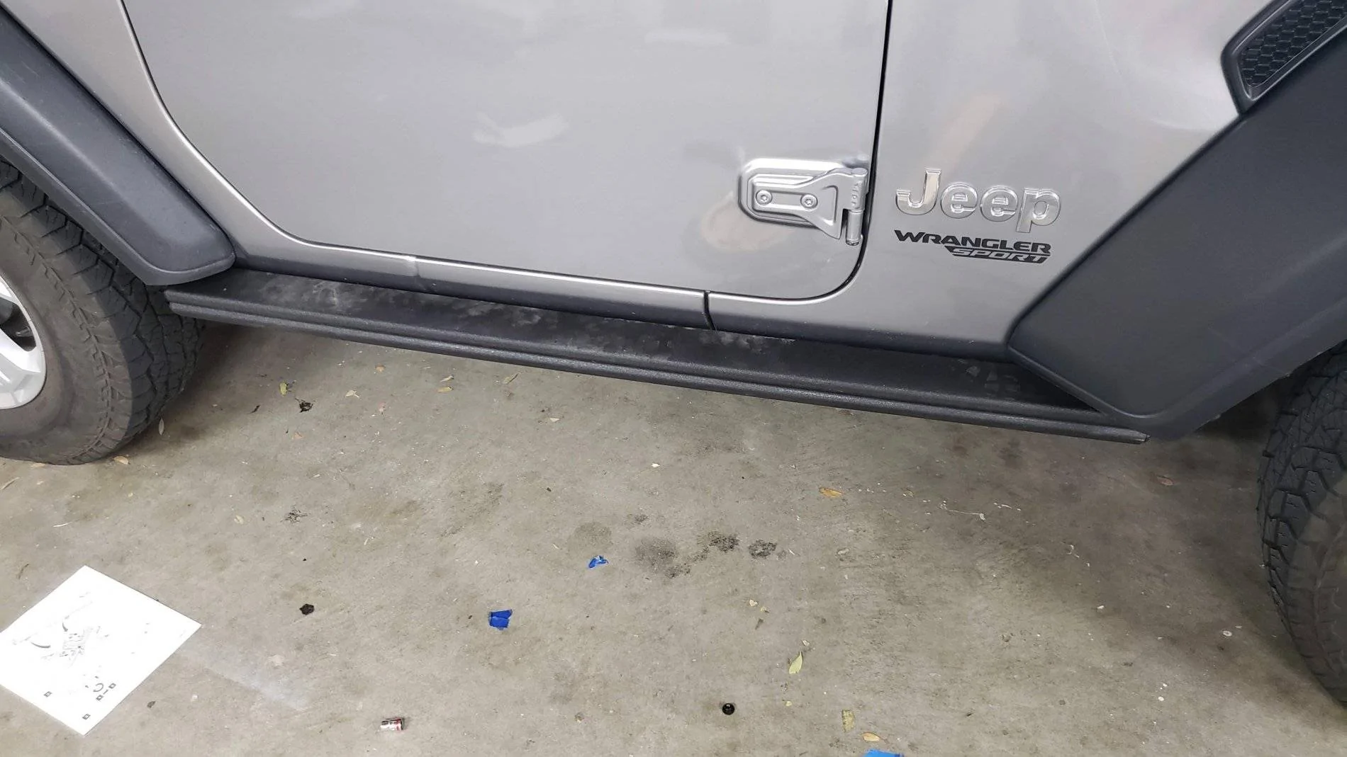

I mean, yes, I wouldn't expect everything to line up properly, but I also wouldn't expect to have to bang them like there is no tomorrow for hours.
After a second day of work, I was finally able to make it fit, but it was really extenuating.
IMHO the issue is with shipping, as the brackets were not protected in any way, so they get bent easily. If you want to save $100 and you have have a lot of strength and patience, then sure, go with BAM.
Jeep Wrangler JL Issue installing Mopar Performance Rock Rails mounted
