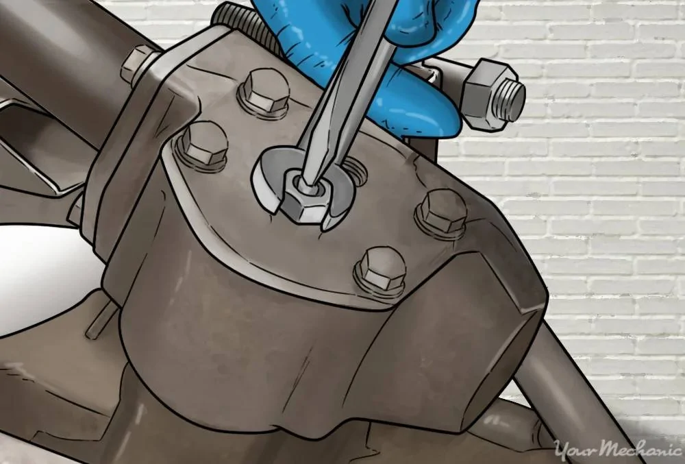

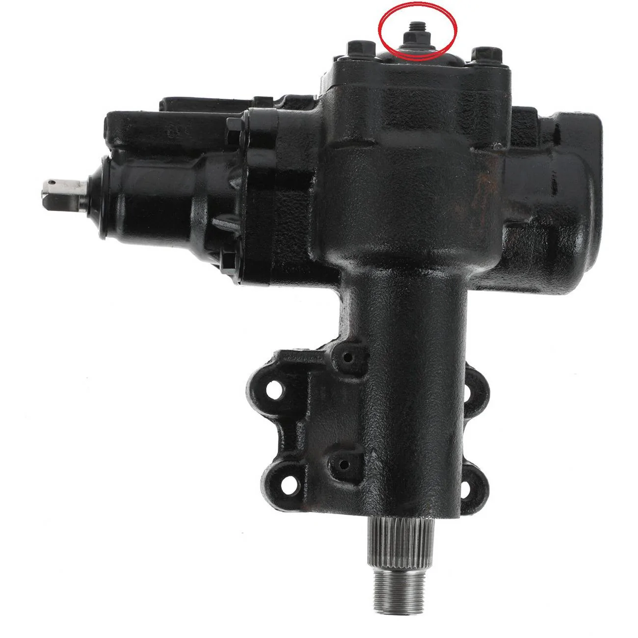

My '19 Rubi aluminum steering box is adjustable. I assume all are. That doesn't mean it's easy. I think they put red lock tite on the threads. I had to heat mine before it would adjust.
Jeep Wrangler JL Is there REALLY something wrong with your steering?? Should you adjust your steering box?? Steering_Gear_Adjuster
Below is the JL steel box:
Jeep Wrangler JL Is there REALLY something wrong with your steering?? Should you adjust your steering box?? s-l1600
PSA: Don't ever do this ⬆
I'm in my mid 60's. I grew up on this style steering gear as rack and pinion wasn't common then. If you know what you're doing (mostly don't over do it by over tightening it), the worm gear steering box can easily and safely be adjusted.
The worm gear box will wear most at center wheel (straight ahead). So, you slowly tighten the adjuster till the steering wheel stops attempting to self center after a turn. Then back off the adjustment until the steering starts to self center again. The adjustment is as good has it gets. The gear box is not harmed. You are not harmed.
If they didn't mean for the box to be adjusted, they would not have put an adjuster on it.
This is Not rocket science.
