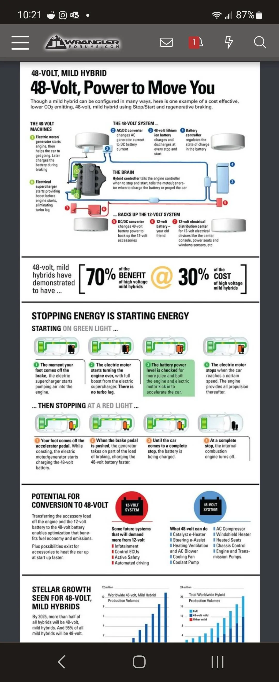

I found this simple diagram of the system in this forum.
Jeep Wrangler JL Is there a JL E torque system delete? Screenshot_20221111_102122_Chrom
