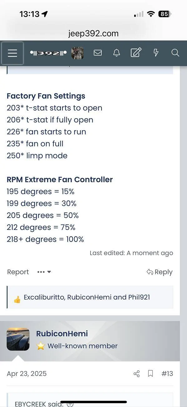

I think the RPM Extreme Fan Controller is the best and easiest fix. I’ve never been above 207 since I installed mine. The factory fan settings are crazy high.
Thank you for sharing these factory fam settings. It explains what I’m experiencing and confirms that the operation of my JLUR is “normal”, as designed.

I still think the factory fan settings are ridiculous. My engine spends relatively speaking a lot more time above 220F coolant than any other engine I’ve owned. Of course only long term will show what the impact is but boy, a little less temp surely can’t hurt the reliability.
