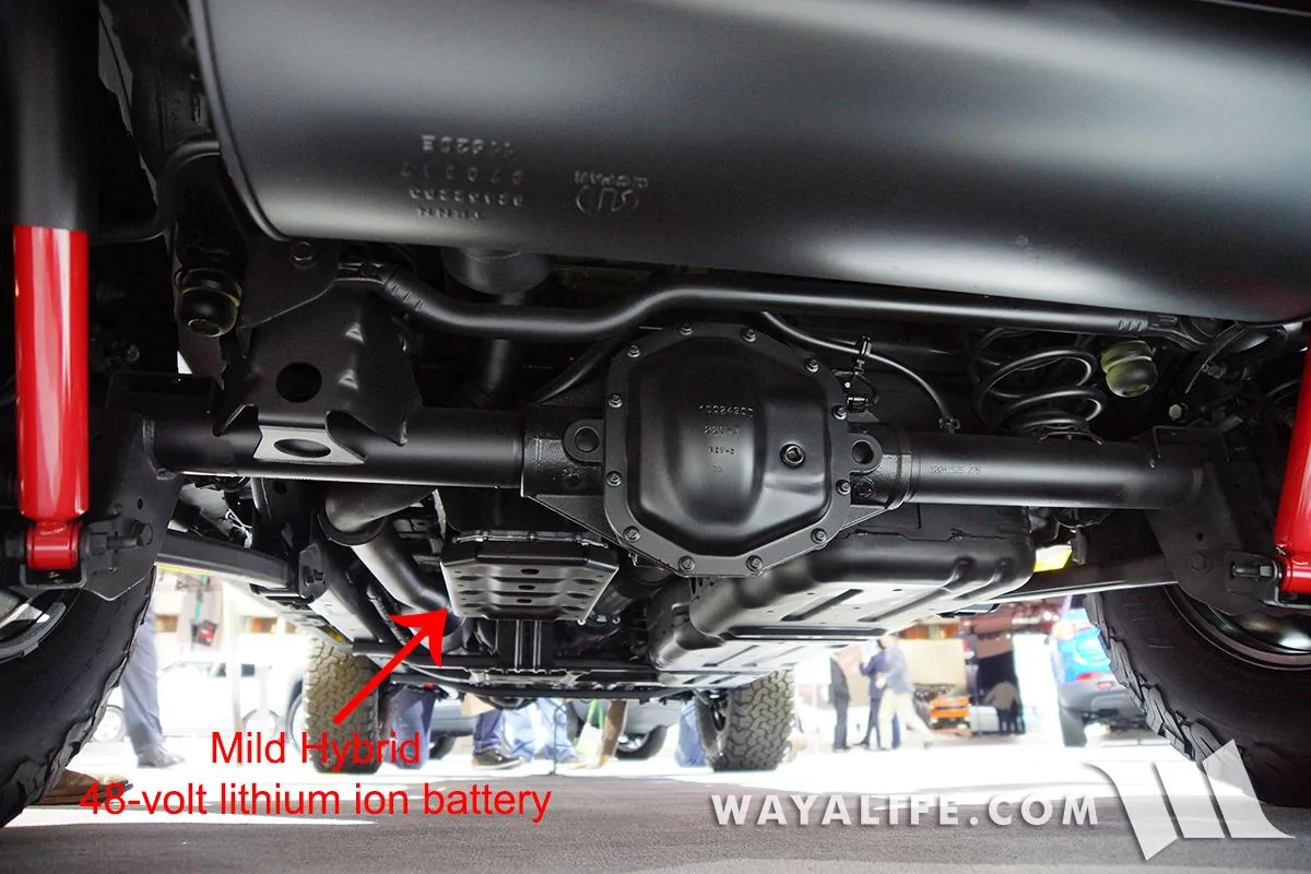

Do you know where exactly the bolt is located?

After reaching out to them multiple times, multiple ways for weeks, I finally got a return call from Jeep, AFTER my Jeep was fixed and returned (how convenient). There was no intention to do anything aside from call me as a part of their internal process. It was actually insulting. I do not know which bolt exactly was the cause, but this image from [Banned Site] points the general location out quite well.
