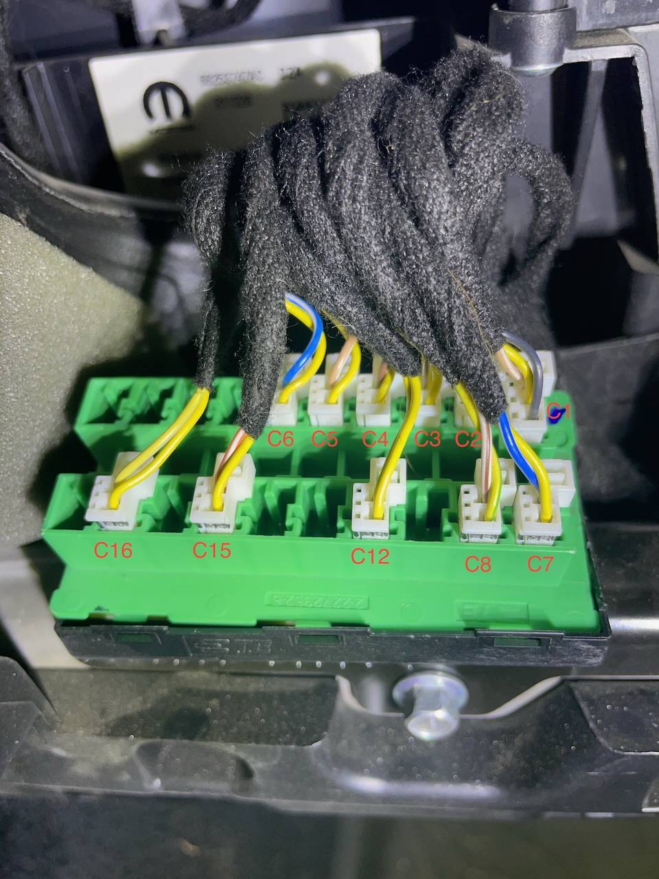

Here is the wiring labeling for my Jeep. These numbers are the connector numbers on "CONNECTOR STAR CAN IP C" in the "CAN C BUS SYSTEM" wiring diagram available on the forum.
Great job of diagnosing!
Thank you for posting the connector map on the CANBUS. I hope it's never useful to me, but I may copy this to my drive.

Thanks. Note my Jeep is a manual 3.6, so automatic transmission modules aren't present. I found the colouring mostly good. The red/orange in the wiring diagram looked more brown to me on the real-life wire.
