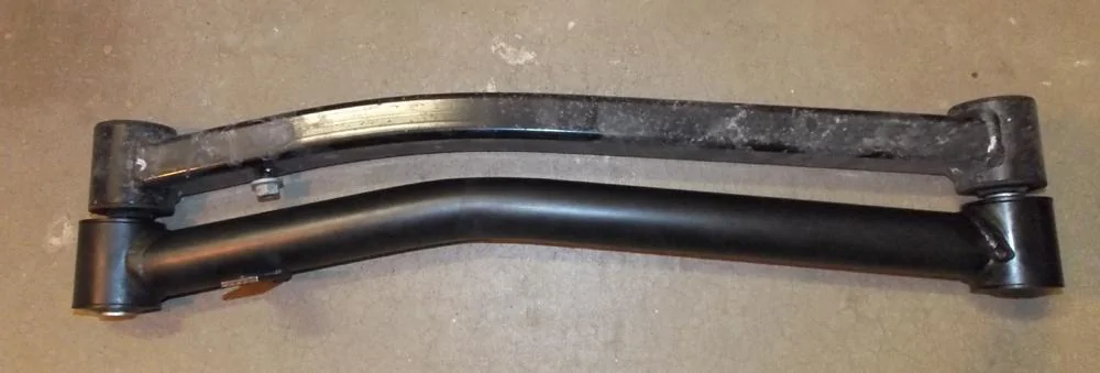

    I also have the Dynatrac kit and KO2's in 315's, I'm adding the Rancho LCA drop brackets on Monday. After a ton of research, I'm hoping that's a better solution for smoothing out the choppy road feel.

    Personally, I would buy the Mopar control arms for $60+ dollars and not loose ground clearance. Less than half the price, but GC is more of a factor for me. I've had AEV in the past.. Just not a fan of brackets.
    The fact that you have a Dynatrac.. considered a small lift. With the Mopar (taller lift) I will go with adjustable CArms

    Well, i've read a far amount about folks adding brackets to their Mopar lifts because their LCA's are still to short. If I was going that route I'd add adjustable.

    The Mopar lifts are adding almost 3.5" Dynatrac at 2 and 60+ dollars for the Mopar LCA's. I like experimenting or Jeep projects, so starting with a low priced option just to see what affect it has is part of the charm/experience.

    It is amazing Mopar lift almost adding about 3" height, but the LCA is barely longer. That is inviting for troubles. Also the track bar is probably pushed to the side too.

    I just installed the dynatrac lift and added the TeraFlex adjustable LCAs at 24.25 and it is almost perfect. I may bump them to 24.5. Huge difference tho.

    I just installed and it is incredible. Tested it over train tracks and speed bumps - the damping is fantastic. It may be more noticeable because of the falcon shocks which were very stiff by comparison. The choppy feel is likely the caster.
