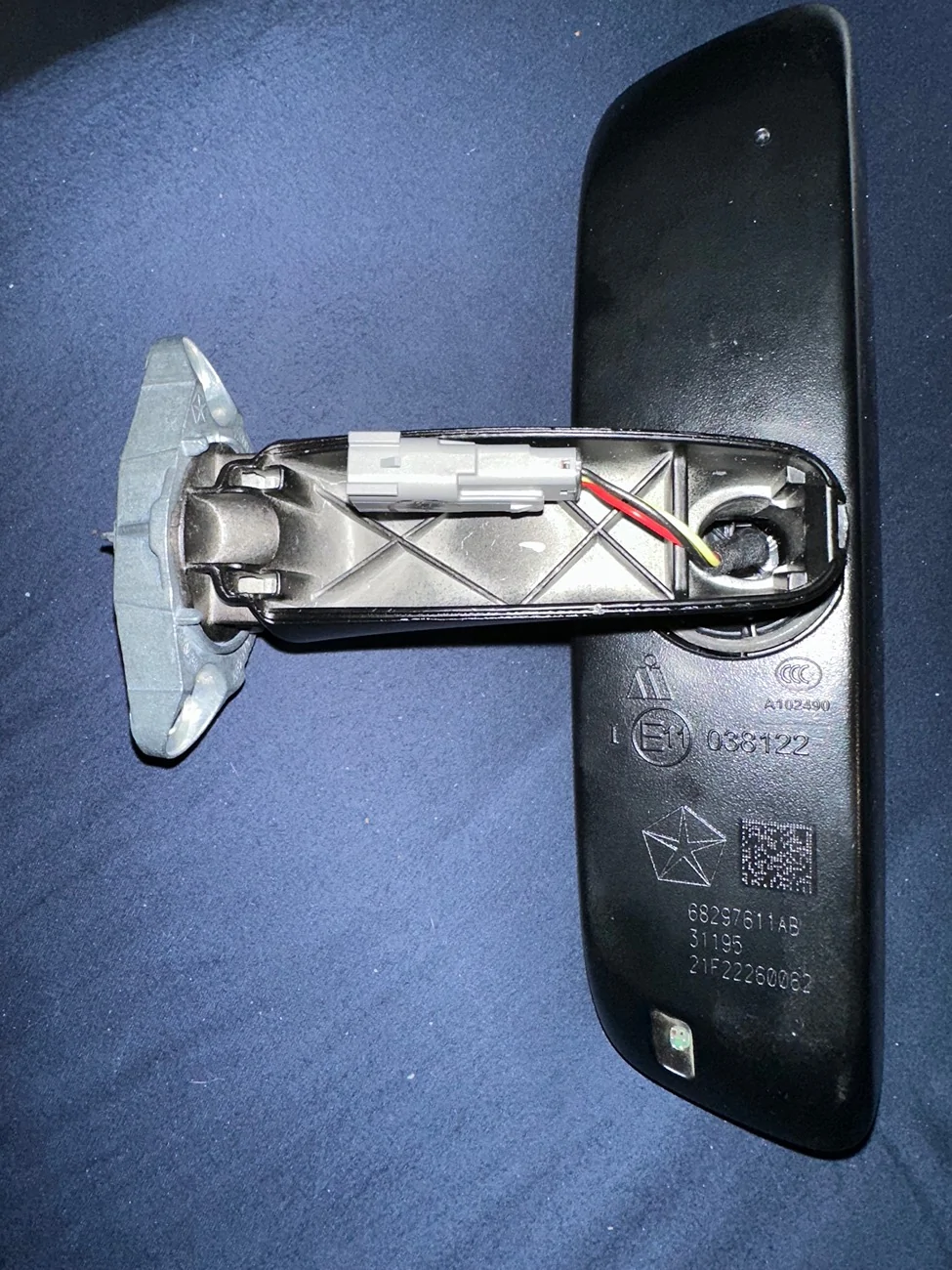

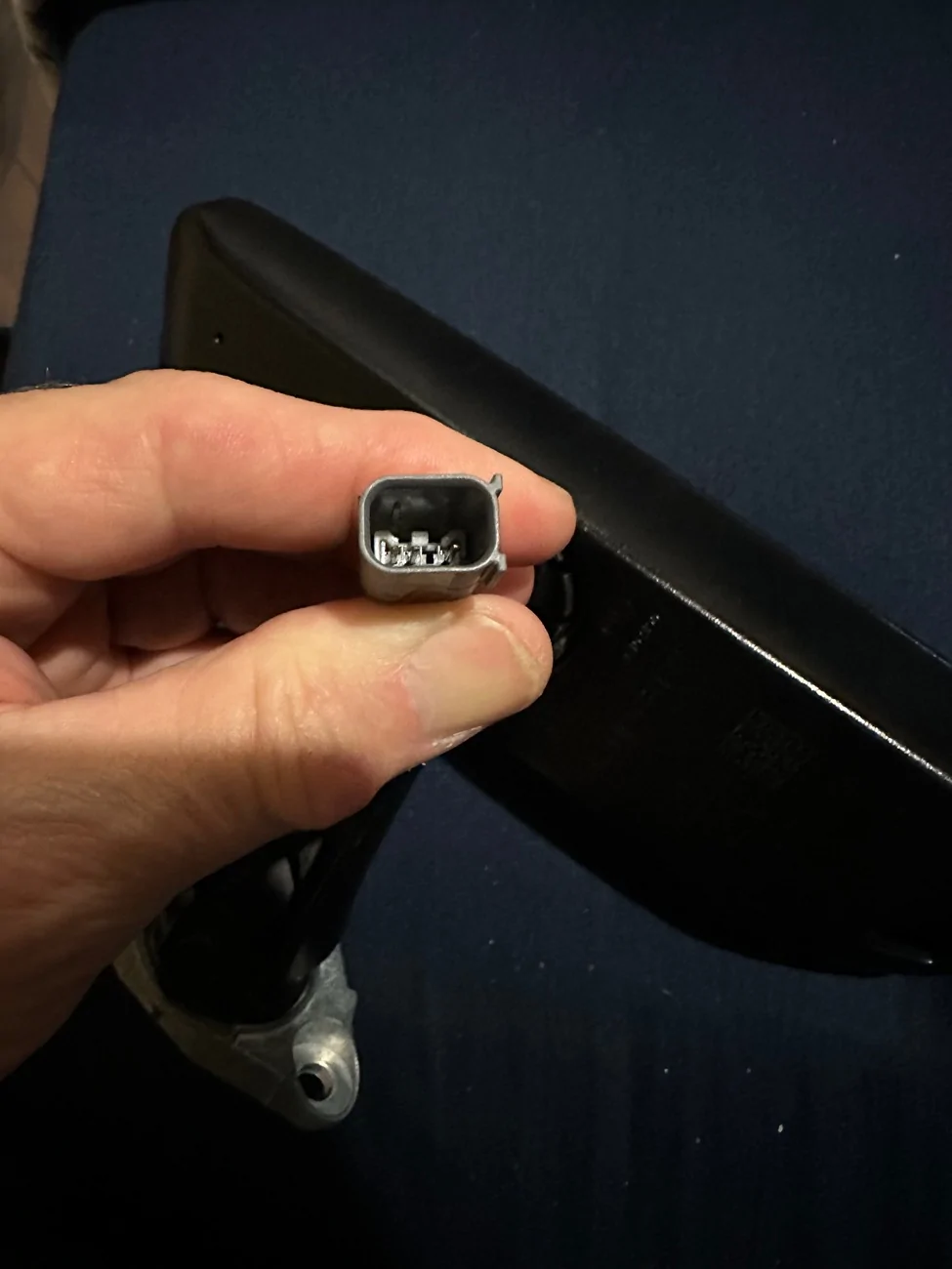

Has anyone used this in a Wrangler? Doesn’t list Wrangler specifically in the comparability list. Would be a great solution for my dashcam connection.
That one is not compatible with the plug coming to my OEM mirror (2021 JLUR). Mine is a 4-pin connector. Let me know if you need a photo of the plug.
I haven’t pulled mine apart yet, but saw some other threads and maybe YouTube video showing 10 Pin. I will pull mine apart tomorrow morning to see what I got. I do have the auto dimming mirror, do you?
Yes Adam, mine is auto-dimming. Photos attached; four-pin plug (3 pins and a hole, only 3 wires in the harness).

This is a whole cam system. It has a pic of the pin. I see alot of 10/14 pin for Jeep but not seeing any 3 pin. Even in eBay. Wonder if the 3 pin will work with a 10/14 pin? Some of the vendors on Amazon show a link to ask about compatibility. Guess you could reach out and see. If you do find something please post in this thread. I'd like to use one myself. There are several hardwire options but of course you have to run those up from the dash area.
I just wish I could cut my rear view mirror arm in half or by 2/3 to get the mirror higher and out of my direct eye sight. It's in the way for me, a freakin blind spot. I forget his handle but one well known member has a Wolfe rear view mirror camera mounted in his dash and did away with the factory mirror fo this reason and since his spare tire blocks his rear view anyway. I might do that at some point.
