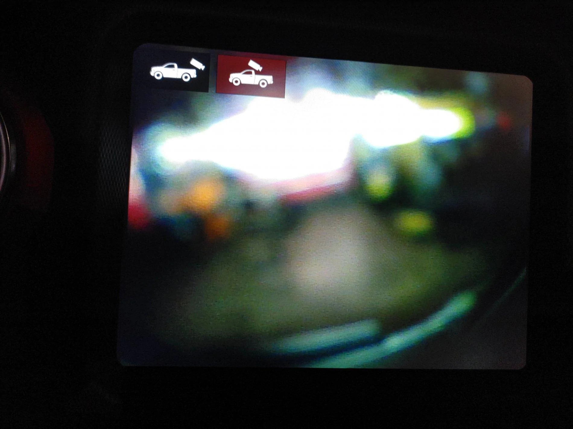

Jeep Wrangler JL Installing a z automotive front camera 20200916_185333_HDR (3)
Anything has to be better than that. That's my wonderful Z camera.
That camera is simply out of focus. You should be able to a easily achieve sharp focus by simply rotating the front lens on the camera until you’ve achieved focus on your preferred distance.
