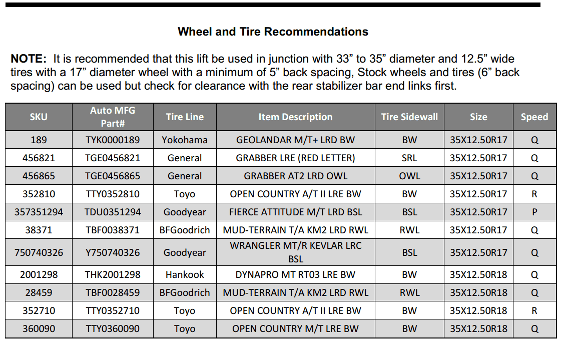

I’m just interested in the recommended wheel offset. It should be 12mm for 35’s, but wanted to double check. Is that in the manual? They included this info in the older JK Mopar lift manual. Thx!
It will fit basically anything from factory backspacing, 6, to as far out as you want to go 4.5 etc. on a 2” lift.
37s you will probably have to dial it in, but 35s will give you plenty of space to even run factory wheels without spacers

Thanks Mattyp. Do you know which offset would keep the scrub radius the same as stock? I don't want excessive tire wear or steering instability from an incorrect scrub radius. I wish the JL Mopar Lift Installation Manual had this info lift the JK manual does. I'll probably just mimic the Mojito build to play it safe. Those mopar beadlock rims have a 12mm offset which they say is 4.4" backspacing.
https://www.mopar.com/en-us/store/p...77072466AB&year=2017&bodyStyle=JK74&make=Jeep
As far as keeping the scrub radius I am not sure. I think the mopar beadlocks are a good place to start. Probably will need more people on here with different setups to get a definite long term answer. I was going to go with a method or black rhino with 4.5 backspacing until I found out where I live cannot have tires stick past fenders. So I'm going stick with stock wheels for now.
I think excessive tire wear shouldn't be too big of an issue as long as you are inflated properly with anything from 6-4.4 backspace. Looking at JK forums the issue is more of rubbing rather than tire wear. People have 50-75k on a set of tires with different back spacings, should not change for different models or types of suvs trucks very much. But I am no expert so could be wrong.
Also could be that the recommended tire and backspacing in the JK was because the wheel well was smaller so higher chance for rubbing? Seems to be less of a problem on JL?
