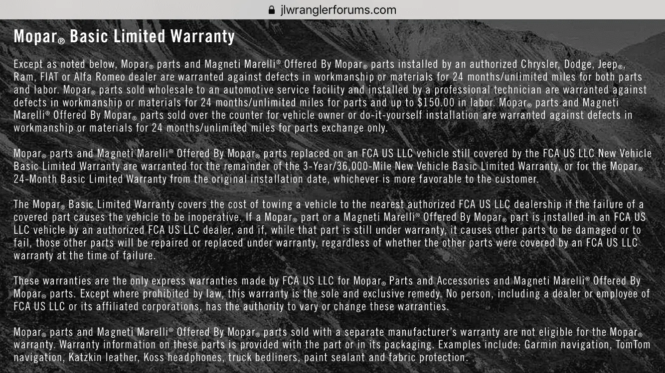

My dealer told me the lift kit would be keyed in under the VIN and treated like equipment that was installed at the factory. The back of the JL Mopar performance parts catalog says something to this effect.

I bought my Mopar kit from Quadratec, who got it from a dealership. My dealership will install it Tuesday. So, how would that work under those circumstances, or would it?
I think you should be fine. Just make sure the dealer enters the part numbers under your VIN. Here’s the warranty. The lift kit is not considered a performance part which is sold As-Is. The lift kit is covered for the entire 3 yr/36k vehicle warranty and will cover parts outside of the 3/36 warranty if damaged by the lift. My interpretation of this is if the Mopar lift eats up a set of tires, the tires should be covered.
