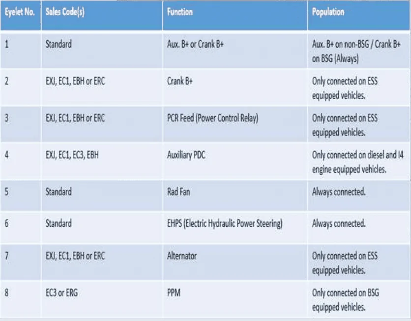

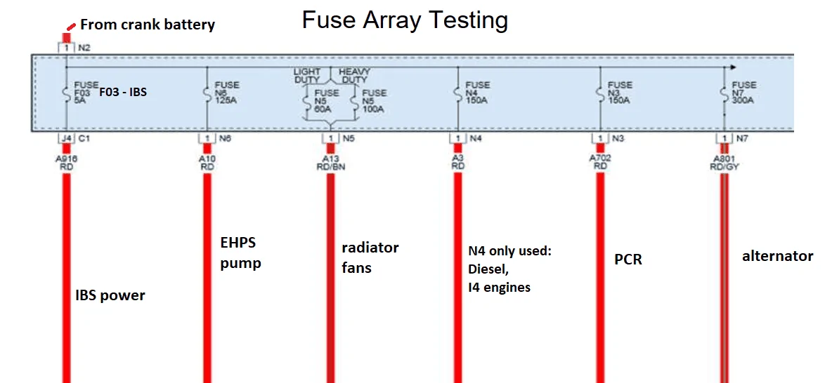

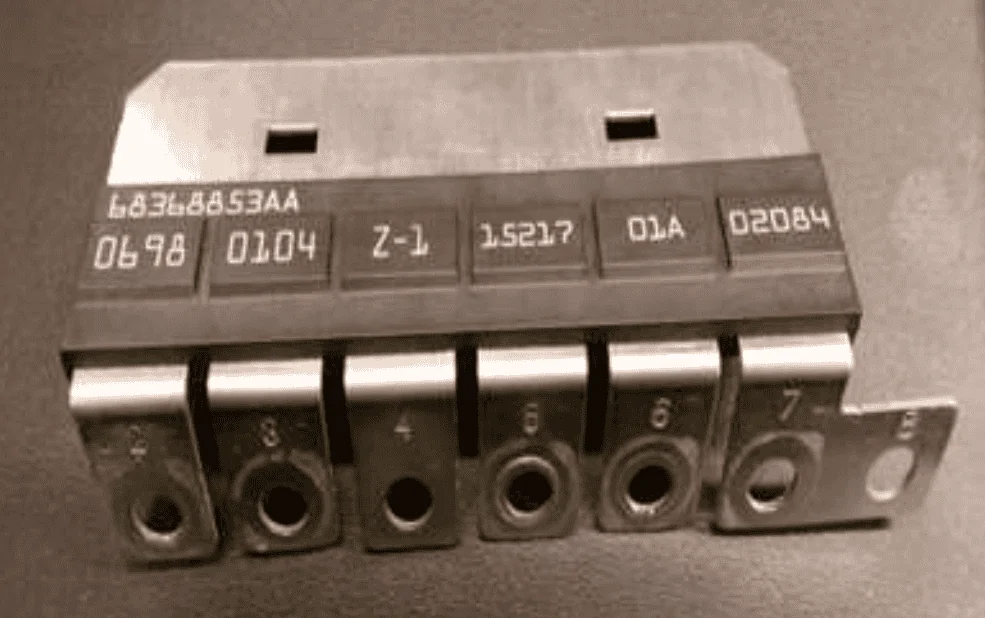

Bet the high current fuse is blown.
All of these are EHPS - electro-hydraulic power steering and get power through the high current fuse on the end of the PDC.
More than one person has blown a part of that fuse when swapping batteries.
Check the fuse map in the cover of your PDC.
See that you have power to N6 stud.
The high current fuse array is basically what all of those studs are about on the end of the PDC.

Just checked the N6 post. I have 10+ volts on it, without the Jeep running. What should I expect?
Fudster
Elliot
Mar 9, 2022
656
684
Athens, GA
2019 Sahara
Keith:
If I'm not mistaken, testing the high amp fuses is done by setting a multimeter to its continuity setting and simple testing if a fuse has continuity: i.e. hasn't been blown.
The fact that you are detecting voltage on it though is probably a good sign that it is not blown and that cause for your power steering failure may lie elsewhere.

You were right. I replaced the high current fuse array as you suggested. Success! Thanks. Next time I'll remember to be more careful when changing the battery and handling the leads.

It should be reading the same as your battery voltage.
Yes, exactly, because it has near 0 resistance.
A lower voltage is because it's feeding back through the EHPS pump to the fuse, not from the battery through the fuse.
You are in a club with a number of members, I'm sure. Even after decades in the field with too much experience, I've had a boo-boo or three LOL
The positive side of it is - you will not soon forget. Next battery replacement, it won't happen to you.
