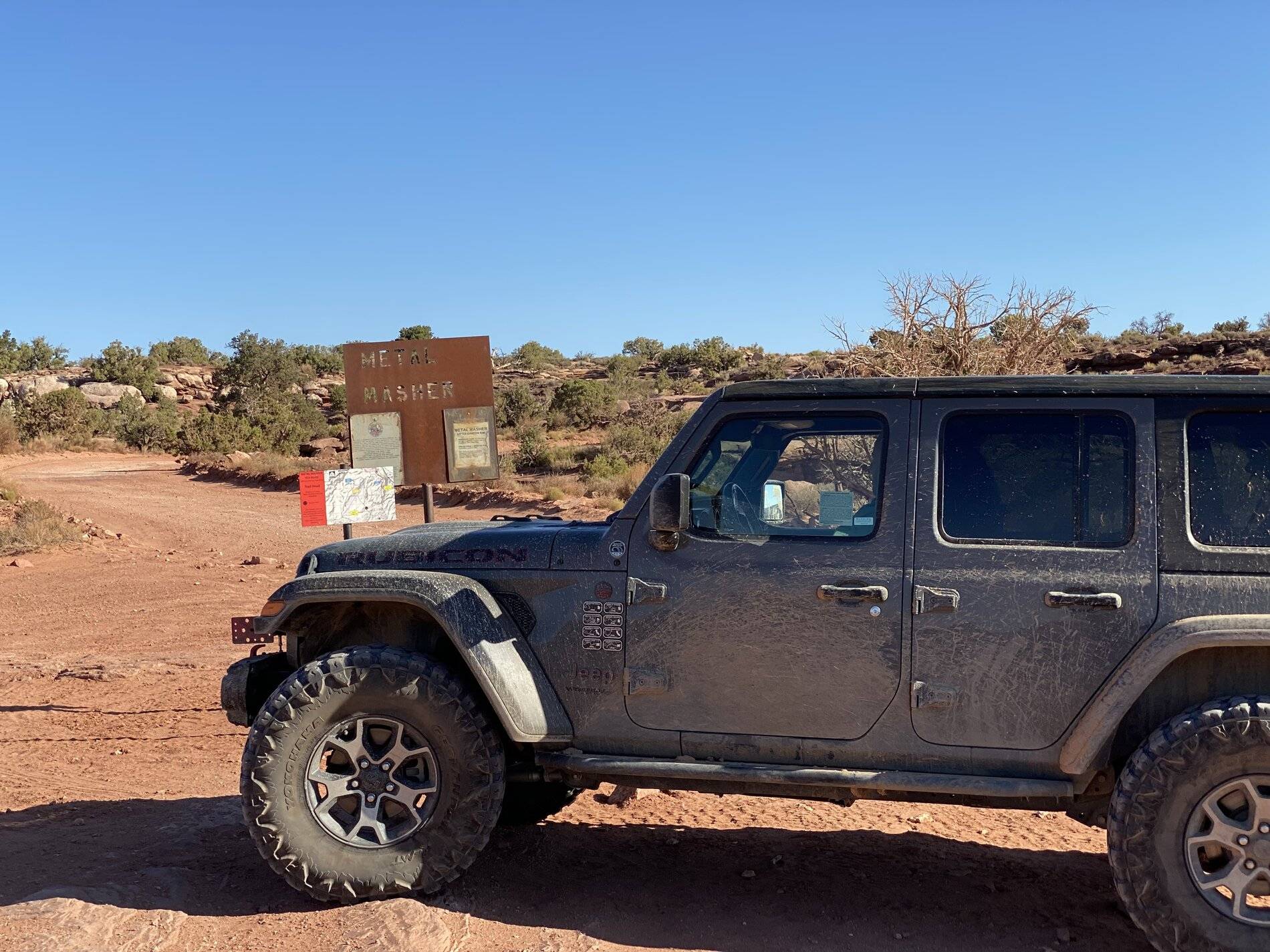

I'm sorry, were you referring to the hilarity in my comment? When you take my entire statement into account rather than the small snippet you seem fixated on it is still factual. Only the first and last sentence are my opinion. If money isn't a concern then go all in on the big tires.
"Personally, I think 35”s are the sweet spot. You’re less likely to need a regear and you can still fit the spare on your tailgate with a reinforced tire carrier and the factory bumper. Going to a 37 only gains you ~1 inch additional clearance over a 35 but costs a bunch more. At that point you may as well jump to 38 or 39
Although a 37+ does look badass…"
You weren't the only one with an "only an inch" comment which is why I didn't reply to you specifically. As far as "costs a bunch more", the spare tire relocation bracket was $120 and we already had the Mopar tailgate reinforcement on the jeep (I'd want it for a heavy 35" anyway). You absolutely don't need to regear a 4xe with all that low end torque the electric motor adds. Obviously tire for tire a 37 will cost a bit more than a 35, but the op was already planning a lift. The only added cost of 37's is the relocation bracket at that point. Cheap as far as the overall build goes.

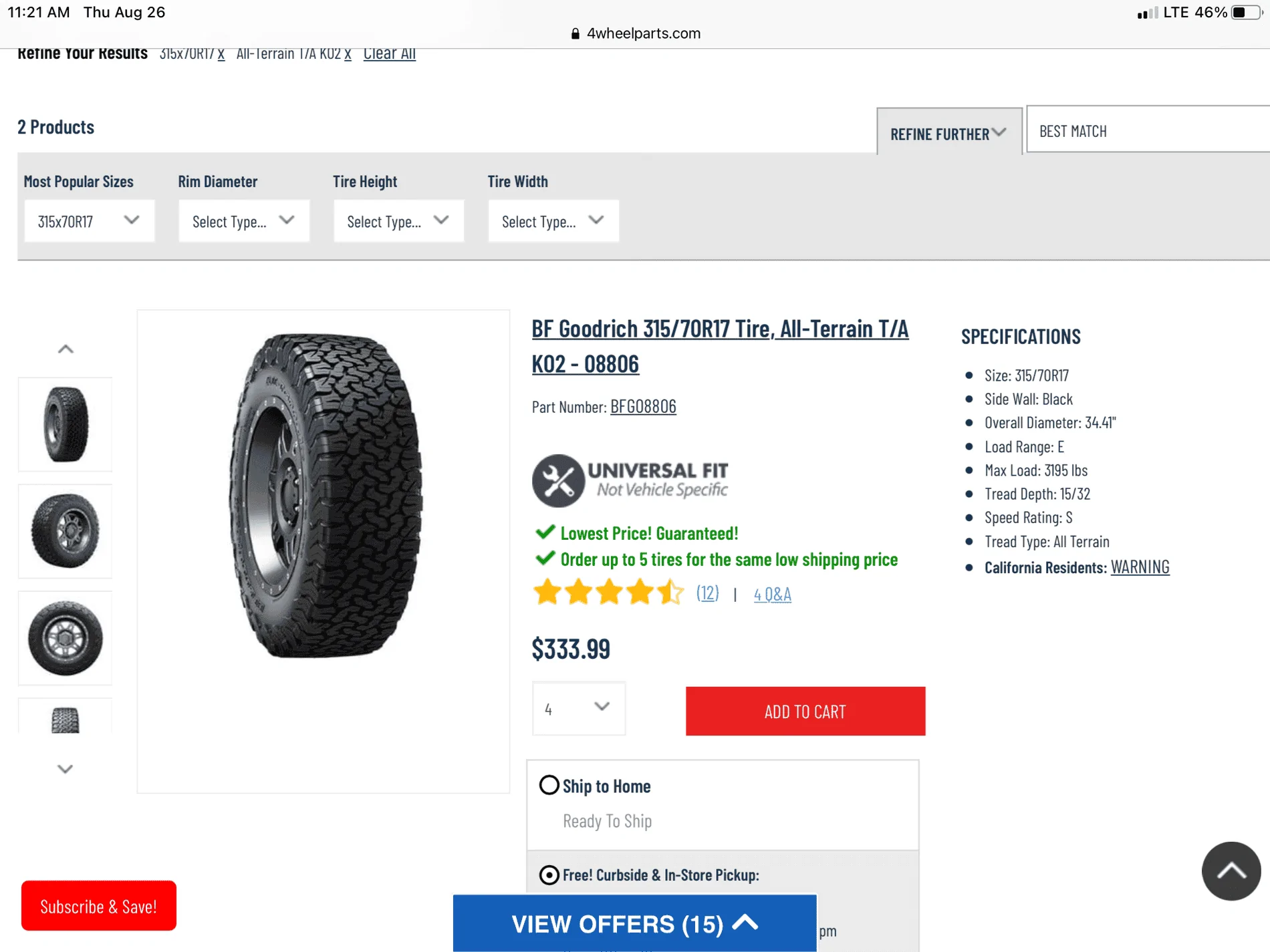

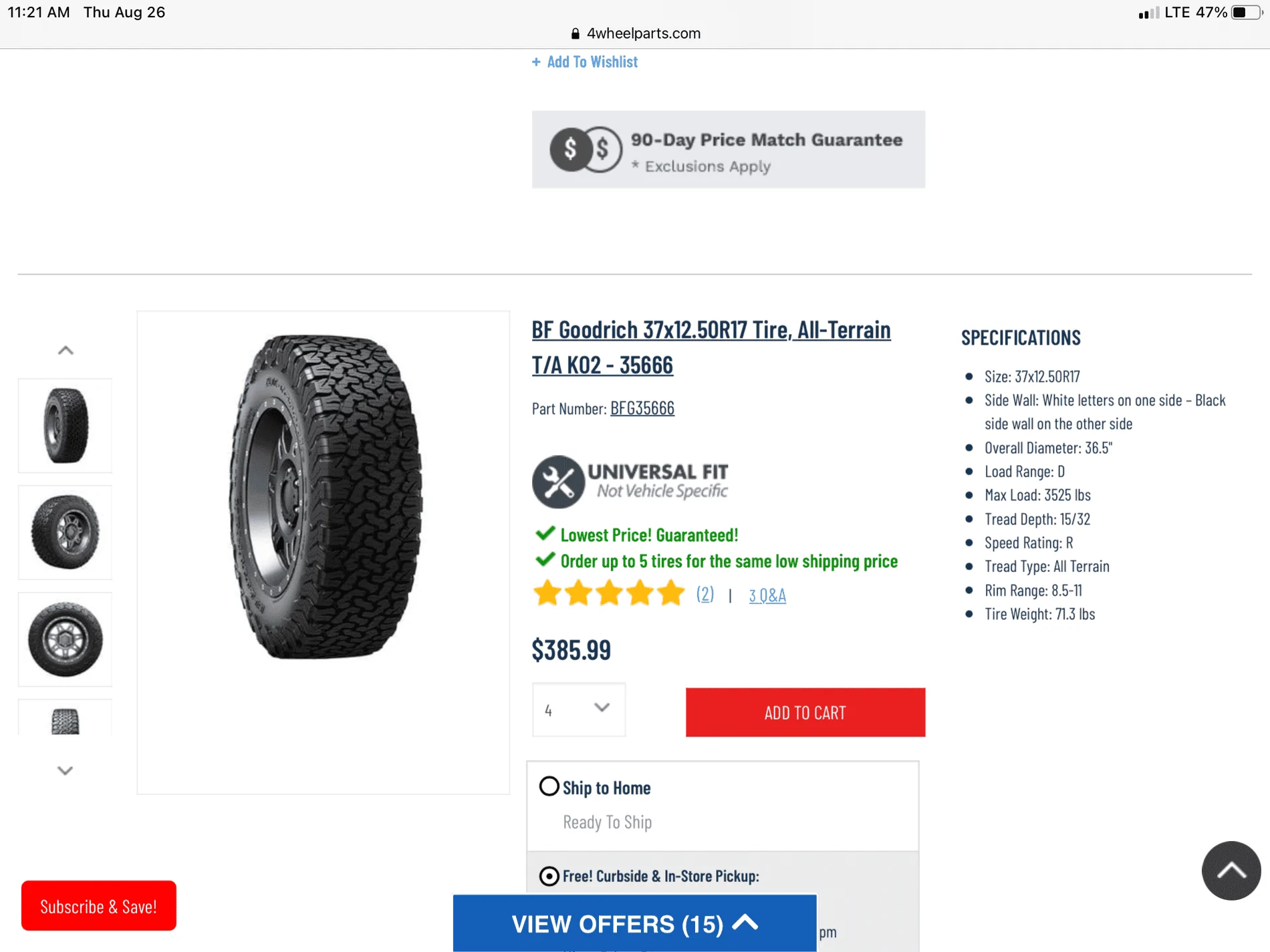

I hope you didn’t pay an extra $200/tire… should be more like $50/tire difference.
Jeep Wrangler JL Ideal tire size.. 193E4794-09DB-4903-A911-57F01A973D50
Jeep Wrangler JL Ideal tire size.. 341773EA-3005-49C0-9A4B-68B923C74085
