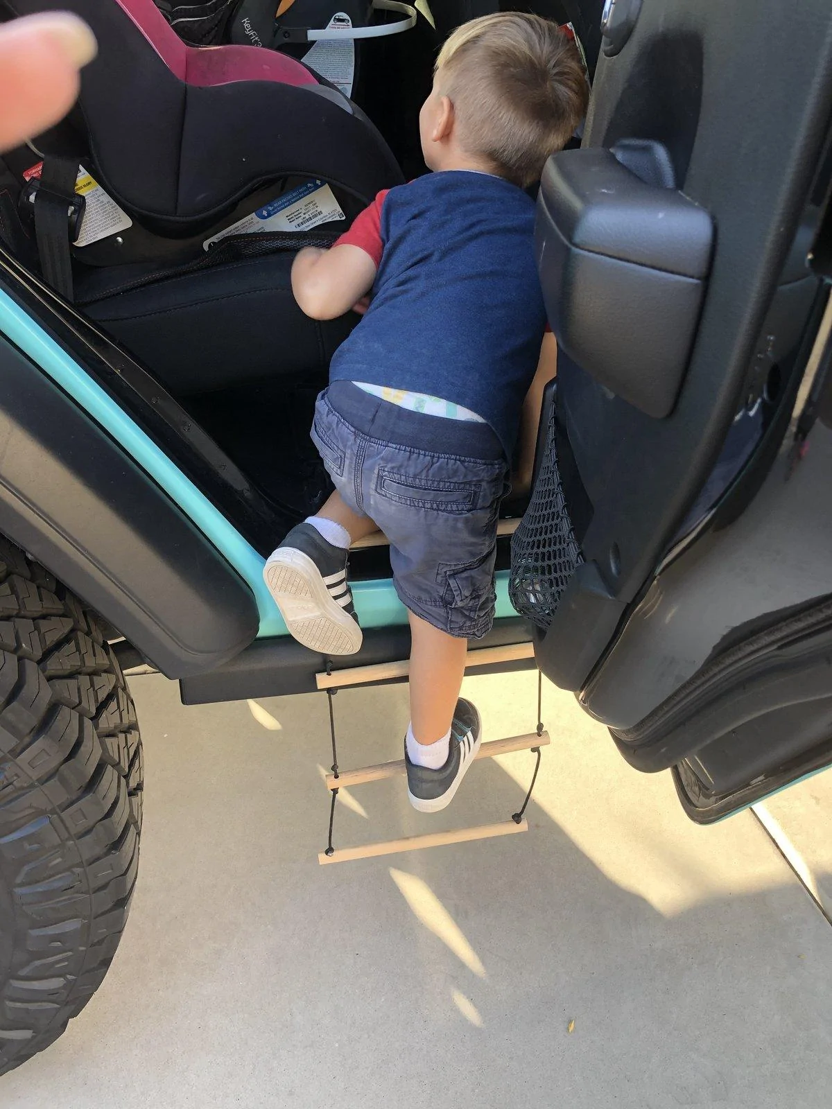

And another cute little thing I did...I made a little rope ladder for,my toddler to climb up into my Jeep. He LOVES it and it’s really cute to watch him!

:CWL: :CWL: :CWL:
I have seen some creative solutions for this.
Hahahahaha!
My shoulder is still wearing a little fist sized bruise after showing her a similar picture.
