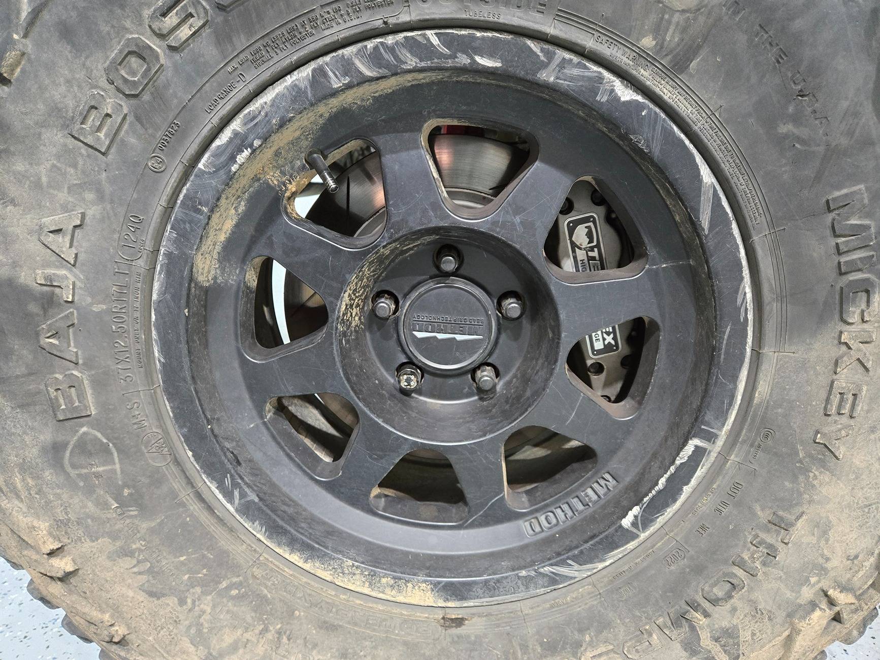

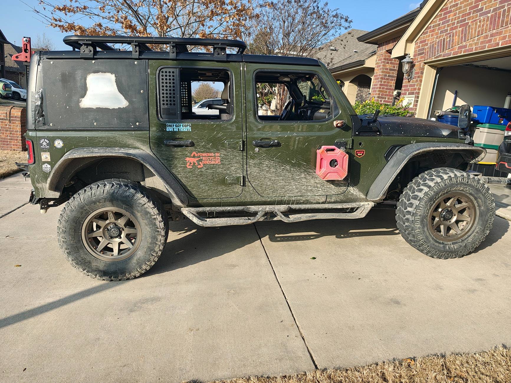

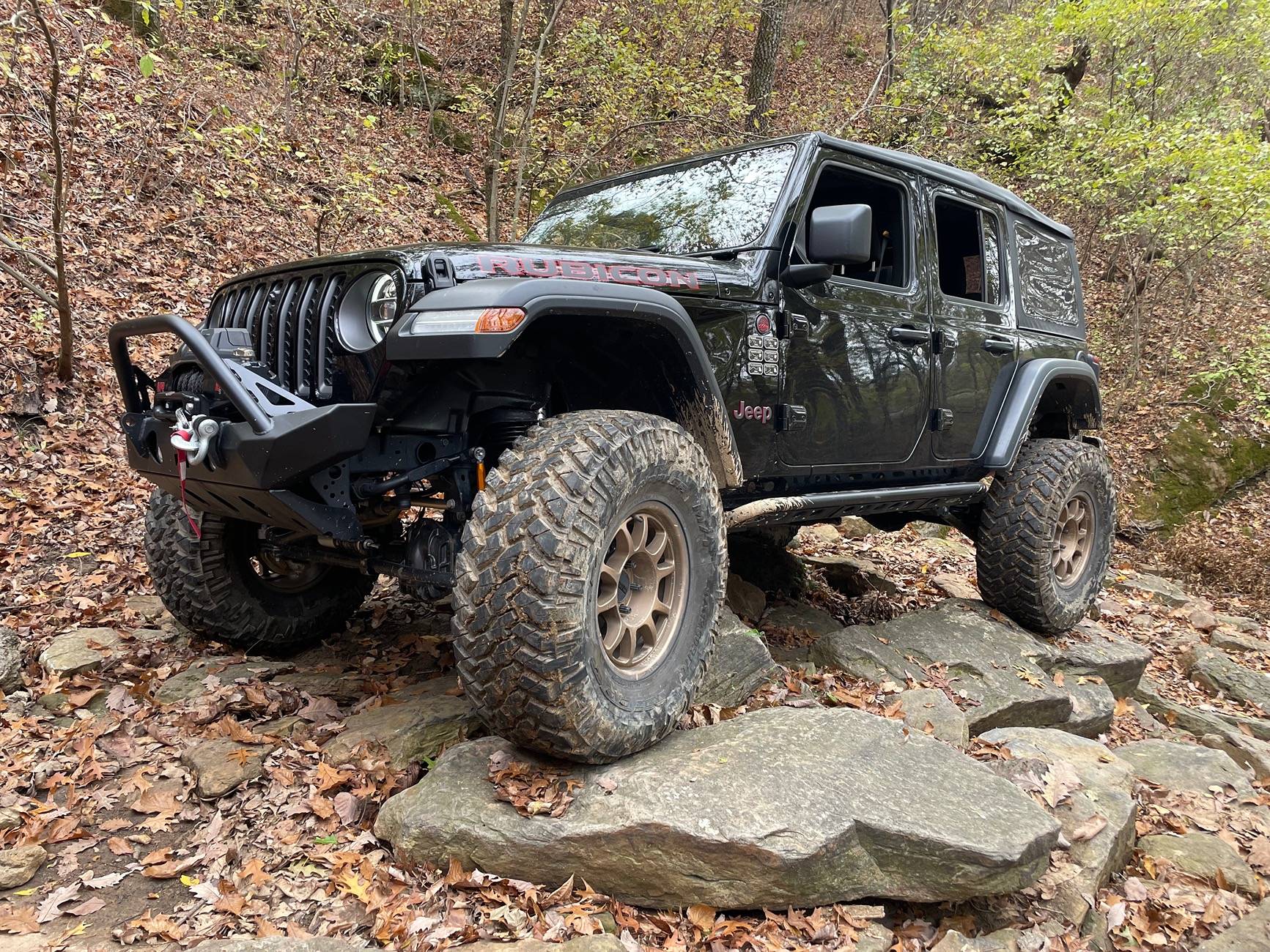

I have the Method 702s in bronze and run 10psi on the trail. I would never want to touch up the well earned rock rash either.

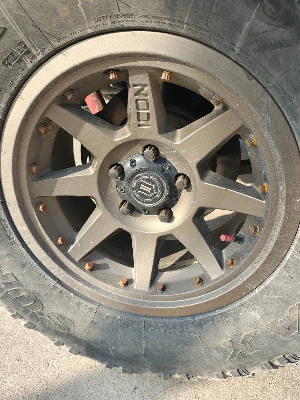

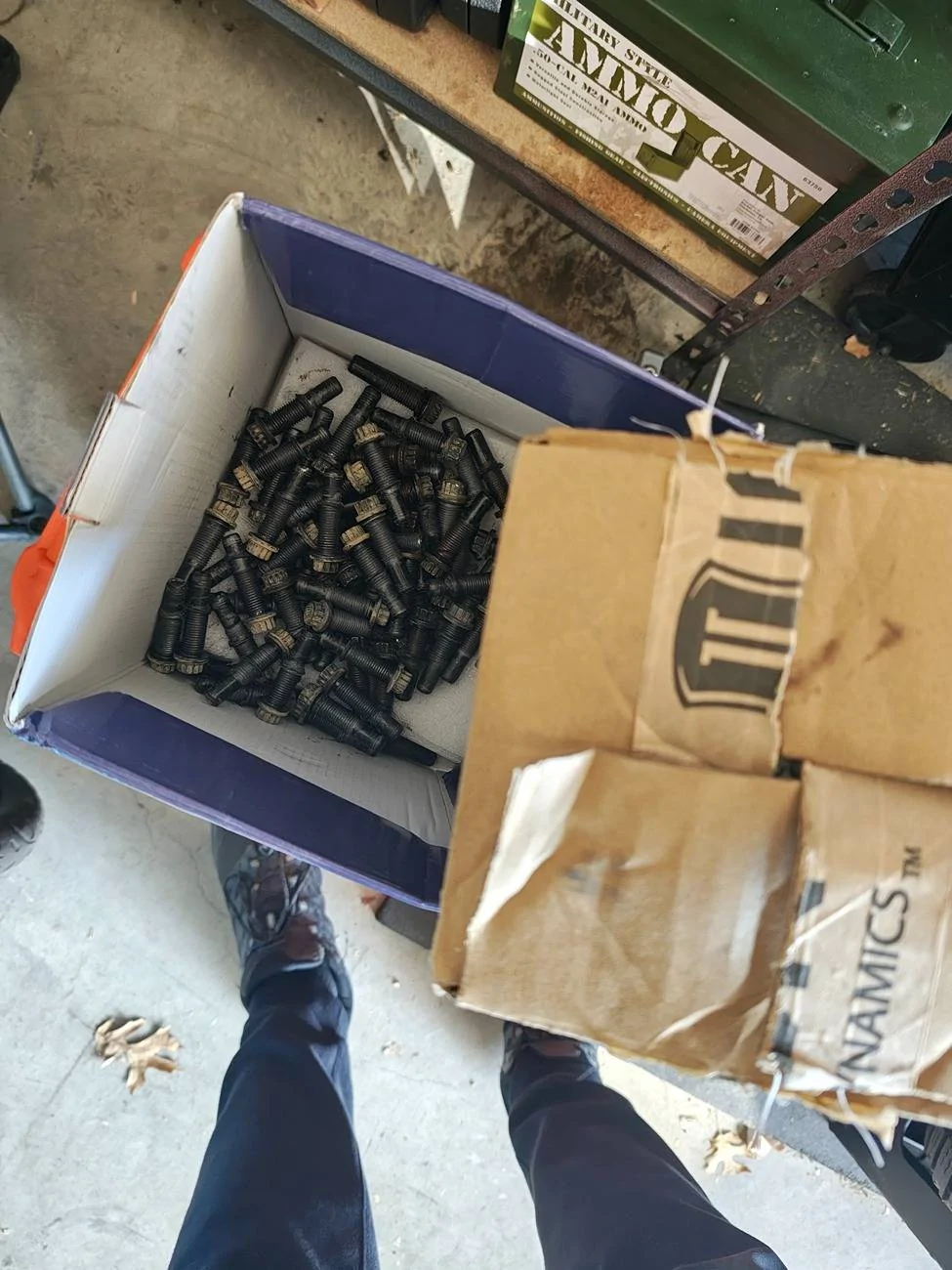

What @Ratbert said is true. A lot of shops will charge you a premium price for having to deal with the beadlock bolts or the interlock bolts with the icons. I myself have developed a way to replace the bolts in the icon wheels and and save myself $540 on a set of 4 wheels. It's definitely not for everybody though, however I can say it does in fact work. I'm currently driving around in my Wrangler with Icon Rebound Pro (non-interlock) wheels. :CWL: :rock:
If you're interested in that I can send you the link to that post or I think I have a video or two on my YouTube channel. :like:
I forget who but someone on here told me that NTB will mount beadlock wheels at no extra cost. So if that's your thing, you can always look them up.
Jeep Wrangler JL Icon Recon Pro or Method 703 Bead Grip 1000008325
Jeep Wrangler JL Icon Recon Pro or Method 703 Bead Grip 1000008326
Jeep Wrangler JL Icon Recon Pro or Method 703 Bead Grip 1000008327
Only real downside of running the bolts non interlock style, is that where I get the bolts from, they don't have the protective coating that stops them from rusting like the ones that come with your wheels do. I could probably get them coated in something, but why bother? I only run them like this for a month max while I am in the process of getting new tires mounted.
Jeep Wrangler JL Icon Recon Pro or Method 703 Bead Grip 1000008329
You got to pick you up some o-rings from Amazon if you're going to play this game though.

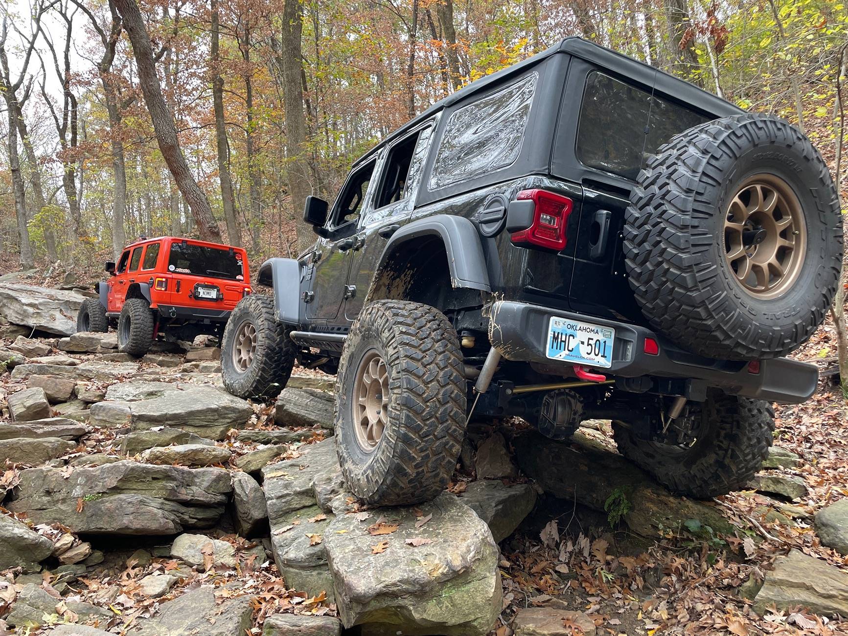

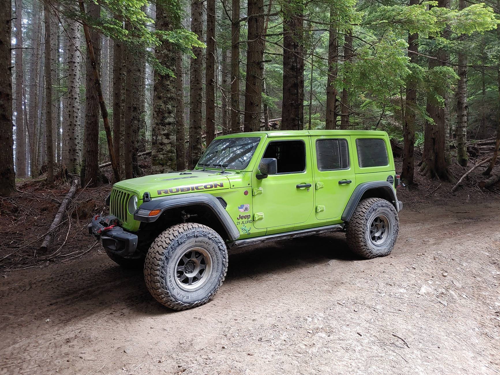

I also have a 2021 JLURD. When deciding on wheels, it also came down to the ICON Rebound Pro vs MRW Bead Grip. I went with the MRW due to the greater backspacing (-12mm) to clear the suspension components and give me more stability on sidehills, weight, and knowing several people who were happy with their bead grips.
Other things I considered are that both should do a good enough job of retaining the bead at high-single digit psi. Remember that beads get “glued” to wheels the longer they’re attached. Old tires (>10 years) are sometimes a PITA to remove from a wheel. My biggest concern now is spinning the tire on the wheel (therefore ripping the valve stem off) at low pressures while applying lots of torque at low RPM as our diesels are prone to do. I don’t think either offers any more protection, and not as good as a true beadlock.
As for how low you can go, check out the recent ads from MRW on the February 2025 issue of OVR Magazine. I combined them in the picture below. I read that as MRW saying you are safe going as low as 8 psi.
I did go with the 701 instead of the other Bead Grips because the tire valve stem is more protected. Take a look where it’s located on both wheels. I’ve seen several flats on the trail due to valve stems being cut on the rocks.
As for rock rash, I’m not a fan of it. I periodically hit them with black paint but I’m getting lazy. I’m considering having the outer wheel polished to bare metal.
My pictures are with 3.5” (really closer to 2.5”) lift, 37x12.50R17, MRW 701 17x9/-12mm.
