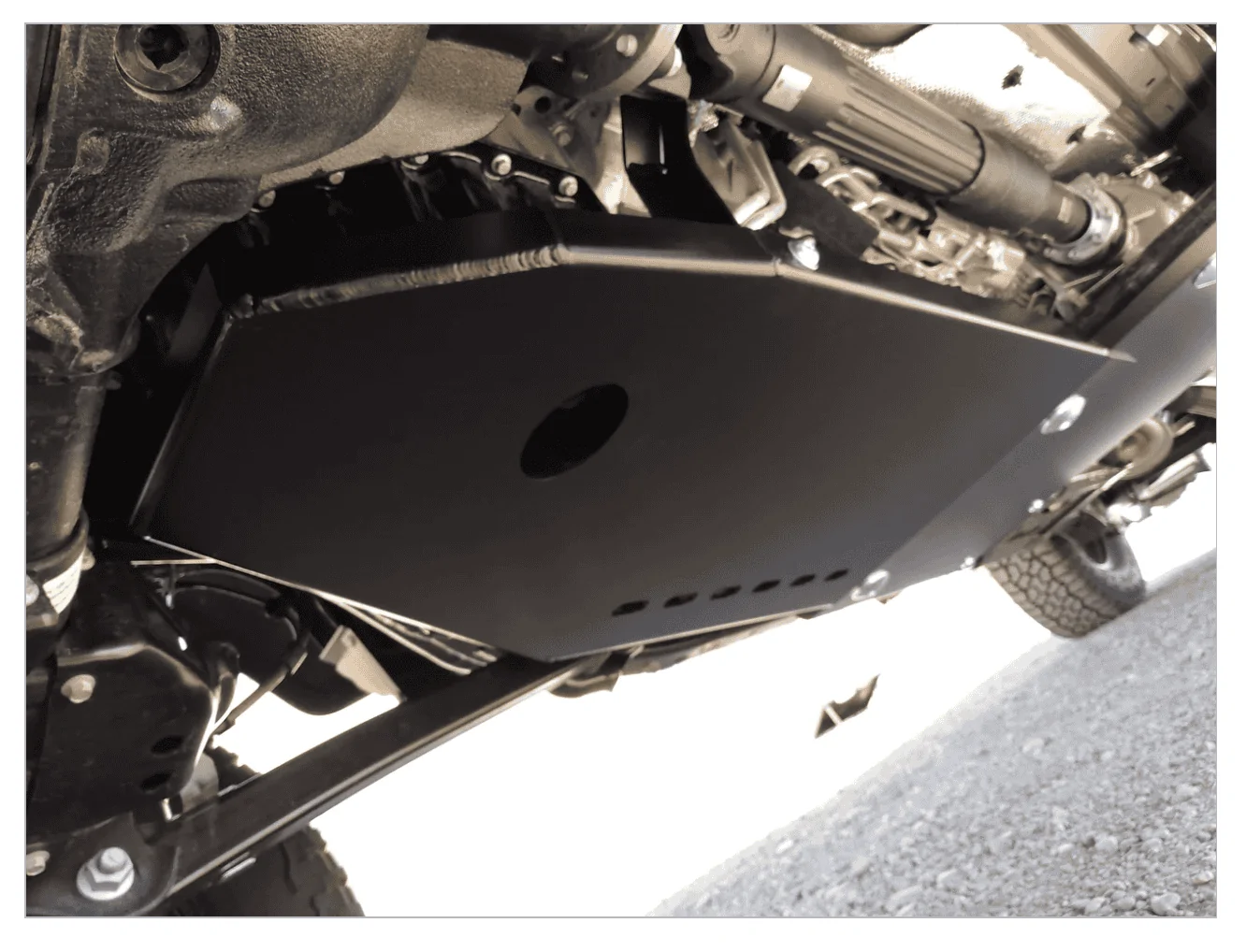

I have a couple of questions regarding the high pressure fuel pump recall:
Do they replace the fuel filter at the time of the recall?
I have a MORE engine and transmission skid plate - should I remove it for the new fuel pump installation?

The HPFP is accessed from the top of the engine and the fuel filter isn't changed during the replacement (at least it wasn't on mine).
Exactly. OP shouldn’t have to do anything unless the filter started to grenade or something, and they have to do additional work.
