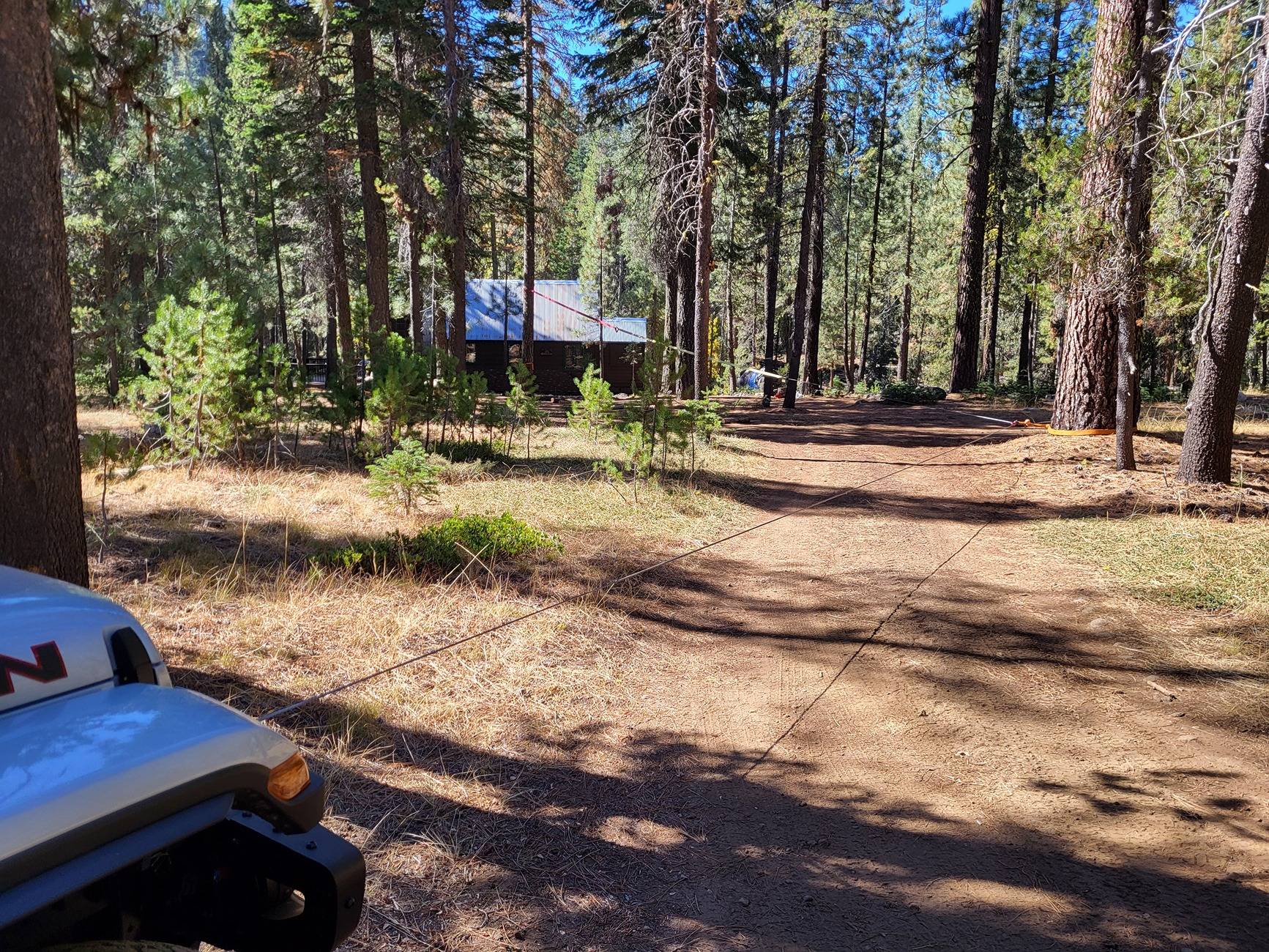

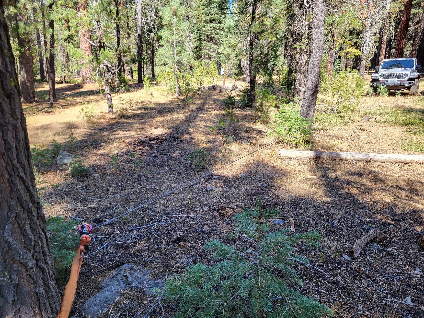

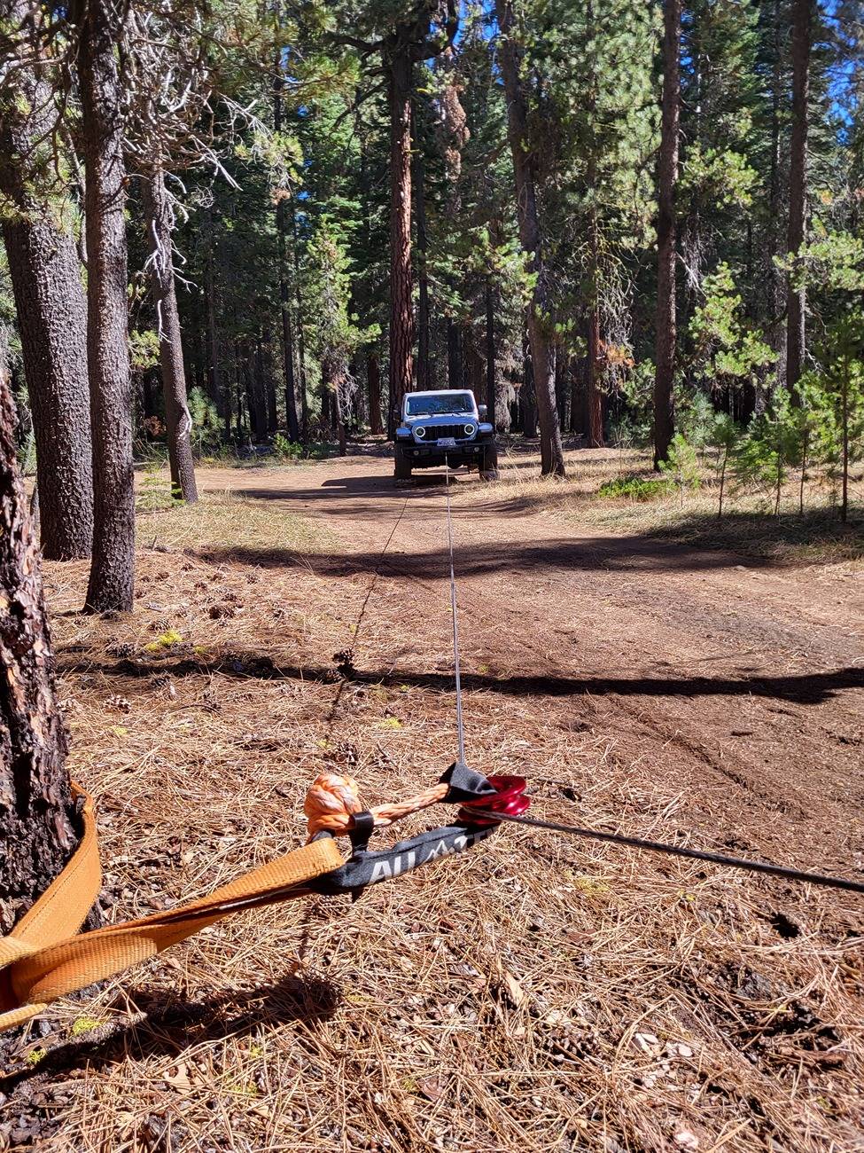

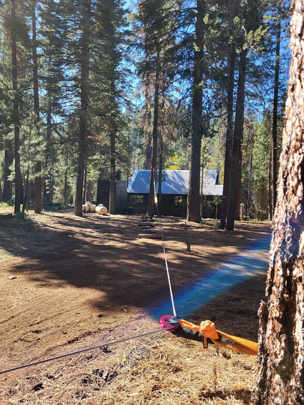

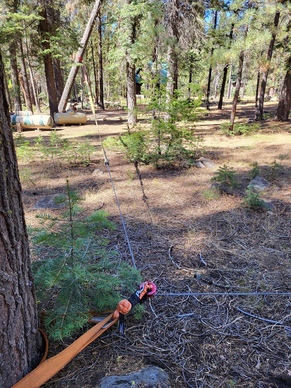

Here are a few pics from yesterday of a dead tree I had to take down that was leaning over my cabin.
I had to use a snatch block to get the angles I needed and the direction I wanted the tree to fall.
The tree hung up in the overhead canopy and maxing out the winch would not pull it down.
I had to set up for a second pull from the side which got the tree on the ground.
Besides your winch, plan on purchasing at least two snatch blocks 6 to 12 soft shackles several 8 to 12 foot anchor straps and another 100 feet plus of cable in 50 foot lengths.

I would only run a tree saver with steel on the ends if I had a hook. Unnecessary potential projectiles if you don't.
As others have said, while you'll want to have some steel bow shackles, the soft shackles will win you over quickly once you use them.
I carry a snatch ring, and a more compact (than the warn) standard snatch block. The block is heavy, but easier to carry than a thick one like the Warn or AEV.
Isn't 6 to 12 soft shackles a bit excessive? 2 should be enough for most people. Decent quality versions are $40 to $50 a pop.
I would do at least six total shackles in case you need to use the tree saver as a bridle in a basic snatch blocked pull.
2 to bridle the load (say one on each recovery hook on the vehicle), one from the winch to the bridle (could be a hook), one from the snatch block to the other tree saver, two more tree saver anchors.
Just a recent example on why you may need this, recently winched a load on a trailer, needed to center the pull (snatch block) on the trailer using the two d-rings on the sides.
EDIT: Another reason I wouldn't do the Warn tree saver just popped in my head. That tree saver cannot be used as a choker without adding another shackle.
Sometimes I link shackles to get a little more distance when a tree saver is not quite long enough.
I rationalize the cost of recovery gear by figuring a tree company in our area would charge about $1000 to take out a hazard tree.
I am also a gear and tool hog, so there's that. :)
