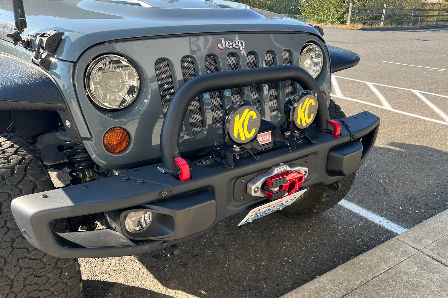

@Reinen hit it on the head. That bit of rope hanging out of the fairlead is getting cooked everyday the sun is out and it is typically the reason why you'll see synthetic ropes break within the first 12-18" of the hook.
That's one of the reasons that the Factor 55 thimble and Pro ends are so popular, it lets you suck the winch rope in all the way to protect it.
Random look out in our parking lot this morning....
Flatlink E with Rope Guard:
Jeep Wrangler JL What to do with winch line when not in use? FlatLink-E
