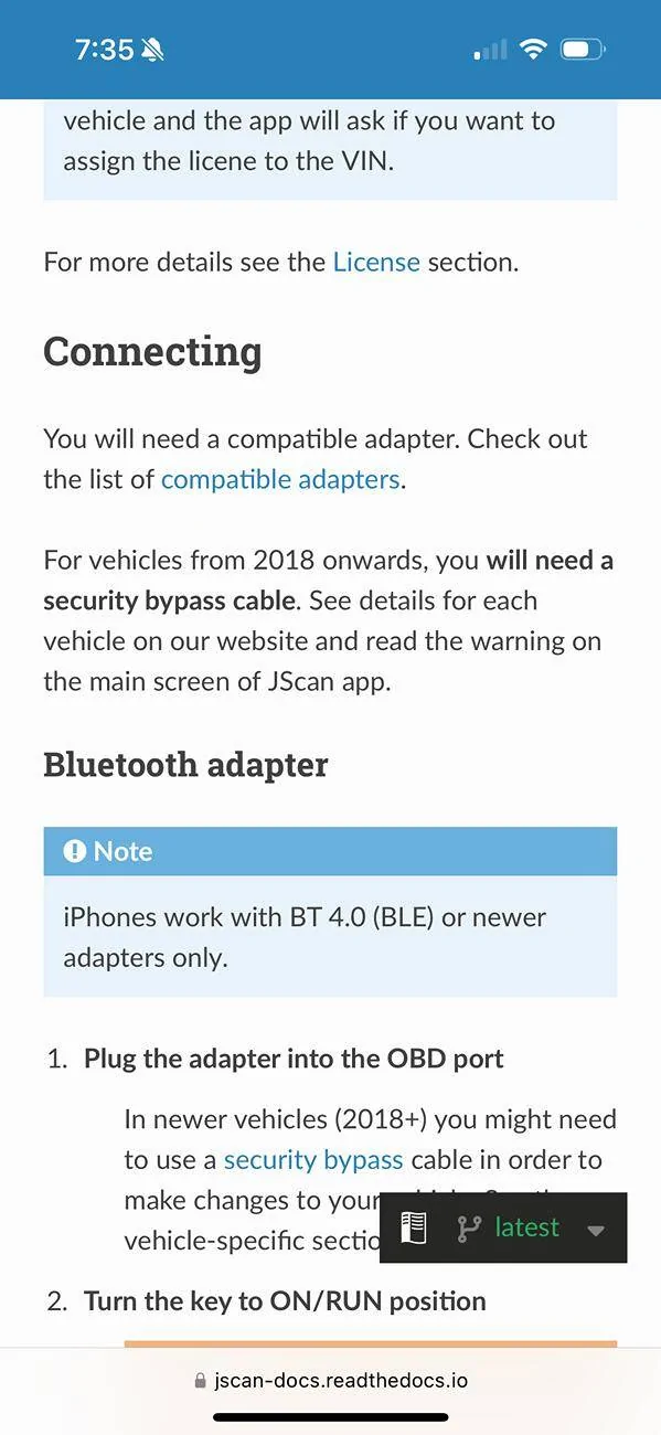

I have used JSCAN to change some settings for my Wrangler. But the settings have not changed anything. Not sure what I am doing wrong.
I have connected the OBDLink MX+ correctly (it is powered up) and it connects to my phone via bluetooth just fine. I have the ignition in the “run” position (motor not running). I have a paid license.
I make the changes I want and press “go” after each change and the program accepts the change.
I switch the ignition to “off”, and leave the OBDLink MX+ connected. I open and close the driver’s door and wait 5 minutes. Then I disconnect from the OBDLink MX+ and reconnect the wires to OEM configuration.
What am I missing here? Do I need to use the “reset ECM” button at some point?

Sounds like you're not bypassing the security gateway.
This can be done with cables linked above, or a tazer with sgw lock set to no.
Then any jscan updates will write

I am using a security bypass cable. See link above.
