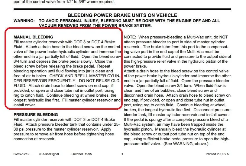

I googled "Bendix brake manual" and found this:
Jeep Wrangler JL ABS Bleeding with JScan bendix bvrake bleeding
I'll concede that the manual does not say "hard and fast." I'd also like to point out that even when pressing the pedal slowly, the master cylinder cups would go past any ridge of crud that might have been formed during use. I think "short stroking" the brake pedal when bleeding brakes is a procedure left over from when the material that master cylinders were made of was less resistant to corrosion.
The main point of my previous post was to say that you should not pump the brakes before bleeding. Pumping can cause air bubbles in the fluid.
When I bleed my brakes, I run the tube from the bleeder up and over another part of the vehicle and then down to my catch container. This loop keeps air away from the bleeder. This is a different way of complying with the Bendix instructions that say keep the far end of the bleeder hose immersed in fluid
