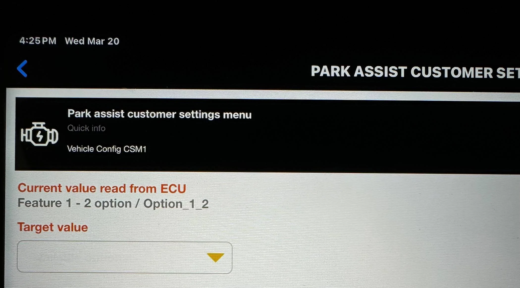

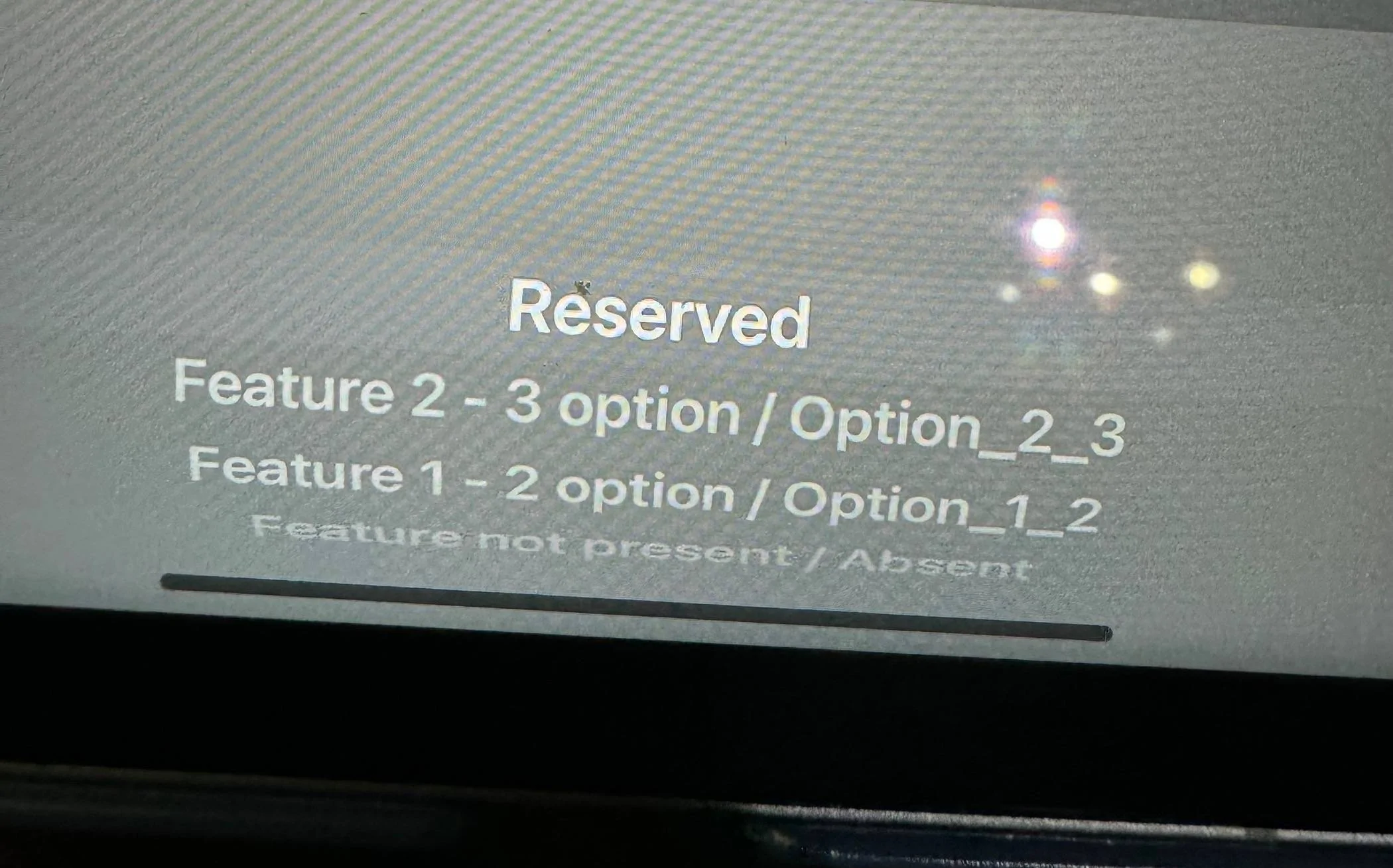

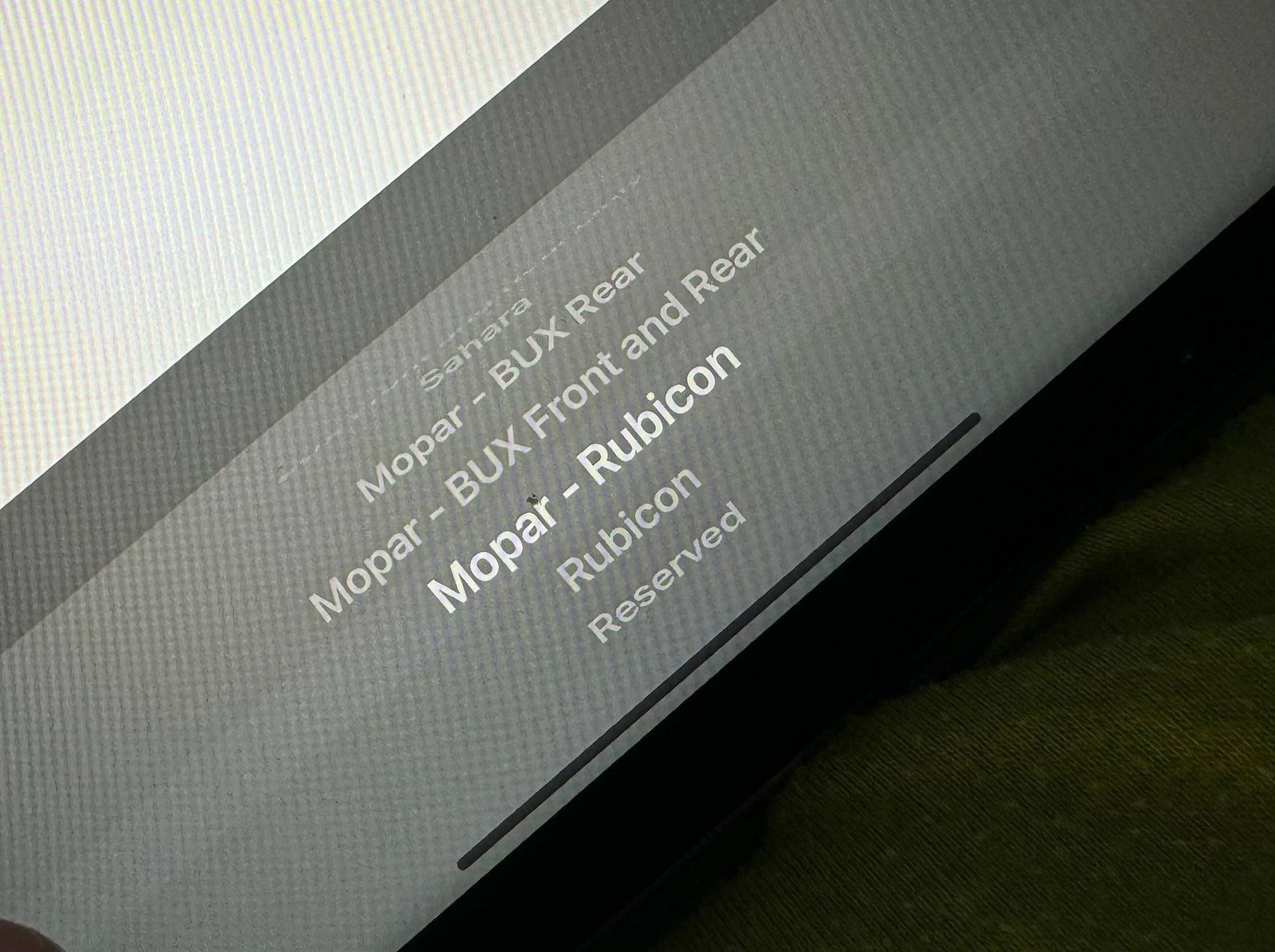

Question, does anyone know the difference for the Park Assist Menu? Just want to make sure I have the correct one set. Also, which for the "Tuning Set"? There is Rubicon or Mopar - Rubicon.
Thanks!
Jeep Wrangler JL Enable Park Sense with Jscan... IMG_1307
Jeep Wrangler JL Enable Park Sense with Jscan... IMG_1308
Tuning Set:
Jeep Wrangler JL Enable Park Sense with Jscan... IMG_1310
