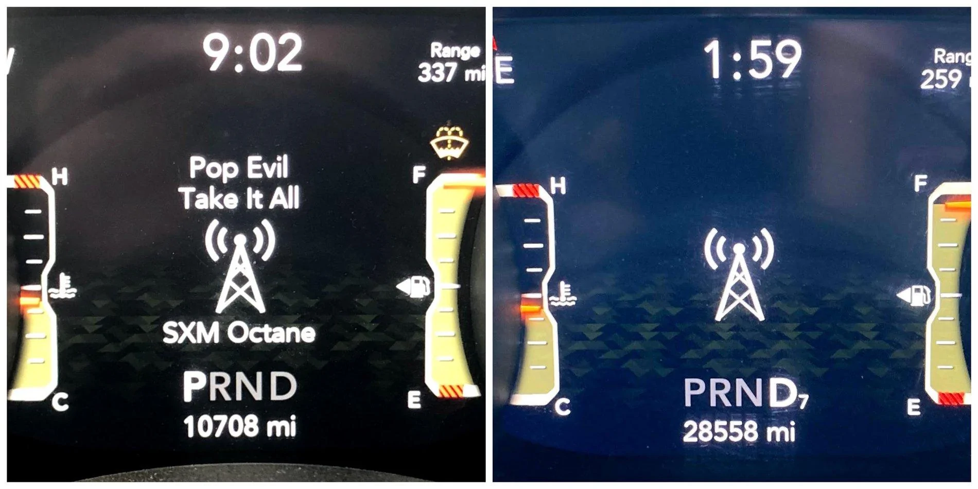

When I try to exit it seems as though it does nothing and the audio menu screen usually remains blank or lines of info are missing. It drives me nuts. Notice on the left it shows:
Artist - Pop Evil
Song - Take it All
Station - SXM Octane
On the right it shows nothing after using and attempting to exit the Tazer menu.
