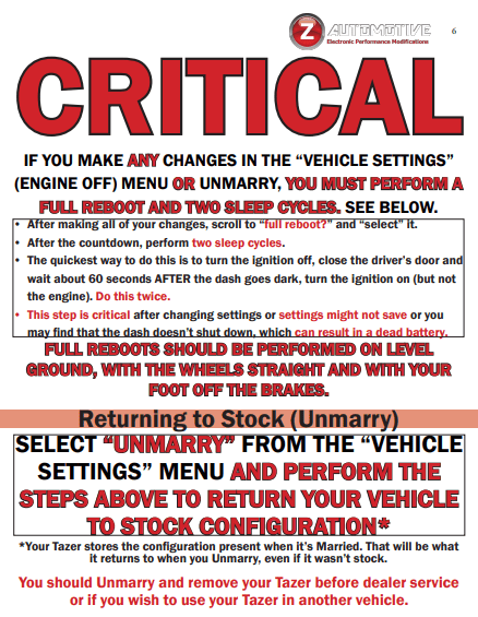

I've searched here and YouTube on how to properly remove Tazer Mini but can't seem to find a simple step by step process for removing the Mini before taking it into Jeep dealer for the locker sensor issue I am having...
After I select "unmarry" do I continue to hold left arrow button? It didn't seem to auto reboot when I selected unmarry
want to make sure I do it properly before taking it in...any help would be much appreciated:fist bump:

Unmarry will bring everything back to the factory Settings, right? I just got one too, haven’t used it yet - want to get my emissions done first in case the tazer affects it. Once you make changes, you can just unplug it without unmarrying?

In the instructions, it looks like you need to actually go to reboot and do two sleep cycles:
Jeep Wrangler JL How to properly unmarry/remove Tazer Mini? 1662576265405
